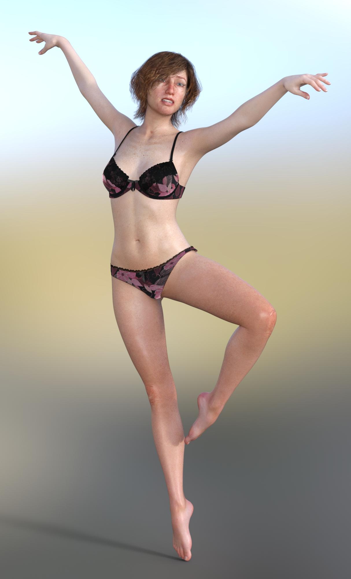

    @RianB, I used to live near the Dutch border. I can only understand some spoken Dutch, unfortunately. Speaking, reading, writing I can't. crying
    But I'm glad you figured out how to work the plugin!
    Total LOVE for this product! Works like a charm. smiley
    This is G3F sporting the G2 Adele skin texture, using just the base Iray conversion.
    @Cayman, thanks for a great product, and one question: the G2F set currently is supporting G2F base UV, and not stuff like Monique 6 UV, and the other gazillion UV formats of the Series 6? Is that correct?

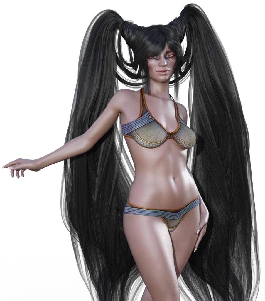

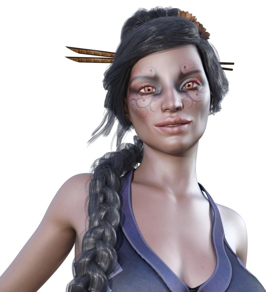

    This is an amazing tool. I have a lot of V4 characters and now I can use them on Genesis 3 Female characters.
    Below is the skin of MDD_Gillian for V4 from Renderosity applied to the shape of
    http://www.daz3d.com/vincenzina-for-genesis-3-female
    Then I have applied http://www.daz3d.com/jm-humanshader-for-iray
    to the skin. Daz Studio iray renders.
