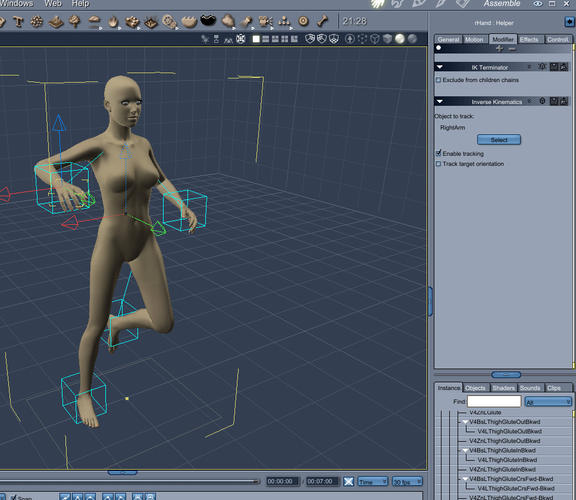

    Create a target helper object (give it a name, EG: left foot helper) and then position it roughly at the Ankle joint in a figure's foot.
    Select the figure's foot, and go to the Modifiers tab , choose Inverse Kinematics,. and select that target helper object which you just made, as the object to track.
    Now, grab the target helper object, and move it.
    that's a very simple example,.

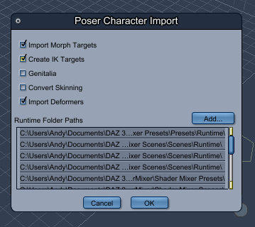

    Another way to see this target helper arrangement in action is to "Import" a figure like V4 or M4, instead of loading it from the content browser . This gives you an option panel, where you can choose to have carrara create a set of IK target helper objects for the hands and the feet.
    The only thing you need to do to make it work, is to enable the tr5acking for the body parts, IE: Hands and feet (See pic)
