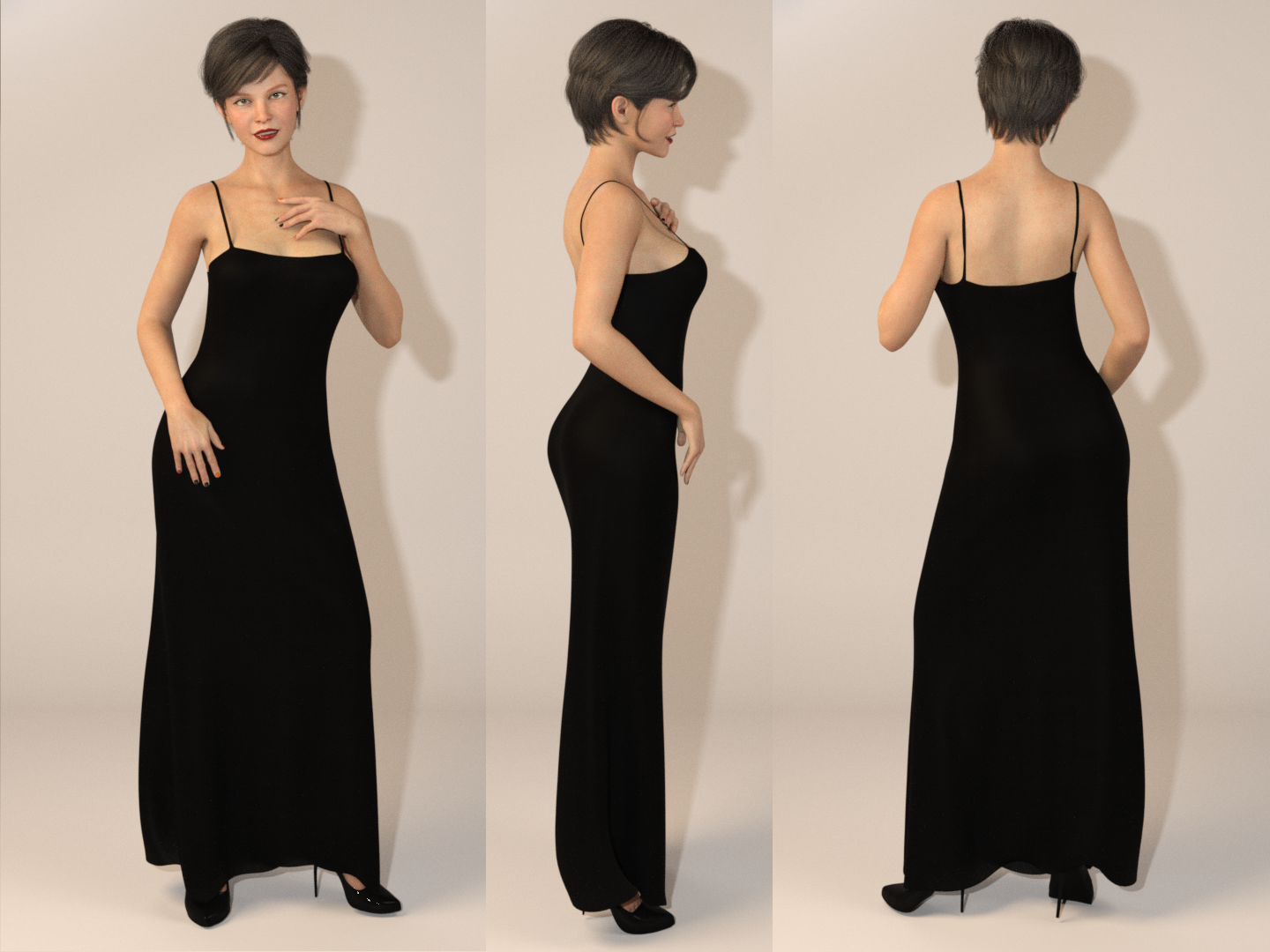

    Would this be of interrest?

  • felisfelis Posts: 6,502
    It is a dress I have made.
    I can pack it as a zip.
    edited June 2025
    Dress attached.
    Let me know if issues.
    See further down, for an updated version.
    zip
    zip
    G8F_Dress_27.zip
    4M
    Post edited by felis on

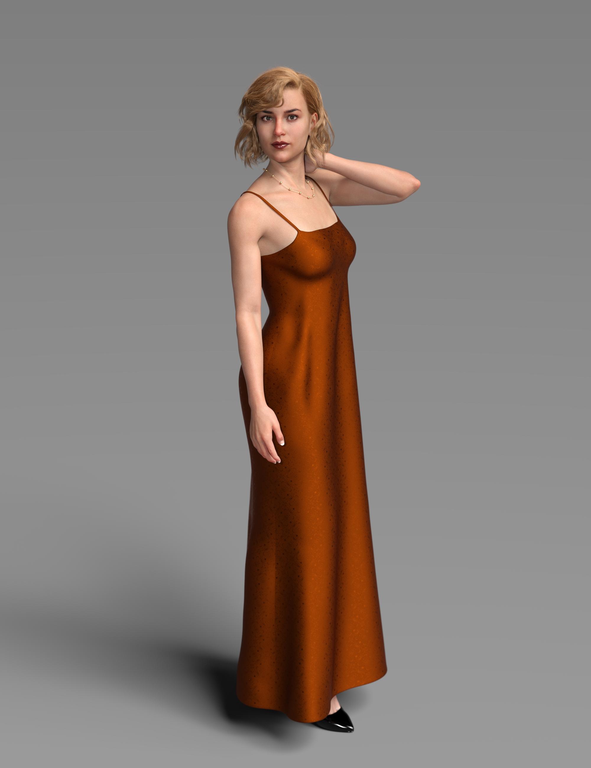

  • barbultbarbult Posts: 27,497
    edited June 2025
    Nice dress! Thank you. I applied a shader. Since you mentioned the weightmapping error on the feet, I removed all the weight from foot, metatarsal and toes. That made the simulation even better.

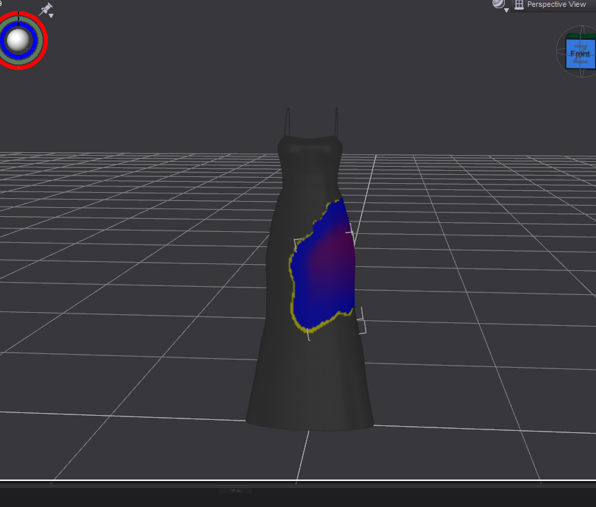

    edited June 2025
    There is something weird going on.
    This is what the weights look like for left-thigh-bend
    But then I autofitted to G9, and then there was no weights on thigh-bend, but all on thigh-twist.
    Why that is so no idea.
    I loaded a G9 dress, that neither have weights on thigh bend, all weights are on the 2 twist bones, so it must be so they have designed G9, though I don't really understand why.
    869 x 739 - 81K
