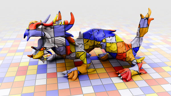

    If you get stuck and your scene will post
    I do enjoying tinkering with lighting and render settings.

  • LordHardDrivenLordHardDriven Posts: 937
    Show off! :)
  • GussNemoGussNemo Posts: 1,855
    That dragon gets more interesting as time goes by.
  • David BrinnenDavid Brinnen Posts: 3,136
    Sort of a mix and match, Mondrian meets ancient Chinese culture. These two renders were made by rendering the colour patterned components separate from a grey scale to achieve higher contrast. The two parts I put back together in PSP8. In Bryce the global ambient effect seems to suffer from less absorption than what I've seen in Carrara. I don't know which renderer is factually correct about the level of surface absorption but, it would be nice to be able to control this separately. The more I test, the more controls I could dream up for TA.
    Well to quote Aerosmith, "Dream on, dream on, dream on, dream until your dreams come true." :)
