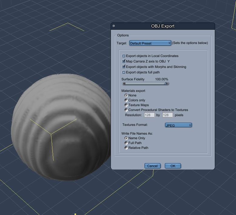

    in Carrara you take the object with the displacement map applied and export with 'morphs and skinning'  - please see below window
    I hoped studio has a similar feature

    Headwax said:
    What I would like to do is export the obj from studio with the displacement embedded into the mesh.
    the short answer is, D|S cannot do this. some other apps can do it, e.g. blender or zbrush or maya or rhino, but this is not treated as an import/export feature. I don't know anything about cararra but that kind of import/export dialogue has never referred to what you want to do with converting a displacement map to hard geometry that I have ever seen, skinning refers to weight mapping and rigging.

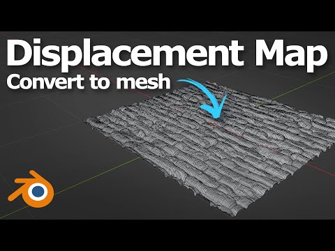

    might be helpful
    I can do it in Zbrush but that's no help to you

    WendyLuvsCatz said:
    might be helpful
    thanks Wendy
