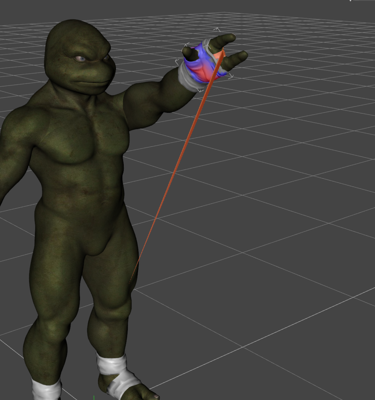

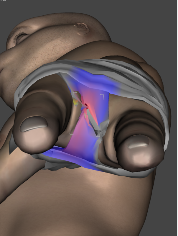

Weird jagged glitch on glove hand
So im trying to make a Ninja Turtle and apply clothes on him but I am having some issues with the gloves. For the two middle fingers I shrinked them down in Blender so the turtles only have 3 fingers like shown here but im thinking it is now messing with middle part of the gloves. Any help on this would be great.

  • SquishySquishy Posts: 725
    this looks like what happens when part of the geometry (even a single vertex) is not weighted correctly. You can probably fix this pretty easily in D|S Node Weight Map Brush tool options with Normalize Weight - this goes over the model's geometry and makes sure all vertices have 100% total weight.
    re: shrinking the fingers, if you scaled the bones, that might cause a problem (don't scale bones outside of D|S) but if you just scaled the points down that should never be an issue.
  • Lyko3DLyko3D Posts: 7
    Okay, so scale the fingers while inside Daz3D and that should fix the gloves issue? Im about to test it out and hopefully it works
    I mean, scaling bones is probably not the best way to handle your problem in any case, but if you're going to do it, do it strictly inside of DAZ Studio, don't export or import scaled bones unless you have a super good reason for it. If I was doing this I would just get rid of the middle and ring finger bones completely and weight the mesh of the two fingers to the index and pinky bones.

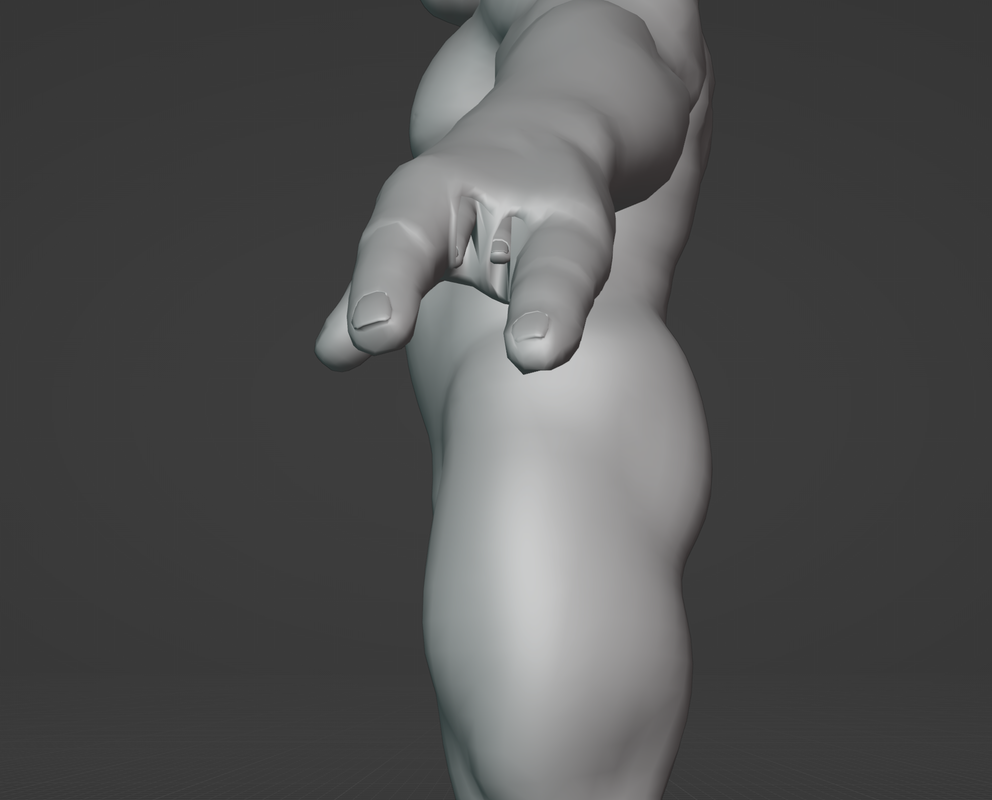

    So here is a preview of the hands straight out of Wrap4D after using a Ninja Turtle base from COD. The fingers are inside the hands so what I did before was pull them and shrink them individually and place them as a nub where they use to be
    I used this same method on the ears and the mask had some weird issues also. So im hoping figuring out the hands can me figure out other aspects for the turtles.
    edited May 2025
    honestly if I were you, if you're even kinda competent with Blender I would delete the finger geometry entirely and just close the polygon hole(s) with bridge or weld the open points together. If this model is already rigged and weighted, this shouldn't really break anything although the couple of new polys will need to be placed on the UV map (in Cinema it would be the UV Terrace tool, I don't know what the blender equivalent is).

    So I tried the delete method and got an error on Daz3D for what I am guessing is not having the same amount of polys for the G8M figure. So im wondering if I just have to find a way to have the gloves not acknowledge the middle fingers at all. I tried highlighting the middle part and setting fill selected to 100 while on the hand bone for the gloves but that doesn't work.
