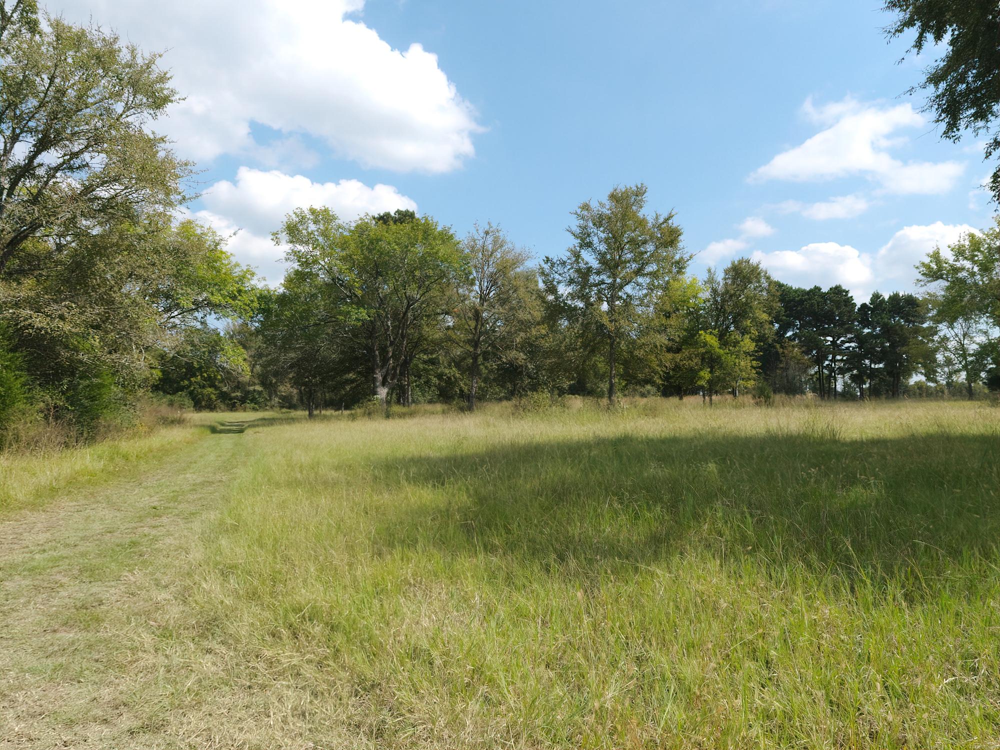

    Here is a test I did right now in DS 4.24.0.3. The problem ocurrs even when the backdrop image is the same size as the rendered image using it.
    This is the image I put into the backdrop. Click to see full size 2000 by 1500.
    This is the result of rendering an empty scene with that image as the backdrop. Click to see full size 2000 by 1500.
    2000 x 1500 - 2M
    2000 x 1500 - 2M

    Barbult it looks like it takes a line from the buttom of the picture like it is just repeating it instead of filling it out with the image :/
    made the bg red so it is easier to see, I still don't know how to fix this tho, I mean it shouldn't do it if we are using images bigger or at least the same size as far as I know..
    1062 x 900 - 1M

    I saved my test file in 4.24.0.3 and rendered it in the oll 4.22.0.16 general release. 4.22.0.16 does NOT show the same problem.
    I also noticed the the 4.24.0.3 creates a lot of halos around the trees in the backdrop image when it renders the scene. This also does NOT happen in DS 4.22.0.16.
    Unless I've made some mistake in my testing, it appears that Daz Studio handling of backdrop images regressed in quality a lot, somewhere between 4.22 and 4.23. This loss in quality persistes into DS 2025 Alpha.
    Who else still has 4.22 installed to test my testing?
    2000 x 1500 - 2M
