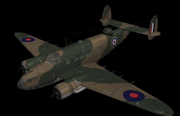

    here is model I did 8 years ago for a Silent Hunter 3 mod, all those side windows on the nose and fuslage are booleaned. It was a bit of a frankenstien model with about 10% of it being reworked from an older mesh imported in obj (triangulated areas).
    Triangles are not much of problem on lowish poly game models though. I wouldnt dare to have tris on peice of clothing for Genesis.

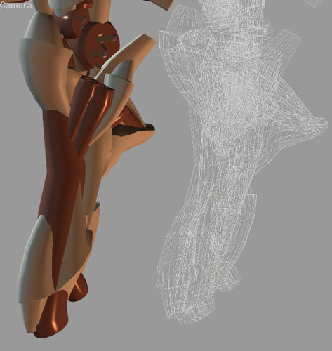

  • NightmareHeroNightmareHero Posts: 18
    edited September 2012
    reading the advice from the experienced vendors here are giving to you, it sounds to me like they are saying you shouldn't use the Boolean method to create content for selling. just my 2 cents worth.
    I'm not opposed to doing it without boolean, but reinventing my modeling strategy which relies on symbolic elements would be detrimental to me at this point. If there's some way to remove internal geometry without boolean when you have meshes grouped/welded together to create one mesh group, I'm all for using it. I'm just hoping it's in my price range and they'res a tutorial behind it.
    600 x 634 - 75K
    Post edited by NightmareHero on
    And there's the bottom line.
  • DogzDogz Posts: 912
    They say picture says a thousand words, and the above is good example, now I fully understand your problem.
    And - No Im quite sure You cannot boolean your way out of that one. Even if you could, it would be a very messy mesh by the end of it.
    If you have low poly version (without mesh smooth) you can manually edit that - otherwise a rebuild would be in order.
    I know its not what you want to do, but I cant see any other option Im afraid.
    Gedd said:
    A side note, I'm not sure where you are getting the parts from that you are welding together but hopefully you realize that you can't take them from other meshes and redistribute the composite if any part comes from a model that has a limit on the license that would contradict said form of distribution.
    Also, part of the problem with welding parts, whether from different models or from your own is that to get good uv maps, one needs to have good flow to the topology and have somewhat consistent polygon size. Also, things like n-gons, mixes of tris and polys, excessive use of polys in areas where not needed, flow of poly direction where there will be bends, and verts with excessive polys coming together all effect the quality of the final product and therefore it's end value. That was why I put up the Blender link btw, it goes into all of that.
    I only use my parts, all the parts I use on my spaceships and robots are my original design.
  • Joe.CotterJoe.Cotter Posts: 3,362
    Well then as long as you don't rely on booleans, you shouldn't be far off base. Sounds more like you just need to expand a bit :)
    I recommend you check out those links I posted earlier, it's using Blender but he breaks it down very simply and you can use the concepts in Hex if you prefer.
