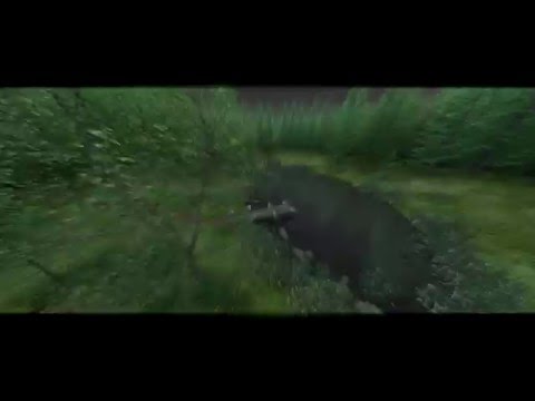

    a couple of attempts by me resizing to full HD and letterboxing one just virtualdub compressed as mp4  second uncompressed avi compiled in wondows live moviemaker
    thanks!!
    the top one is less blurring.
    these both done in moviemaker?
    the slomo one looks sharper,
    and some tripping tree limbs smiley

    slomo one has 7K+ frames it creates tweened warp images to bridge existing frames based on nearest pixels, gets very weird distortions on wildly different images so your clipping branches do odd moves.
    I usually use 24 FPS but used 25 like you did for these, the slomo and mp4 videos were all compressed in virtualdub, slomo just used to add tweened images.

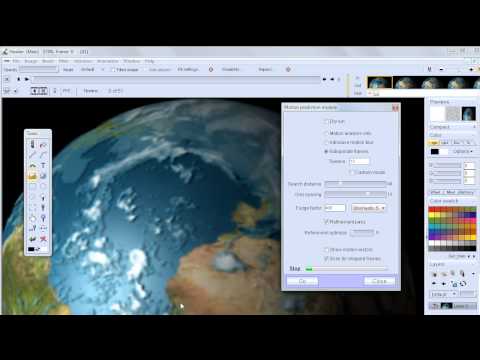

    Howler's Motion Prediction module does a decent job ;)
    (First he shows how NOT to do it for something like this)
    the NOT what to do?  smiley
