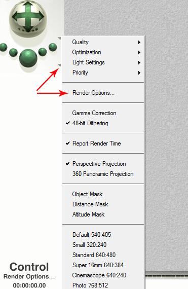

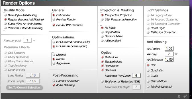

    Bryce has two built-in different renderers? How do you find them / choose which to use?
    find it here
    Options here
    Superfine Antialiasing is not a recommended option,    Premium (Effect AntiAliasing) unlocks all the options shown, and is infinitely customisable.   Default render when Bryce boots up is Regular.(normal AntiAliasing
  • HoroHoro Posts: 11,576
    MelanieL - In the Render Options. Regular is one and good for "everyday" renders, Premium is the other that has several additional options, like True Ambience (TA), which is Bryce's implementation of GI (global illumination), it can also render pencil sketches, for exmple.

    Thank you both - I had actually been using this feature but I didn't realise that "Regular" and "Premium" were different engines, I just guessed they were some sort of speed thing.
    Is "Default" different again, or just "Regular" without the anti-aliasing pass? And is "Super" just a souped-up "Regular"?
    Yes, Default, Regular and Super use the same engine, Premium the other. Never use Super, because it is terribly slow and you are better off Premium with a Rys per pixel (rpp) at 16. You may also have discovered that the estimated render time for Regular excludes the anti-aliasing pass, which can take as much as 10 times as long as the 4 render passes. Premium has anti-aliasing inclduded and the estimated render time after the fist pass is in most cases quite accurate.

    The Super one is by far the slowest render setting Bryce can do and I think may be mostly responsible for people who report days of render time for what look like quite simple scenes... I think the "Fine Art" part is leading people to think it's the one they need to use but in all my tests, I've never found a way to optimise a scene to get short render times out of it.
    I find Premium to be the fastest in the vast majority of cases for the renders I do (remember that there is no EXTRA AA pass so the time Bryce estimates is more accurate. On Regular the AA pass is additional to the Bryce estimated render time and depending on what materials you have, the AA pass can add about a third again on to the total render time), even adding soft shadows in premium doesn't cost much in render time and it's versatility is extra useful.

    Thank you, Horo and Dave, for that information. I'd noticed that "Super" seemed to take ages yet didn't really look that much better than "Regular" - yes I guess I was misled by the "Fine Art" claim. And that the estimated times seemed to be almost random compared to the actual render times I experienced using "Regular". But I haven't had time to work all this out as I'm still trying to get to grips with Bryce basics really. I've followed some fairly advanced tutorials (thank you Horo and David B) early on because they really got me interested in the kind of amazing things Bryce can do. I'm a DAZ Studio person really, but sometimes get frustrated at wanting to make sweeping landscapes that weren't just out of a box, so that's why I'm trying to get into Bryce. I wish it was 64-bit (although to be fair I've only crashed a couple of times by over-populating scenes) and I keep hitting the wrong buttons because the interface is so different from DS, but seeing some of the results in the various Bryce Forum threads is a real spur to keep on trying.
