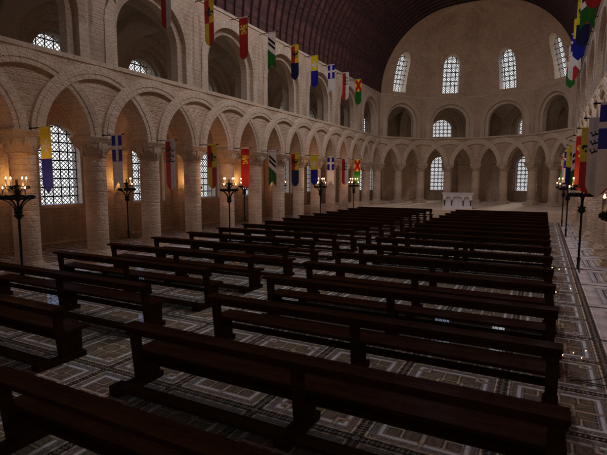

  • felisfelis Posts: 6,625
    edited August 2025
    I am not sure which effect you are trying yo obtain.
    The stones has a slight yellowish/greyish color, so they can never get whiter than that, unless you alter the surfaces of them.
    Alternatively you can alter tonemapping, e.g. exposure, whitepoint or highlights.
    This is with neutral tonemapping and default surfaces, and only adding more white light.
    1200 x 900 - 2M
    Post edited by felis on

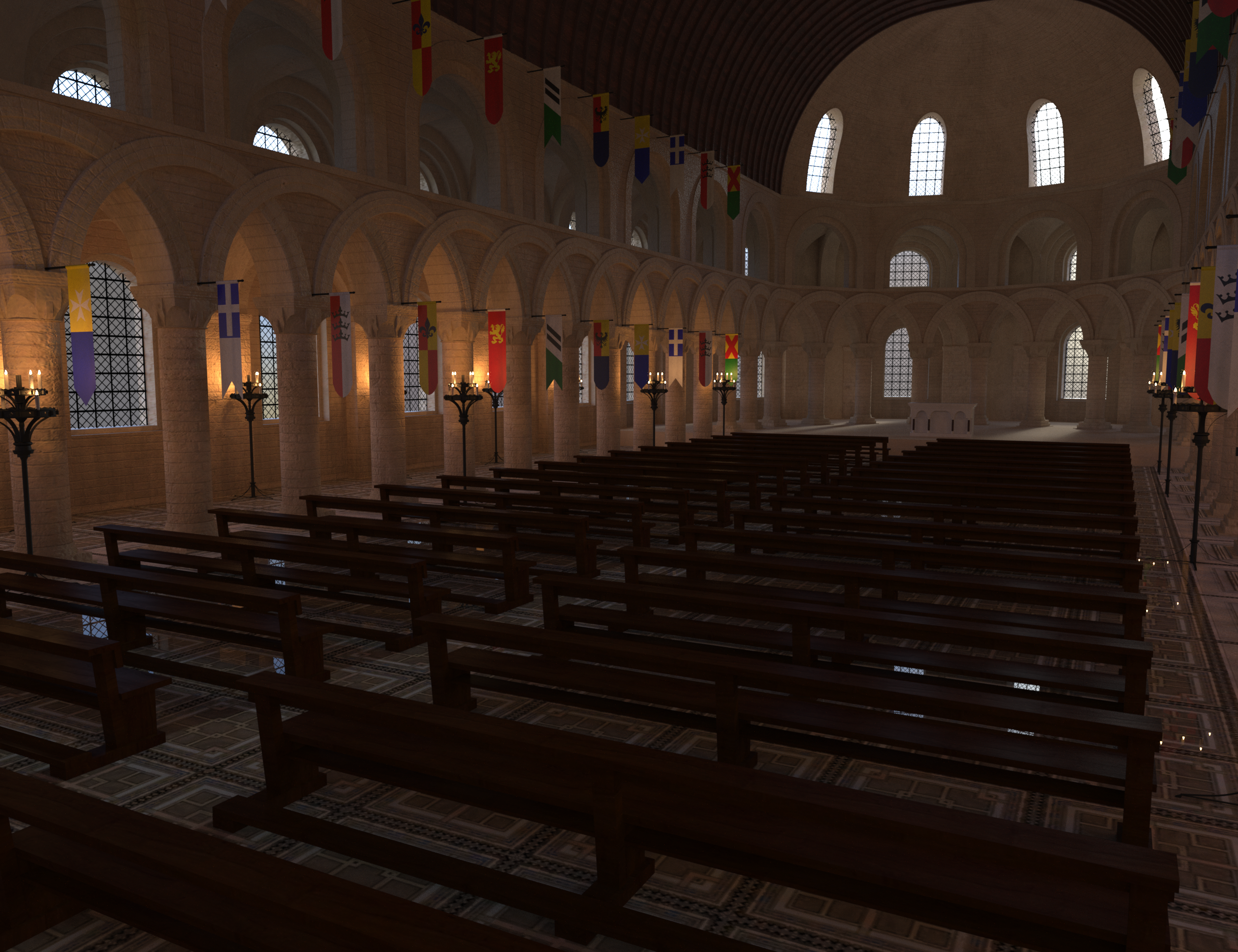

    edited August 2025
    And this is the same image with exposure value 1 lower (which you often will do if taking pictures indoor).
    1200 x 900 - 2M
  • @ felis
    Thanks for coming around here.
    I had added extra light, but did not get the desired results, as you can see in the picture.
    Now you said "Alternatively you can alter tonemapping, e.g. exposure, whitepoint or highlights.
    This is with neutral tonemapping and default surfaces, and only adding more white light."
    I have to play with with the tonemapping seetings, isn't? what are the reccomended values to get this sorted out?
    In Tone Mapping you have F-stop, ISO and shutter speed, they all end up in Exposure Value (in real photography they will have different effects, but in Iray they are handled eqaul).
    If you lower the exposure value you make the image brighter (higher darker). Technically you can also do this in postproduction.
    Wiki https://en.wikipedia.org/wiki/Exposure_value
    White point defines what is considered white. If you e.g. change the white point to a slight yellowish, the walls will look whiter, but there will be a hue offset of everything, so I would say only small changes should be done.

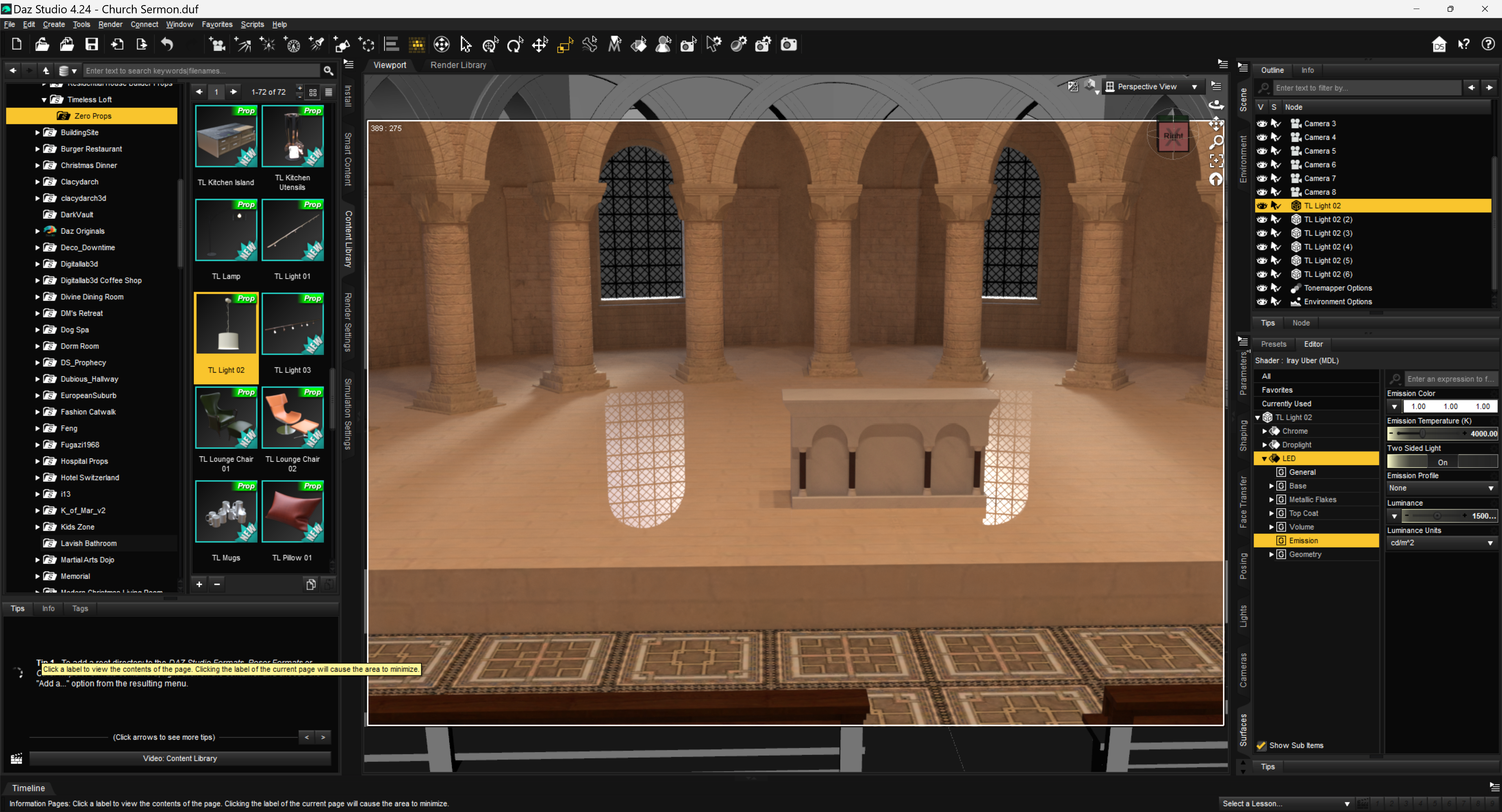

  • crosswindcrosswind Posts: 10,351
    edited August 2025
    I don't have the product... but if you want to have an ambient Daylight as you said above, my friend, i.e. make emission more or less like LED, you can try tweaking Emission Color and Temperature, as below screenshot. See if there's any change.
    Edit: I took another chapel I have as an example ~
    2462 x 1223 - 2M
    2020 x 1291 - 3M
    2015 x 1292 - 3M
    Post edited by crosswind on
