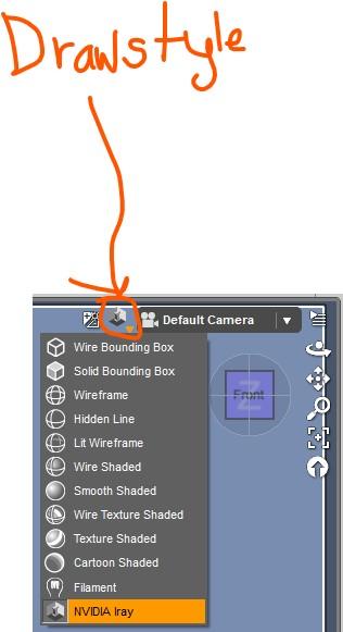

    When loaded, you are looking at a Viewport preview. Depending on the Drawstyle you have chosen for the viewport (or what Daz Studio defaulted to), the viewport will look different than a final Iray render. The promo image for the product is a final Iray render. So, your viewport preview and the promo image render look different. The only way your viewport will look like a final Iray render, is if you select the Iray Preview Drawstyle for your viewport.

  • thank you so much, barbult! i will try that!

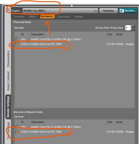

    Know that Iray Preview can be very slow on a large scene, unless you have a top of the line NVIDA graphics card. Also make sure that your graphics card is selected as the rendering device in the Hardware tab of the Render Settings pane. Also, as Richard noted, select the NVIDA Iray (MDL) as your render engine. See the attached screenshot.
    However, if your goal is to export to Unity to render or work on your project further, you don't really care what it looks like in Daz Studio.

  • thank you, barbult. this will help me in stting up my whole Daz interface again. you're right, i'm not concerned too much about how it looks in Daz, but I do want to make sure I'm getting the products as advertised. I very much appreciate your help with all this. I don't have a top of the line Nvidia card. I have a Nvidia GeForce RTX 4060 Ti. i hope that will do.
  • barbultbarbult Posts: 27,653
    It all depend on the scene. Give it a try. If Iray Preview is too slow, do a full Iray render instead. Or do a spot render of a small area of the scene with the spot render tool.
