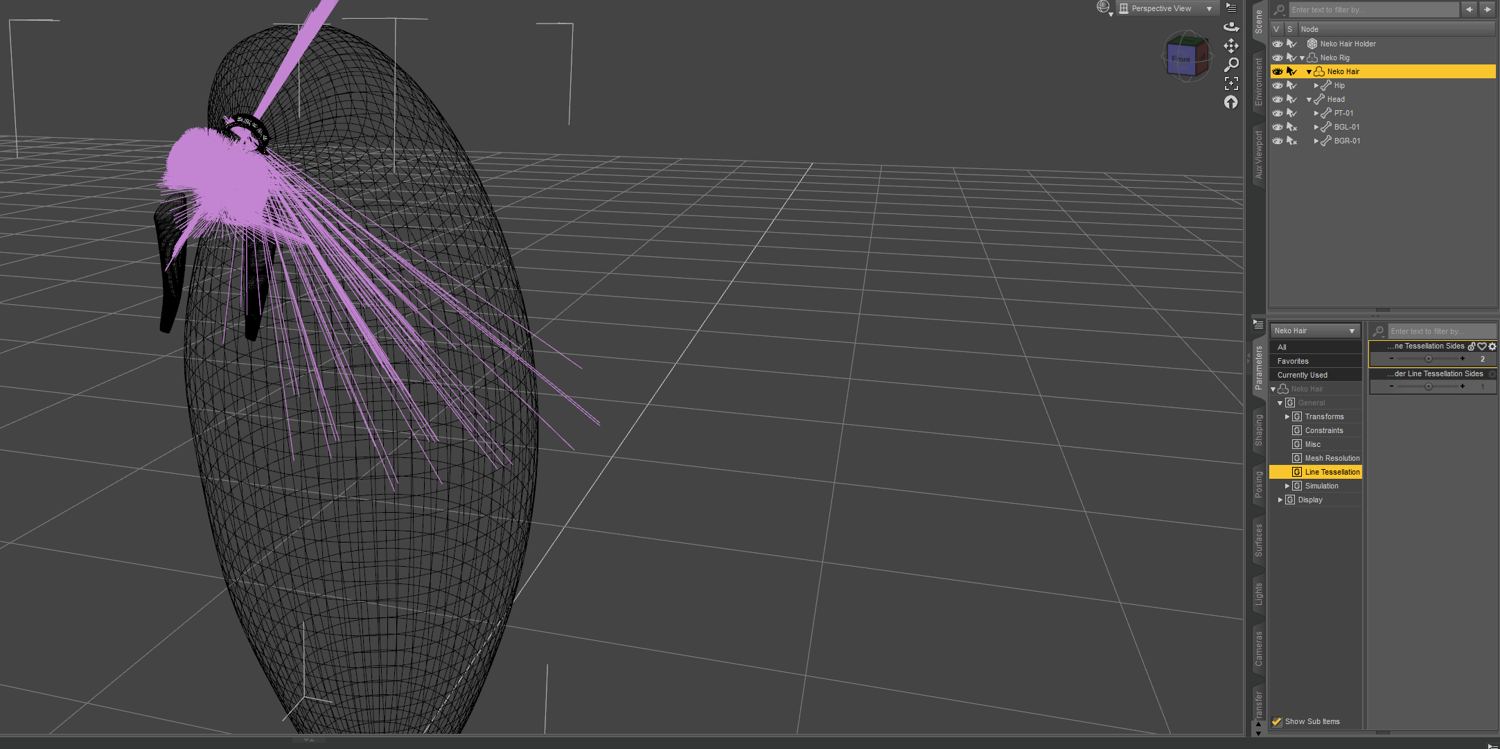

 and I had a very bad surprise: the hair disappeared.
After a bit of searching, it turns out that the Line Tessellation Sidesis totally buggy when the value exceeds 1!
You can see it in the attached images:
Line Tessellation Sides 1 :
Line Tessellation Sides 2:
I use dforce hair, it's the first time I've seen something like this.
Does anyone have a solution?
2211 x 1072 - 499K
2165 x 1081 - 558K
Post edited by nelchwetzal on

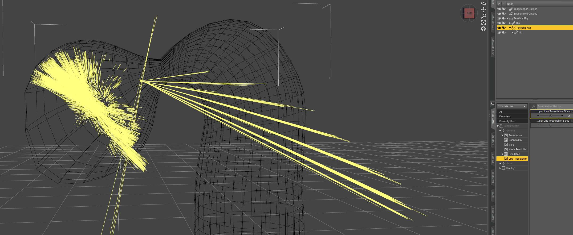

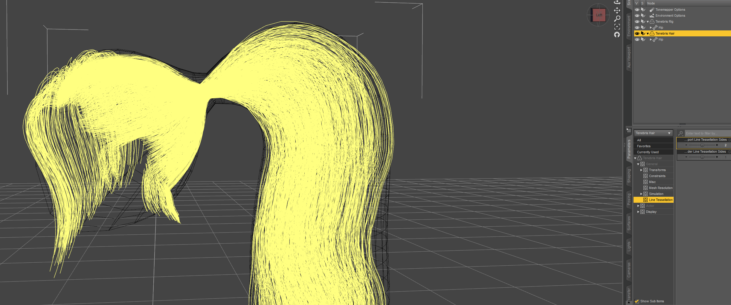

     No: I've found it's not a VRAM problem but a hair problem, and Shadow Cat Hair shows it :
    https://www.daz3d.com/dforce-shadow-cat-hair-for-genesis-81-female
    The product is supplied in two variants:
    1 Shadow Cat Hair: the classic Dforce system
    2 Shadow Cat Hair With RIg: dforce with a rig like neko hair and tenebris hair
    Version 1 can easily reach Tessellation 4: you can see this in the picture.
    As for version 2, well, the picture speaks for itself.
    I've checked the Vram and ram, and there's still 7G and 22G, so it's not Vram, and besides, the lines are there, it's just that they're put in the wrong way.
    Tenebris hair and neko hair, which use the same RIG technique, are also affected.
    So it's definitely a bug.
    2420 x 984 - 337K
    2350 x 970 - 377K

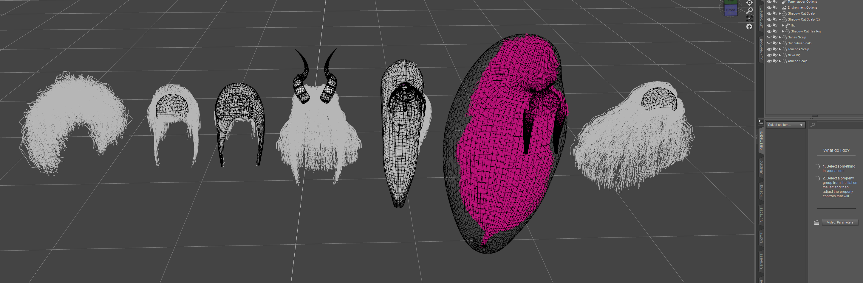

    Further demonstration: I put in several dforce hairs and then set the tesslation to 2 on all of them.
    Line 0
    Line 2
    This affects daz studio 4.22 and 4.23
    Edit :
    Additional proof: when you took the hair out of the rig, the problem disappeared.
    2894 x 951 - 614K
    2882 x 946 - 629K
    2433 x 1001 - 440K
    2445 x 1023 - 573K
