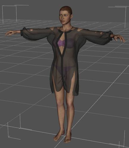

    Something is off. This is Evening Dress on my V4.2 in DS4.5P at default load. No Fit to used.
    EDIT: No, I'm in 64 bit as well.
