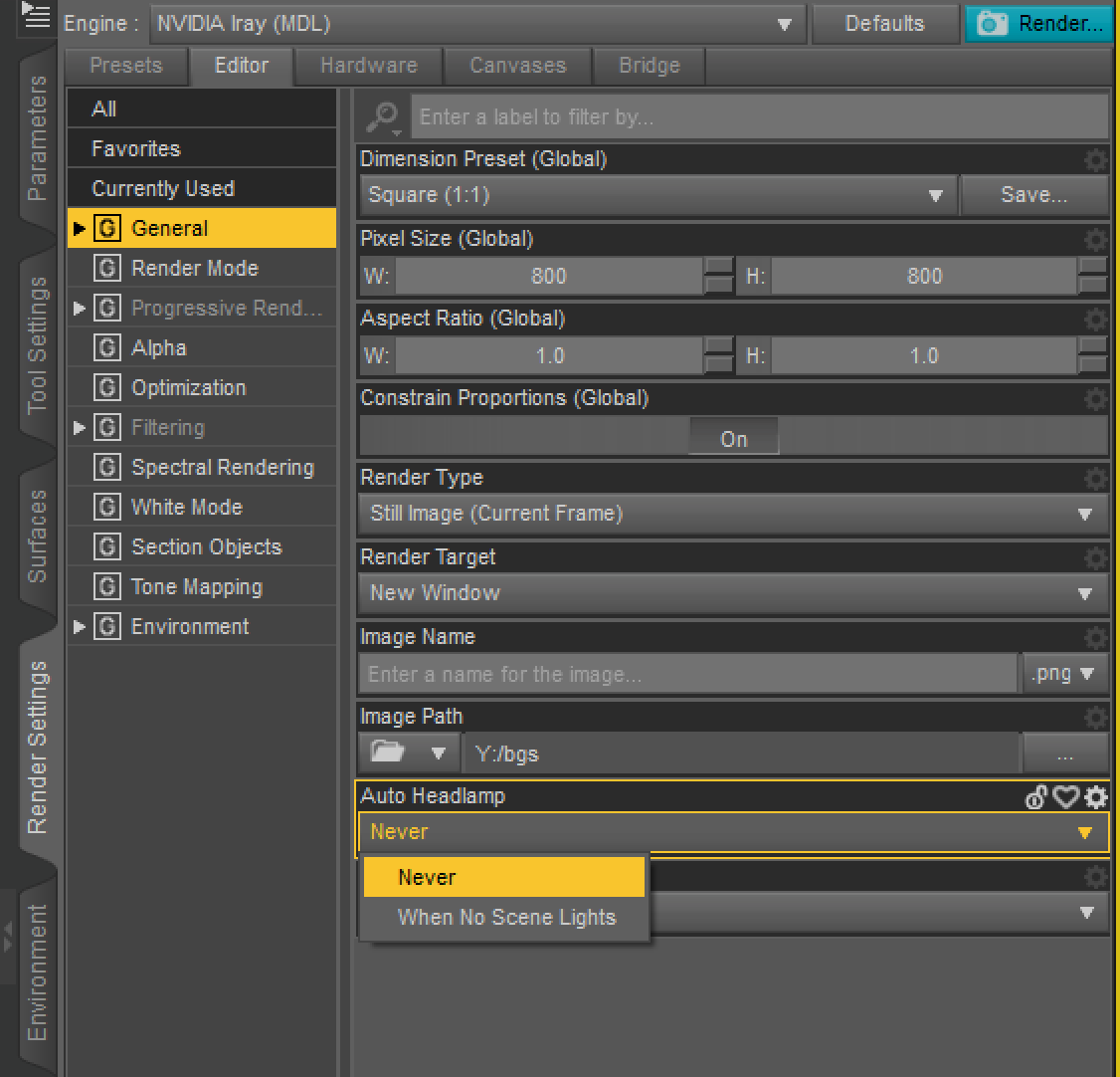

    Check the Auto Head Lamp?
    - Greg
