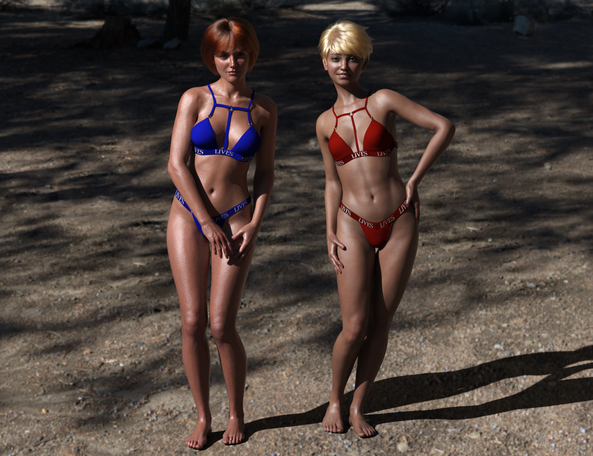

Would like to ask if it's possible to obtain an oily skin look for a characters skin?
I had a little play around, mainly with Top Coat Weight but not sure what else? See attachment.
I've also googled and youtubed and came across something called: Oily Skin Look Presets for Daz3d g8 characters on ArtStation. I wonder if it would be worth it?
Thanks in advance for peoples replies.

    Try lowering the Rougness on any Top Coat / Glossy channels.
    The lower the roughness the more shiny the material looks.
    The higher the roughness the more matte the material looks.

    Somehing that is less rough gets more shiny as the reflection goes in the same direction.
    You can also increase reflectivity for top coat.

    I changed all what you suggest in small increments to Jill (G8F) and Leon (G9). Leon is missing some of the Glossy settings. Made a quick render. See attachment.

    Most Genesis9 uses PBRSkin shader, but I don't really see any difference in dual lope settings, beside you need to enable dual lobe first.
    Also remember, for something to look glossy there need to be some light to reflect.
