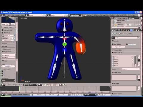

But how do I separate it from the hand movement? It seems to follow the hand everytime I move it.
That's where weight maps come in. You use them to assigns which part of the mesh is affected by which bone, and by how much.
Here's a quick overview:
