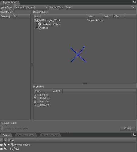

    A very helpful explanation probably for experience users of daz studio. I follow to " Right-click in the Geometry List area and select Add Geometry..., then select your dress OBJ and make sure you use the right preset (Poser if you modelled around the OBJ from the geometries folder" the geometry list area I guess is the one I show on the screenshot. when I rightclick that one I don't get any Add geometry. Ah got it, its the one on the far left. Stupid me
    658 x 728 - 42K
