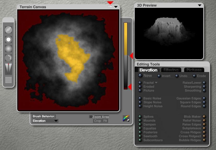

    Oh...may I ask how you made the flat top platteau? I have been playing with the buttons to change shape of my terrains and I get some really weird and not so nice looking results. I think I need to do some more reading and find the right videos is all. I am struggling a bit more with Bryce than I am Daz at the moment. I will not give up! :)

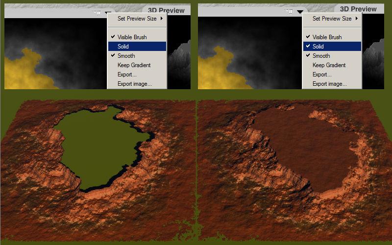

    Liana - if the bridge doesn't work (Bryce <--> Studio), export from Studio as OBJ and import in Bryce.
    Top Plateau: In the Terrain Editor (TE) click on top of the canvas  to open the sliders at right (1st picture). Grab the parenthesis with the mouse and move them up and down. Yellow gets flat on top, red cut-off from ground.
    To get a plateau. not a hole, set the terrain to Solid (2nd picture). The preview always shows the mesa, even if it is a hole.
    TE-Cut
    TE-Solid
    827 x 575 - 69K
    800 x 500 - 93K
