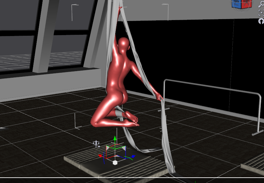

I am trying to do Dance Time Pose 08 - Aerial 01.  I have tred to parent it and do the pose.  I tried it separate, but to be clear, I do not mean how to use the sliders.  I can get the shape right.  But even if I put the character all zeroed out and in the center of the render, when I bring in the aerial 1 prop, it's way off to the right.  I cannot figure out how to work this.  Can one of you explain, step-by-step as if I was 5 years old how to do this?

    You don't have to parent anything.
    Load the character and load the pose.
    Then find the right arial and in Parameters > Actor > Adjustments dial the corresponding morph.
    The arials are in an odd order.
    This is what it look like for me with pose 8, ariel 1.
    843 x 584 - 400K
    Post edited by felis on
  • crosswindcrosswind Posts: 10,356
    The position of all aerials were specifically designed for the Dance Time Room rather than "go to anywhere", so they're not at World Center. You can check their Center/End points with Joint Editor Tool activated.
    If you want them to be at World Center, you can minus the X/Z Position values from X/Z Translate of the aerial props..(even export / import OBJ file) but in that way, it'll be not 100% in line with G8F figure's postion after loading the Pose Preset.
