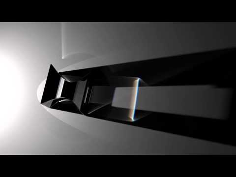

Here is a demonstration with caustics and glass.
