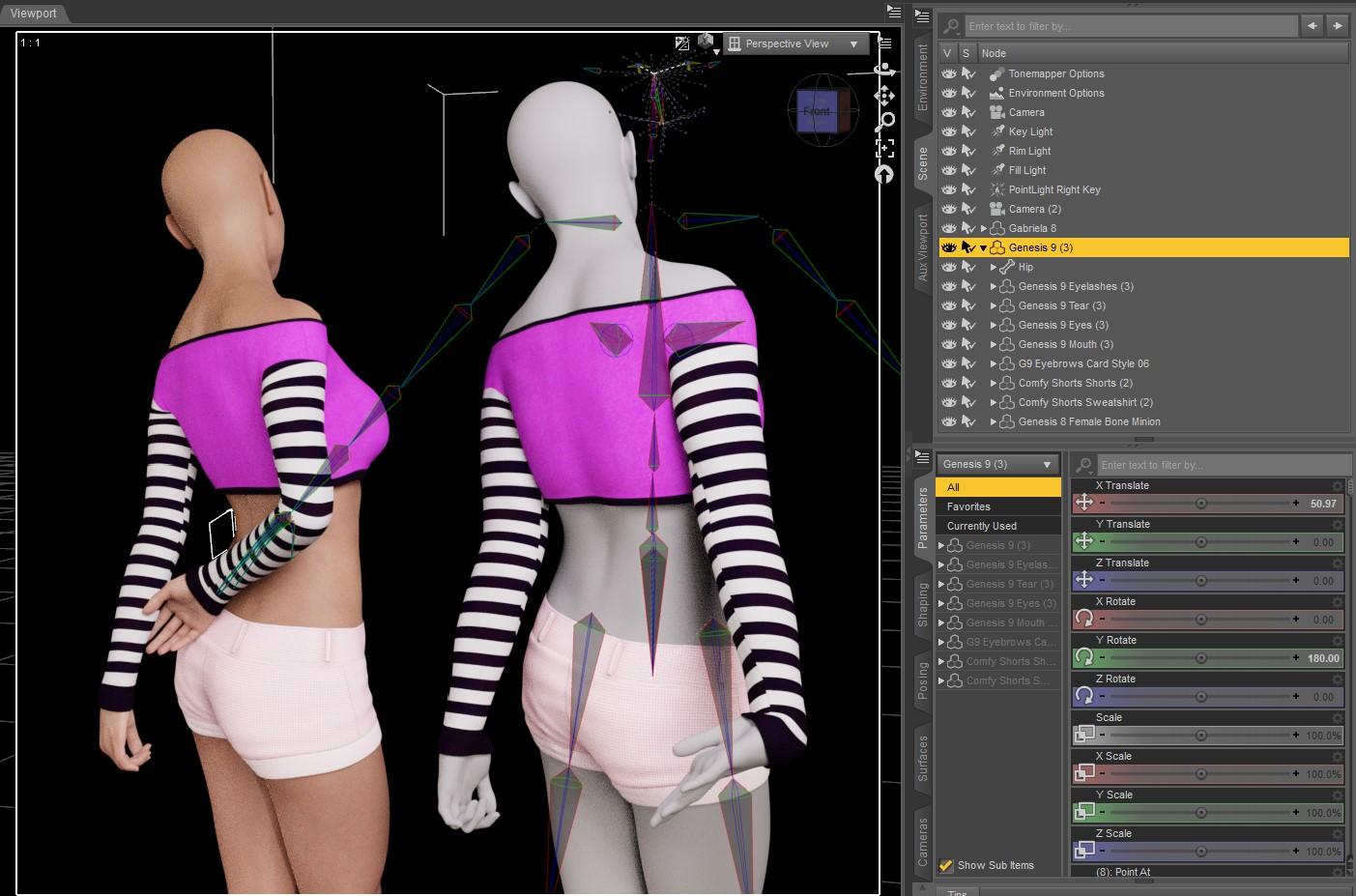

Hello. Yes, another pose thread, as I'm tinkering with this pose project today.
I ran into an unexpected weirdness when testing G8 poses on G9. Here, I've cut to the chase and compared a stock G9 figure (on right), with the G8 Female Minion, to a G8 figure (Gabriela in this example, on left).I tried all of the G8/G8.1 Male and Female minions and had the same problem.
I swear this is new - I haven't done that much creating lately with full poses and so haven't used the G8 for G9 minions in a while, but they weren't doing this before. Have I bought something that screwed up how minions work on G9?
This isn't the only deformation; it's also not bending legs correctly in some poses and there's more subtle problems, but this gives an idea of how broken something is. Help!
https://www.daz3d.com/bone-minion-for-genesis-8-and-81-poses-for-genesis-9
ETA: I had just tested a new G2 pose set, using the G2 -> G9 minion, and it worked fine. So it's not a problem with all minions, or all of G9.
1403 x 927 - 240K
Post edited by paulawp (marahzen) on

  • crosswindcrosswind Posts: 10,358
    edited January 2025
    I've not used Minions for a while... but yes, that should be an issue coming from the Minions per se. I could easily reproduce them ( in both DS 4.22 / 4.23 ) ~~
    Nearly all the values on joints' Twist are totally wrong (as well as tiny difference in Bend / Front-Back... though with same Limit range) ... even if Rotation Limits are turned Off. The values converted with Zev0 and Alexandru's scripts are all correct.
    Edit: We should report the issue to RiverSoft Art.
    2560 x 1392 - 839K
    Post edited by crosswind on
    paulawp (marahzen) said:
    OK, I can open a ticket. I wonder what happened? I am quite sure they worked previously.
    I can't believe it could've been that simple, as per the feedback from RiverSoft Art. Though I don't remember if I had to do it before... but anyway you need to make sure Rotation Limits are turned Off before applying the Pose Presets to the minion...
    And Twist value is set on Twist Bone, e.g. Left Upper Arm Twist 2... that's why we cannot find its value.
    2560 x 1392 - 807K
