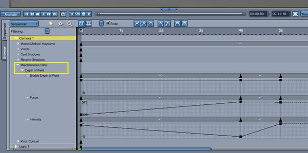

  • 3DAGE3DAGE Posts: 3,315
    Joemamma wrote
    I think it does a simple gaussian blur as a post effect, but there’s no way to change the focal distance in an animation
    Not so. Joe.
    The DOF can be animated using key-frames.
    The focal point can be set on different key-frames, and the intensity of the effect can be changed to provide greater or lesser effect.
    You can also Switch between DOF On and Off,
    Combined with the ability to "Jump to" saved camera positions within an animation, then you have the ability to create more complex shots form one camera angle with Heavy DOF, to a different Camera angle with Less, or No DOF effect
    926 x 461 - 95K

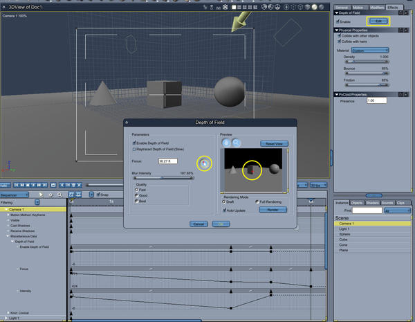

    No problem JoeMamma :)
    The Depth of field can be set to focus on a specific object using the little red Crosshair thing, in the Camera DOF effect window.
    This allows you to click in the preview area to select the focal point, and set a keyframe in the timeline.
    1246 x 966 - 219K
