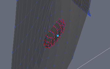

I just started using Hexagon today to create a morph for the Pirate Coat for G2M.  I've got the shape for one side the way I want using Tweak with soft selection.  Now I have to move the buttons.  I am able to select the individual button using the Tweak tool and move it, but I can't rotate it.
I was able to activate the rotate tool, but it rotates the entire coat.  I figured out the pivot point, but again it only rotates the whole coat.
My problem is that I am unable to isolate the button from the coat.  The only way I know how to select the button is using the Tweak tool with soft selection.  I tried the extract tool, but that doesn't work.

Second pic shows the button at the wrong angle.
356 x 226 - 17K

    OK - so it is one object, but separate meshes - this makes it a lot easier:)  You will need to this one button at a time.  To isolate a button, select as many of the facets as you can without selecting any part of the coat, then hold down shift and hit the plus key on the number pad - keep hitting it until it is all selected.  This will select only the button - you can then move and rotate it - use the universal manipulator, not the tweak tool.
