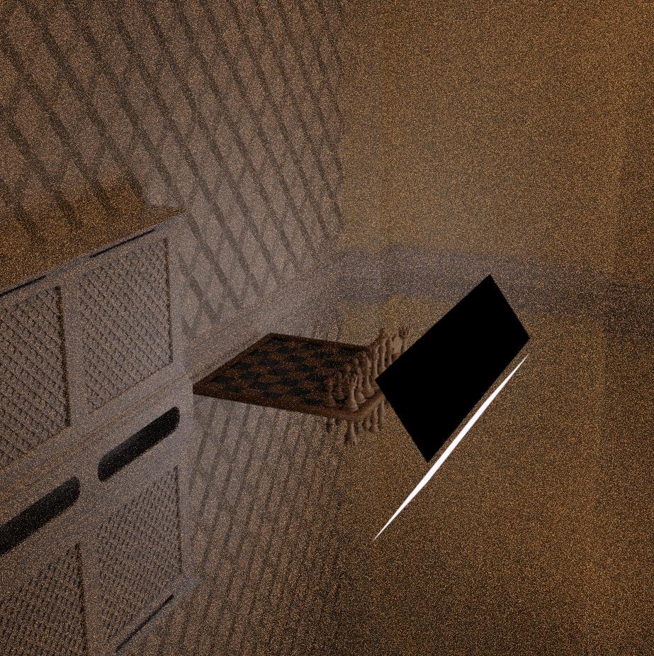

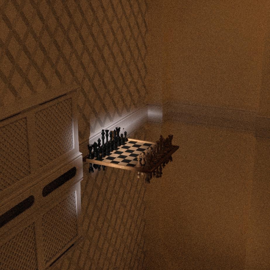

I was noticing some strange behavior with lighting, so ran a test scene with Modern Attic Bedroom.
I set the floor to a mirror and aimed a spotlight with tight focus along the side of the wall, aimed at the floor.
I expected to see the light reflect off the floor and show up on the far wall.  Instead, nothing.
I dropped a chess set on the floor to show where the light was hitting, and also to see if the shadow from it would be refelected.   Nada.
Attached is the render.
Any thoughts?
923 x 925 - 958K
Post edited by TabascoJack on

  • AndyGrimmAndyGrimm Posts: 910
    edited February 2016
    while your render looks in fact a little bit strange - i think this is correct behavior..  a mirror dosent show light (beams) because there is no diffuse scattering ... while the chess board scatters the light in all directions.....
    If you want to see the light SOURCE (a mirror would reflect the lamp - but maybe not on your point of view) you need to switch on geometry on the light.
    Edit: the chess board .. hmmm....   where exactly is your spotlight? i can just guess.. because something IS strange in your render smiley

    Agreed.  I didn't expect to see the light on the floor itself.  I was expecting to see the reflection of the light on the far wall.
    Different example which better shows what I'm talking about.  The only light source is the emissive plane aimed just before the white chess pieces.  Light reflected off the floor should cause the chess pieces to cast shadows on the wall, which they don't.
    Again, I may be confused and it's always acted like this.  I just don't remember.
    923 x 925 - 1M
