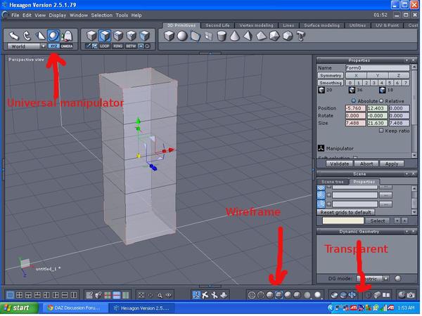

    Place a cube in the scene, select the top face and, using the Universal manipulator, hold down Ctrl and pull up a bit on the blue arrow. Repeat that a few times.
    You should get what I've posted.

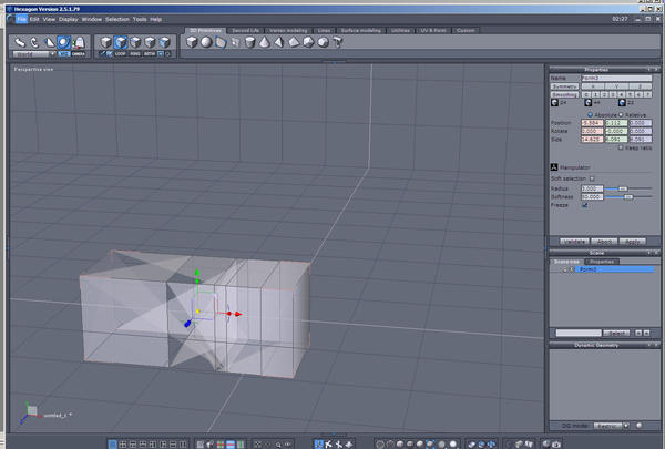

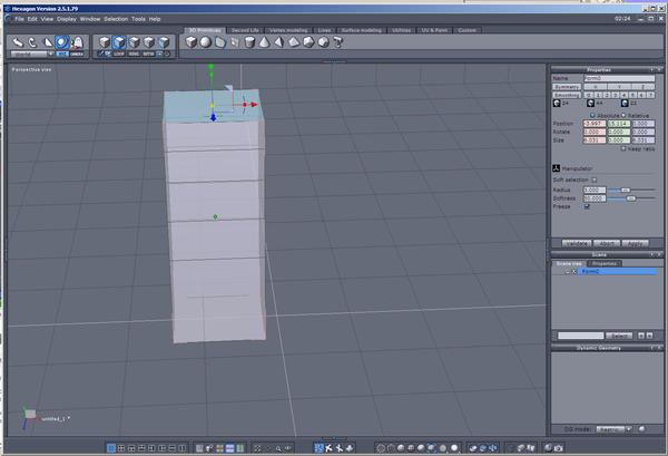

    Also here are three examples of what happens when I use the extrude via the ctrl button.
    The first time worked fine. The second time I tilted it side ways and it triangled. The third time was straight up again and it triangled once more.
    Also I made a cylinder and extruded it? using the same display settings as was suggested. The whole thing turned white, the lines totally disappeared. Even when I select wire frame mode only, the whole thing just vanishes.
