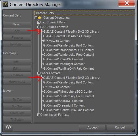

    I ran the EXE files for the Morphing Business Suit (and extentions)  which put the files in the various DAZ folders in WINDOWS, where I can easily find all the various MBS files. In the Content Manager tab of Daz 4.9 (which I downloaded just a few days ago so I presume it is the newest version), The MBS files do not show up. See Pic: the "sicklemar" highlighted contains all the MBS files; this folder does not and will not show up in my content manager. I have tried Import Mapped Directories, as suggested elsewhere, nothing changes.
    If I drag and drop a file, say the SHIRT DSF file onto a character, it just gies me an error message.

  • BeeMKayBeeMKay Posts: 7,019
    edited February 2016
    Is the folder you installed them to "known" to DAZ Studio? Unless you installed it in the default directory, DS will not be able to find them.

  • You can try copying them to the same equivalent path on the new system. But try BeeMKay's suggestion first.

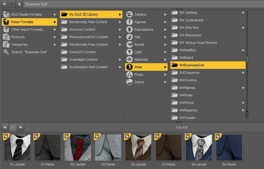

    Okay... I did a bit of research, and this is a M4 suit, correct?
    The entire suit is located under Poser Formats, as you probably already have figured out yourself. The material for DS usually shows up under Pose, when it's "old" content for M4 etc., which is why it's extremely important to map the folder where you have stored your stuff in both the DS format and the POser Format in the Content Directory manager.
    If you haven't already, go to Edit--> Preferences --> Content LIbrary --> Content Library Manager, and add the folder similarly to what you can see in the picture in my previous post (just with your folder names there).
    In that case, the materials for it will be found under "Poses" in the M4Buisiness_Suit folder. Select the item, like Jacket, and apply the material.
