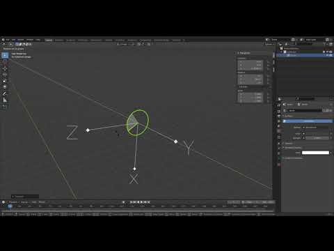

    In current DS version, it's not like Blender where there's a Gimbal orientation view, so actually you're not able to reproduce a true Gimbal Lock in DS Viewport, e.g. X Axis and Z Axis are overlapped together, with same rotation result.
    But if one firstly rotates an object's Y Axis to +90 degree, then rotate Z Axis by using Gizmo in Viewport (with Blue circle), it'll behave like an effect of Gimbal, i.e. the object is rotated on X Axis (with default Local Coordinates).
    In such a case, if one rotates Z Axis by dialing Z Rotate in Parameters pane, or change to World Coordinates then rotate Z Axis with Gizmo in Viewport, there'll be no issue at all.
    Or, create a Group node or null node on the object and manipulate the parent node ~~
