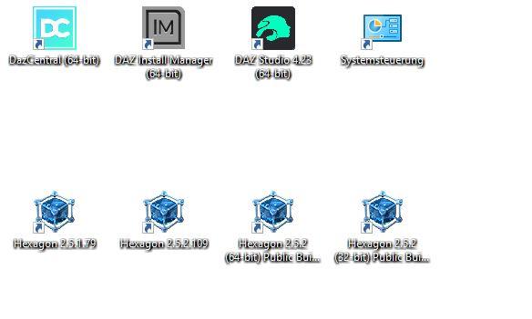

    It is as Richard writes, you have to activate the beta in Daz Central, only then can you download it.
    But you can also work with the 32-bit version.
    Working with Hexagon 32-bit
