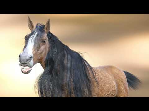

  • ImagoImago Posts: 5,812
    Artini said:
    Thank you very much, @Dobit
    Now Anilip3 works for me with Daz Horse 2.
    Doesn't look very precise... Or it's just a super quick test?
  • ArtiniArtini Posts: 11,012
    edited November 2024
    It was just a super quick test.
    Still need to learn and experiment with Anilip 3 much more.

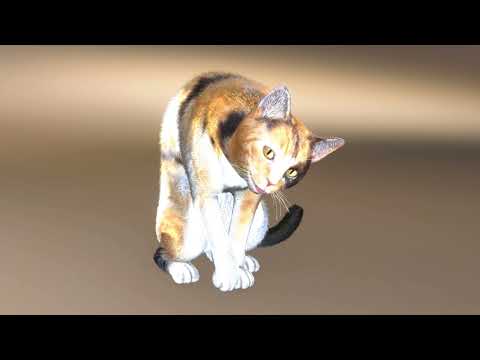

    I like that I can get results from Daz Studio almost directly
    (besides combing video and sound in the external video editor).
    Below is a test with Daz House Cat.
