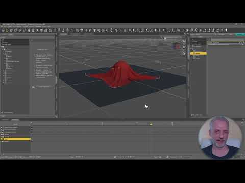

    Jay Versluis has a video on how to do it (with a simple simulation, but it should work on any object):
