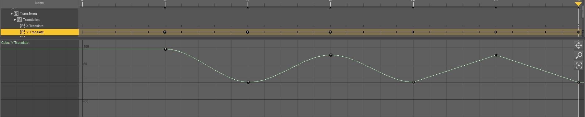

    I moved the cube up and down at frames 5, 10, and 15. Then I ran the script. The I moved the cube and frames 20, 25, and 30 - the keys created seem to have switched from TCB to Linear as they should.
    1874 x 376 - 81K

  • Right, it chnages the default (the kind of key created when a new key is created after running the script - note that this seems to affect the outgoing behaviour, as you can see in my screenshot above the line graph line coming into the Linear key iss till curved from the preceeding TCB key, so you won't see the difference on the first new key created at the end of a run of previously created keys.
