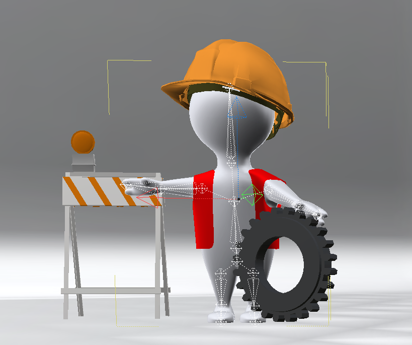

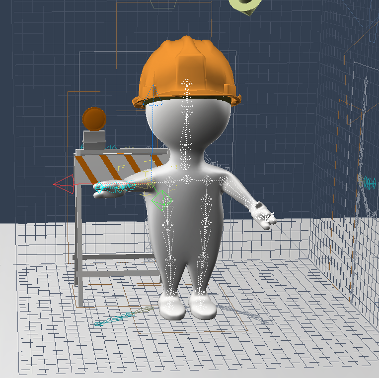

    In the meantime this is how I fixed the bones as you mentioned before, and I have added the moving parameters too. :
    877 x 622 - 132K

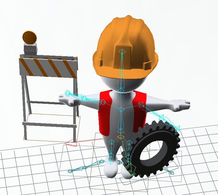

  • otodomusotodomus Posts: 332

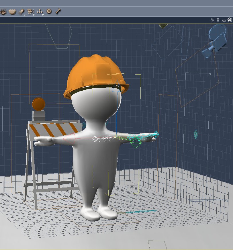

    edited February 2016
    This is the first set almost complete:
    772 x 650 - 130K
    Post edited by otodomus on
  • 3DAGE3DAGE Posts: 3,315
    Hi Ottto :)
    I thought we'd scared you away :).
    what you're doing normally scares people,. there's so many new things, and so much to learn,. you're doing well,.
    1-How can I make a bone smaller? I had to upper-size the worker because the bones were too large for it.
    Two ways,. "when you're drawing the bones",. Click and hold the SHIFT key while holding down the mouse button,. you can drag to shrink the size of the bone,
    After you've built your skeleton,. (but before you've attached it to the model) , you can go to the Animation menu / Orient joints,. (this has an option to effect the children) so if you select the HIP, and Orient joints,. this should align and scale all the bones.,.
    2-How can I attach the helmet to the head and make that both moves along
    This is actually quite easy,. You can drag the Helmet "model", (in the scene list),., and drop it into the "Head" bone of your figure in the list,.
    What that does is "Parent" the helmet to the head,. (the helmet can still be moved or rotated into position),. but if the figure is animated,. the Helmet will stay parented to it's head and move along with it.
    3-I am also working in a vest that needs to have attached also the movements of the rest of the body
    This one is a little trickier,. but simple,. you can Copy the "Vest" model (in the vertex modeller Select all / copy),. and Paste it into the figure model in the vertex modeller,.
    Or ....Model the "vest" directly onto the figure in the vertex modeller,. (see pic)
    NOTE: You need to detach the Skeleton from the model before you edit the model.(Select the model,. go to Aimation menu / Detach skeleton) ...Once you've added the "Clothing" to the "Figure" Model,.you simply re-attach the skeleton again.(Select the model and it's bones,. go to Animation menu / Attac Skeleton)

    The bones you've got now, look much better, ....one concern is that the arms seem to have one bone from the shoulder to wrist,. (that may be due to now knowing how to sale the bones as you draw them),..but it also depends on what you need the figure to do, or how it will move,. and you can rebuild thoseif you need to have more flexibility,. Bending arms.

    3DAGE said:
    Hi Ottto :)
    I'm fairly certain (though I've never tried it, but heard Wendy mentioning it) that it can be a lot easier than that by just selecting the vest and using "Follow Skeleton" (?)
