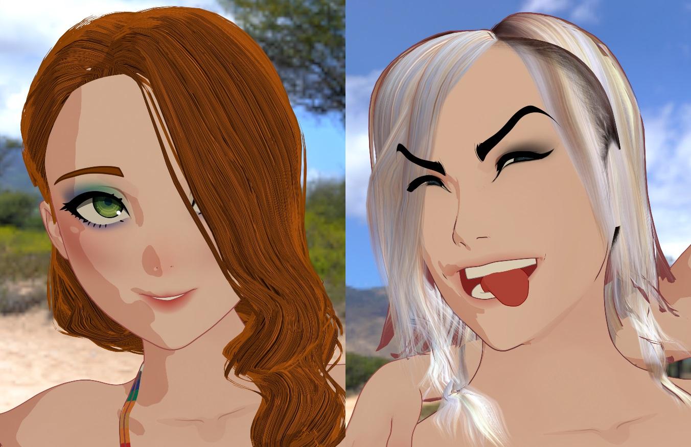

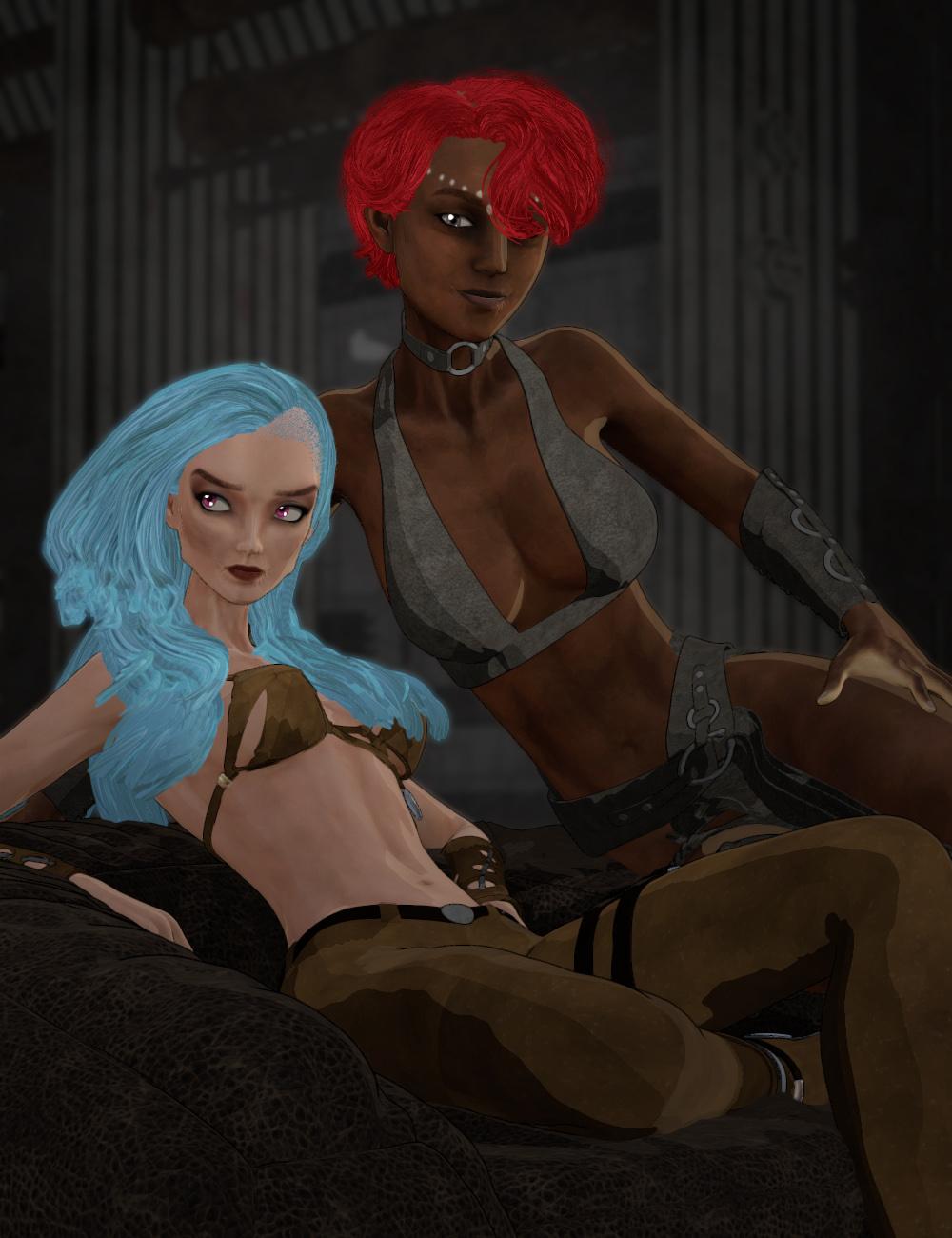

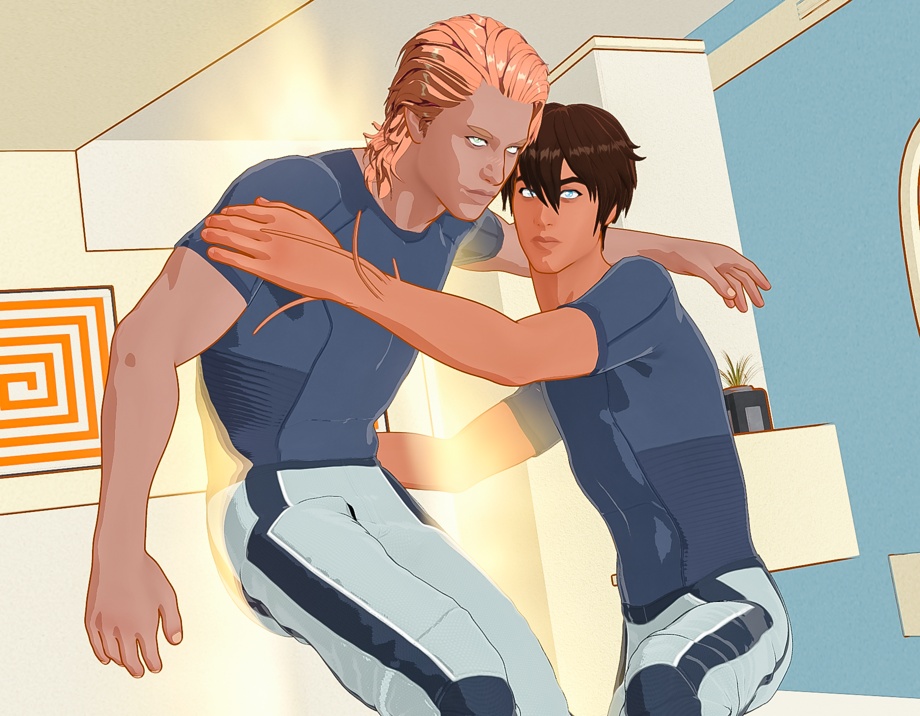

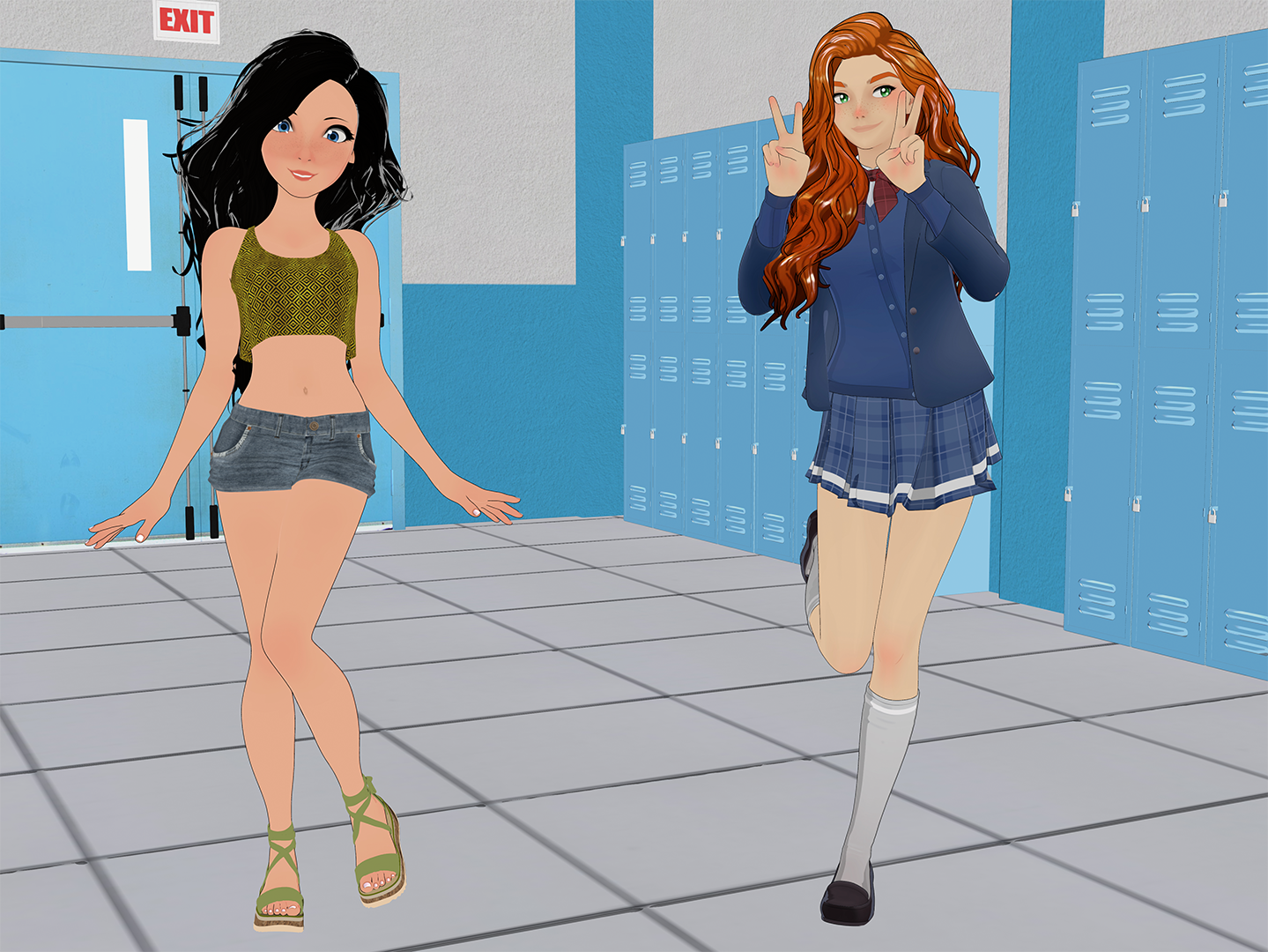

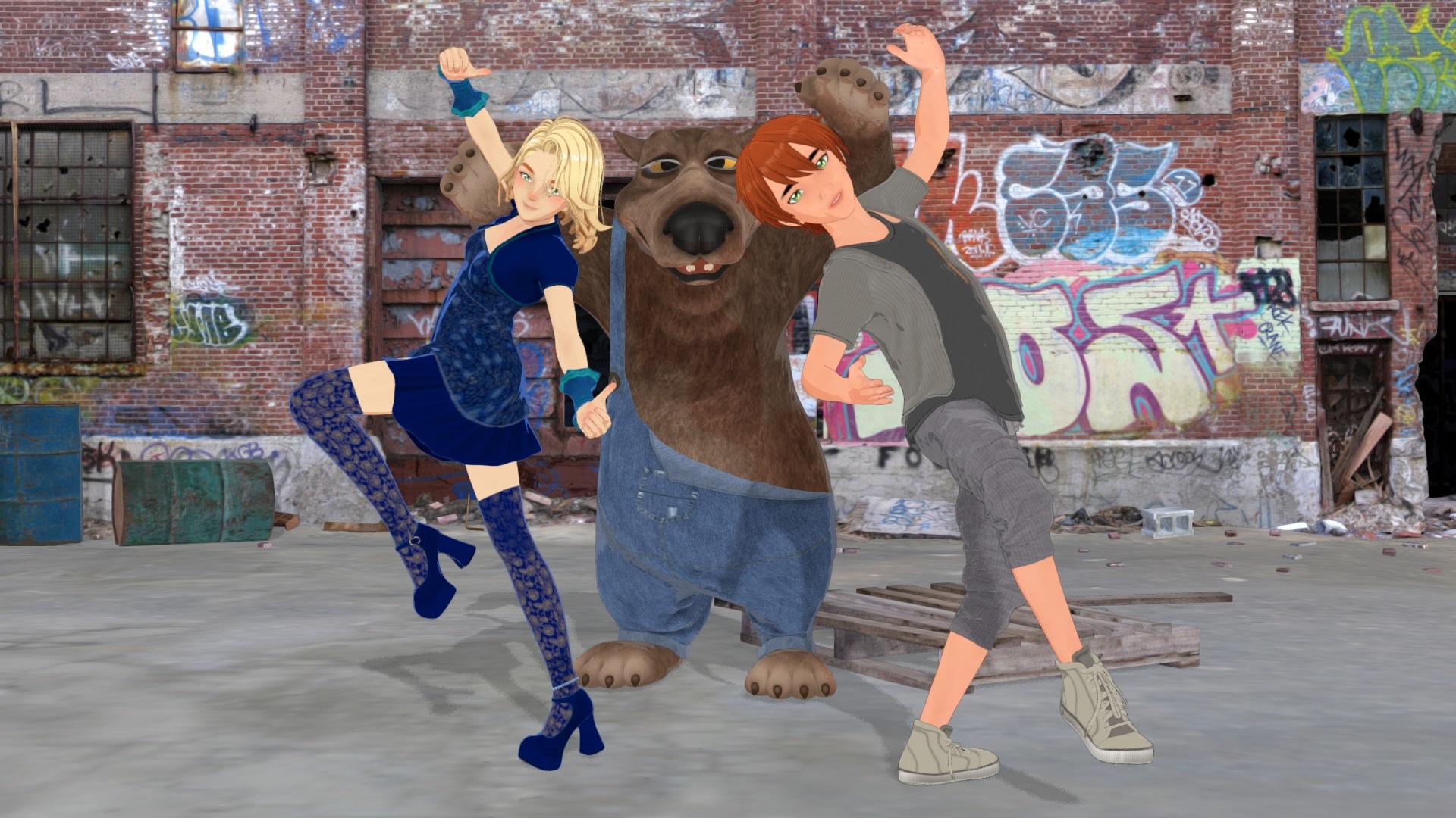

    Ghosty12 said:
    My latest, lots of trying out different things with this image, it is quite difficult to do a daytime image without a lot of wash out. Trying to get deeper shadows have yet to get properly, both characters are Vicky 9 mixed with other G9 character morphs. Now that was interesting as found adding in G9 characters onto Toon G9 got some wildly out of proportioned figures, where you would have a skinny torso and overly large hips. blush But after a lot of trial and error and learning how different Toon G9 is to G8F, I think I worked it out. Anyways here are the results of all this. smiley
    Yes, I noticed that too! Full body morphs from other characters only affect the top part of the body and I have to go in and manually adjust the hips/thighs/legs to match the top half. I'm  hoping that's something that will be fixed!

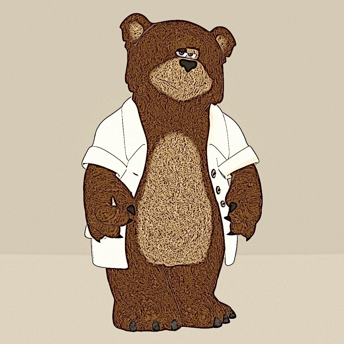

  • SolitarySandpiperSolitarySandpiper Posts: 566
    edited October 2024

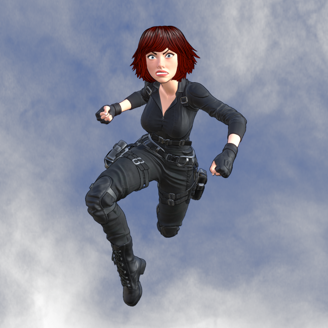

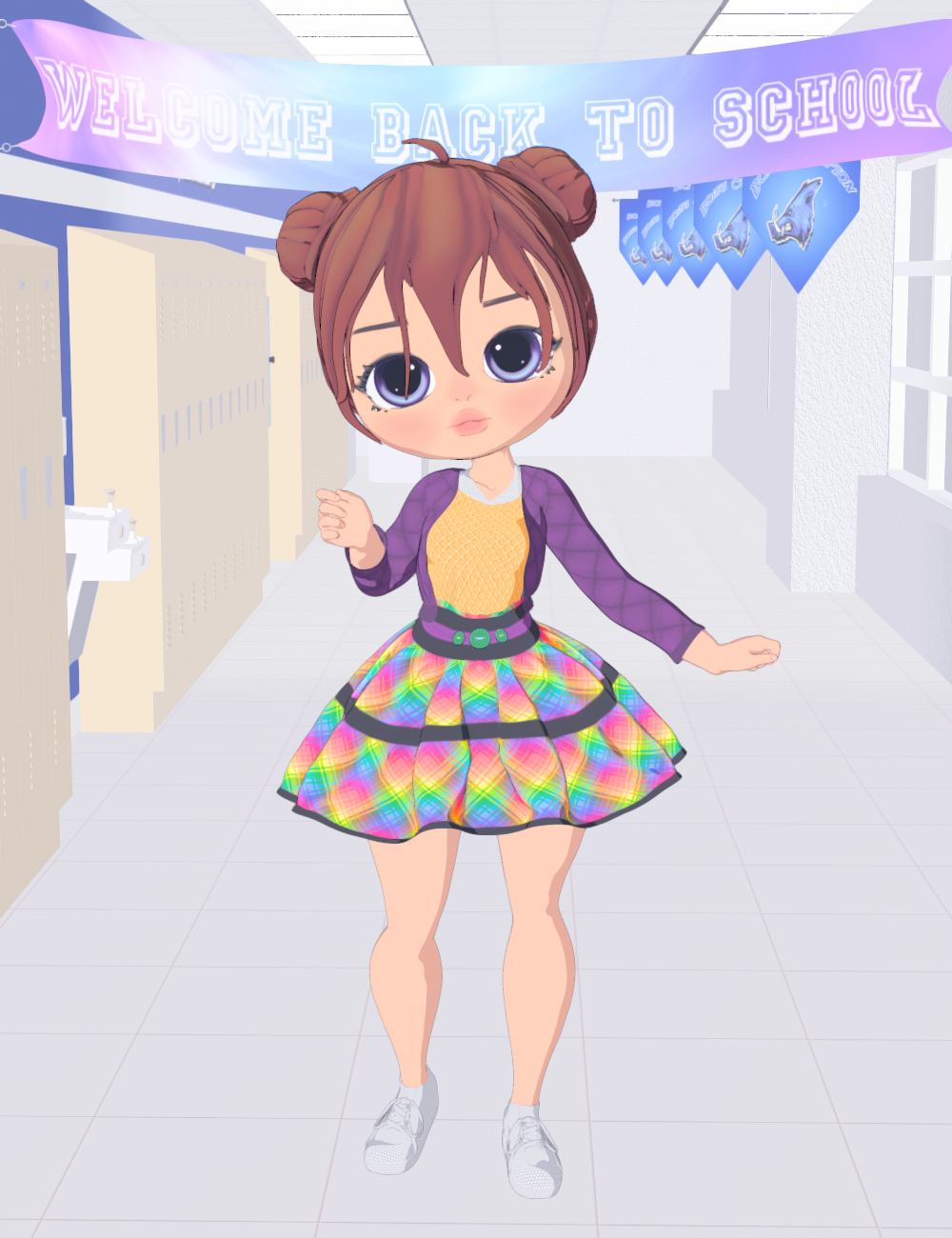

    Vicky looking forward to home time.
    3000 x 1854 - 2M
    Post edited by SolitarySandpiper on

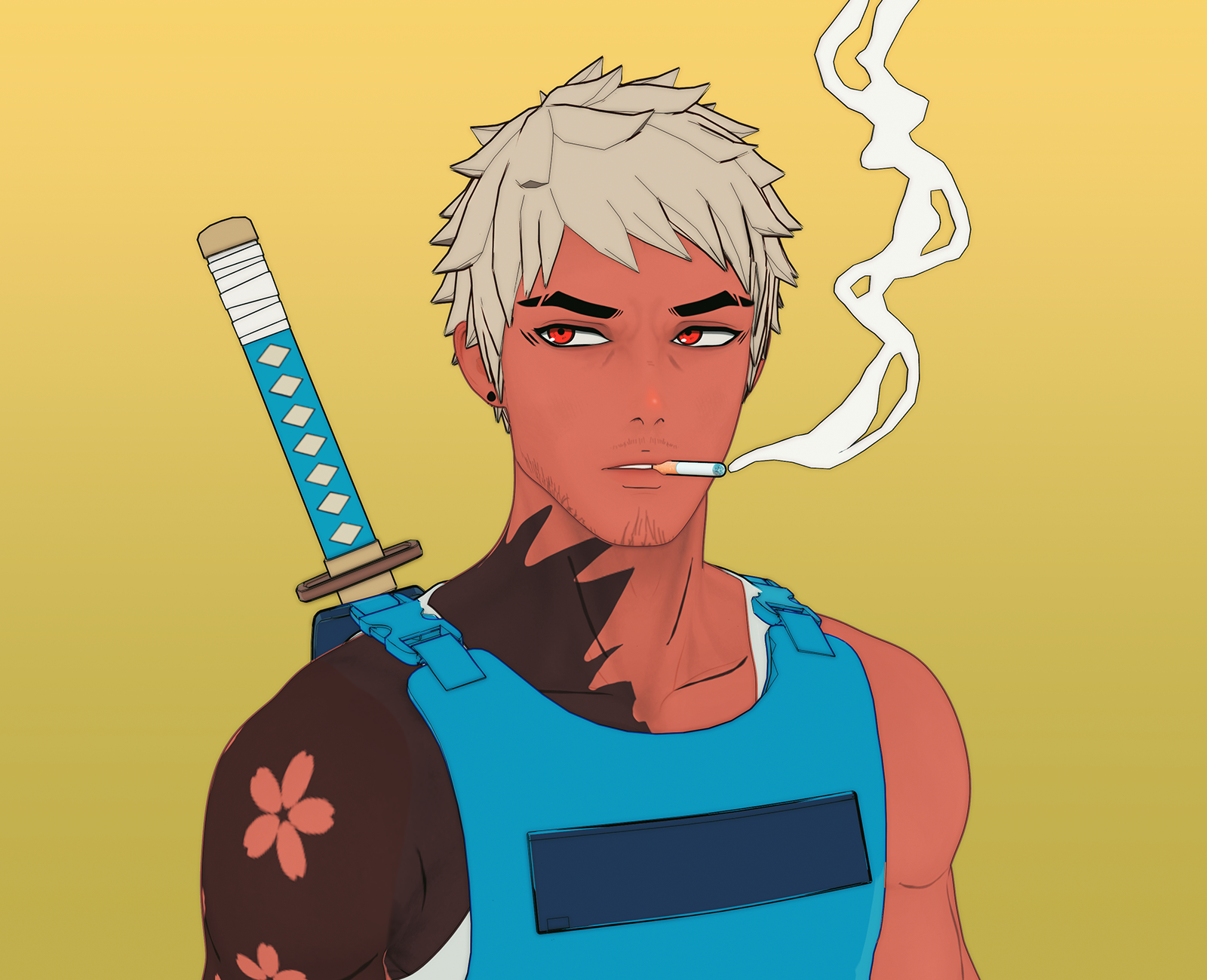

  • TheNathanParable said:
    Don't look behind you...
    Gallery link: https://www.daz3d.com/gallery#gallery=all&sort=newest&page=1&image=1352413
     This looks SO GOOD! I'm so in love with these shaders and I'm happy that Visual Style Shaders work super well with filament and filatoon.

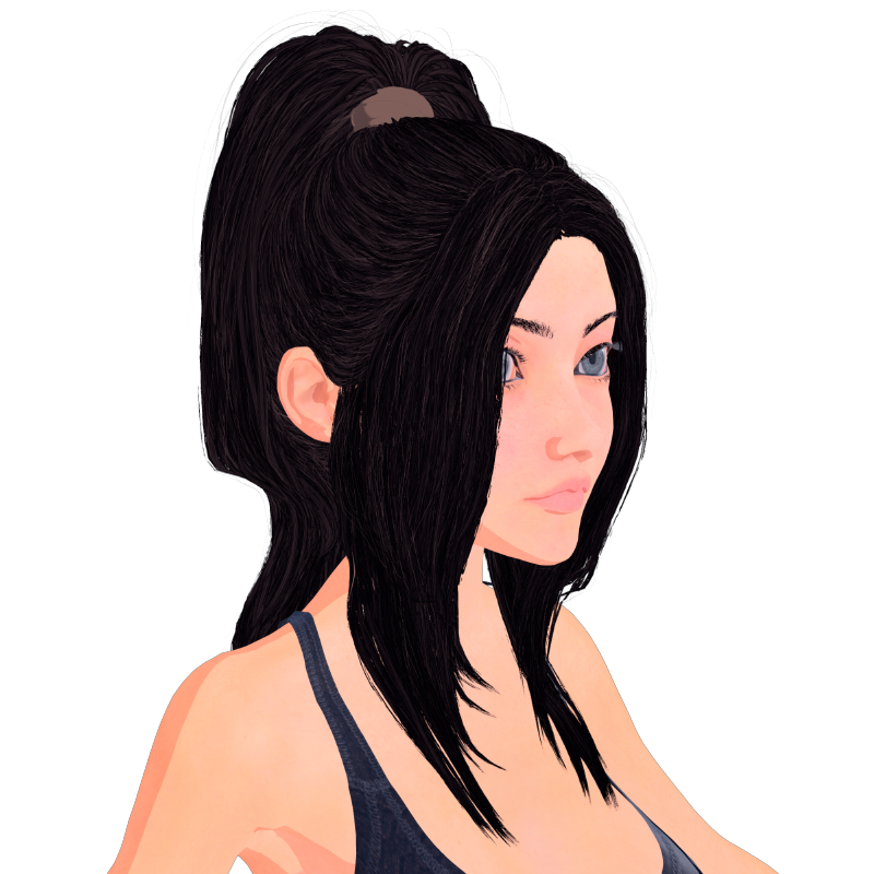

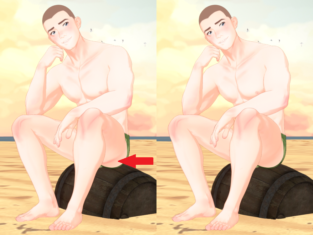

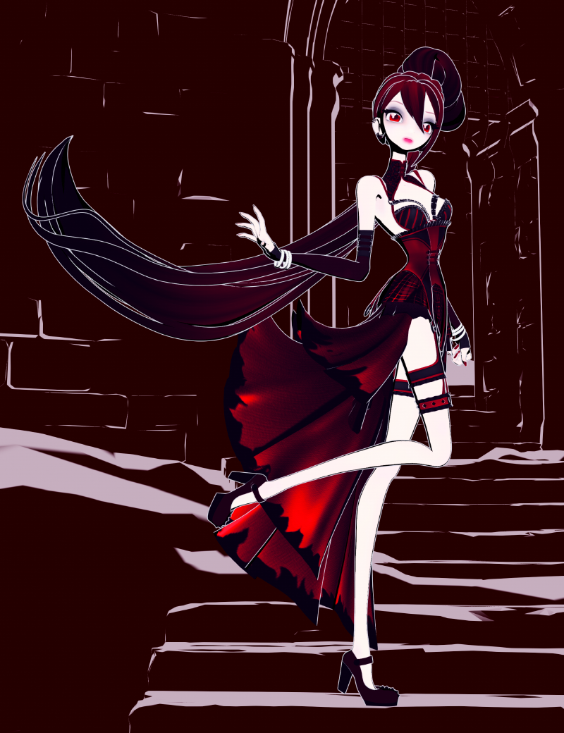

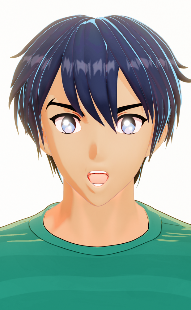

    Since I dabbled with LUTs I "discovered", that my postwork workflow needed some adjustments. I use "detect edge" filters to get some basic lineart, and so far I could handle it by adjusting the threshold. But in some cases, I need to remove some extra lines manually. In my case, it doesn't bother me b/c I already add some lines by hand, so removing others isn't complicated. But for newbies, it could lead to unexpected issues, if they don't know about this. I kept the line on her chin as an example.

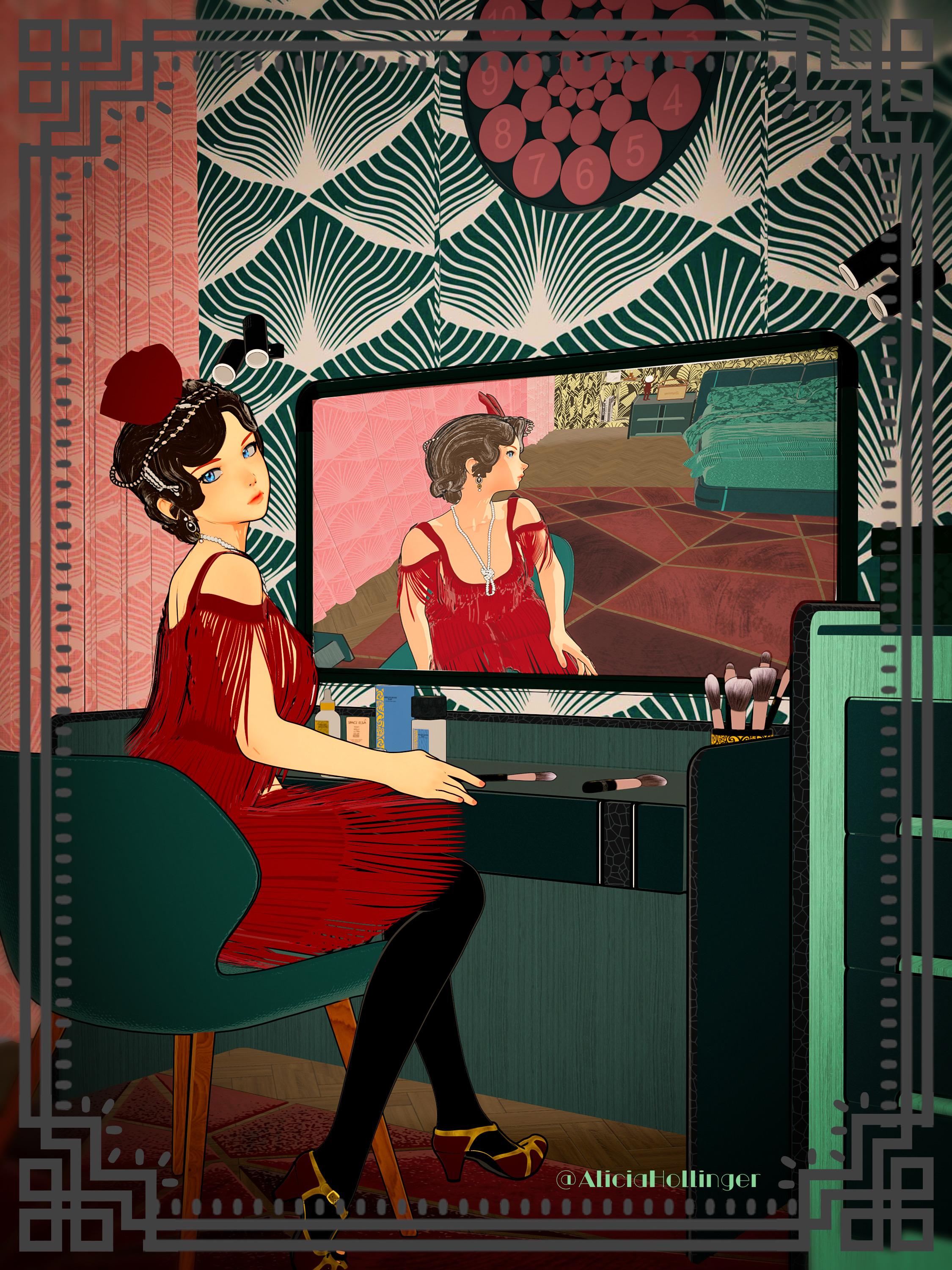

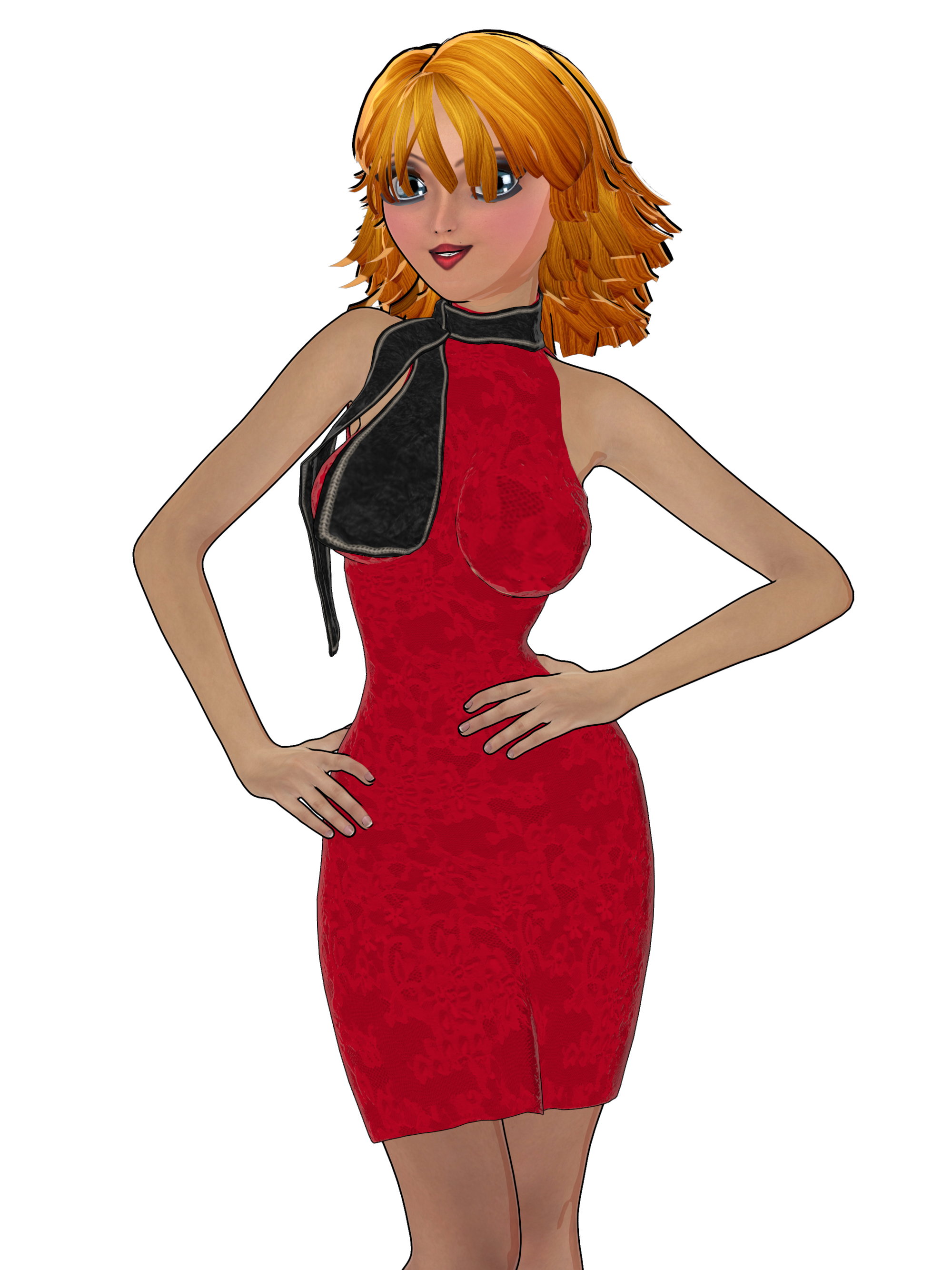

  • Rosie DRosie D Posts: 76
    edited October 2024

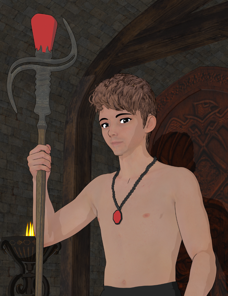

    Thought I'd give it a try
    1300 x 1000 - 794K
    Post edited by Rosie D on

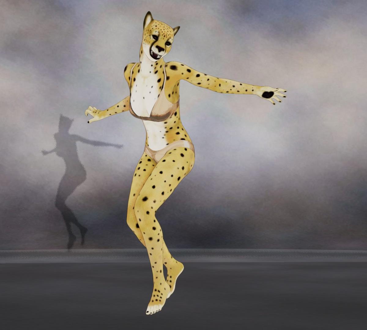

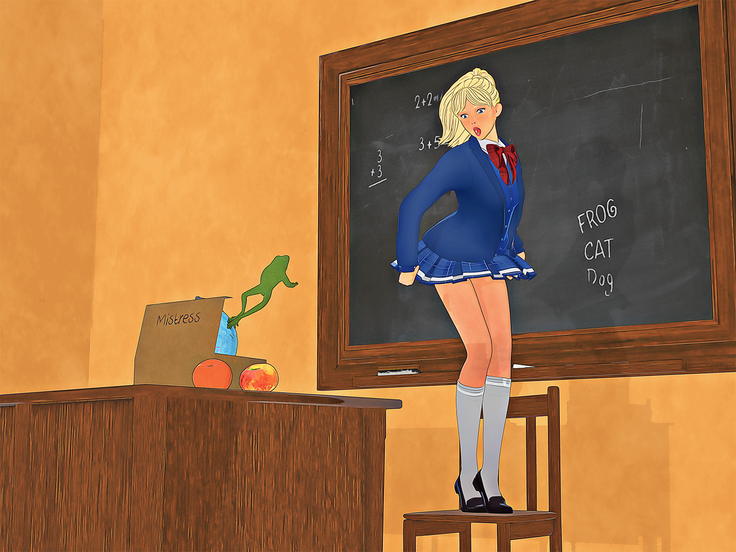

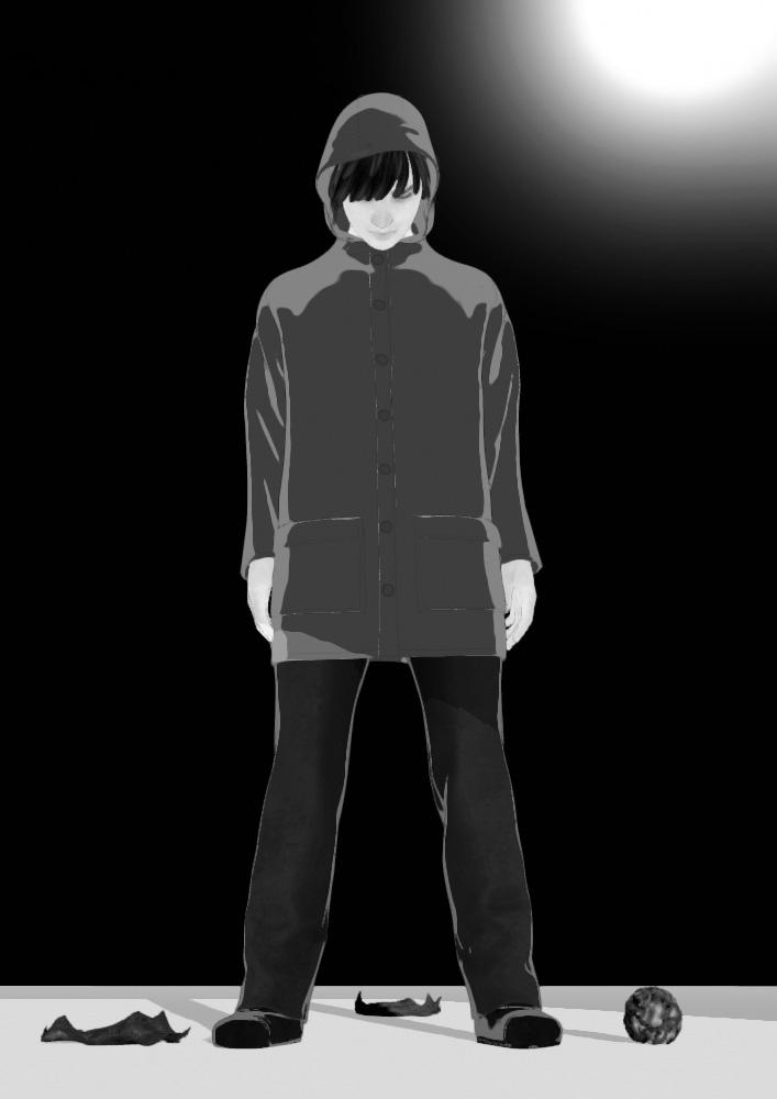

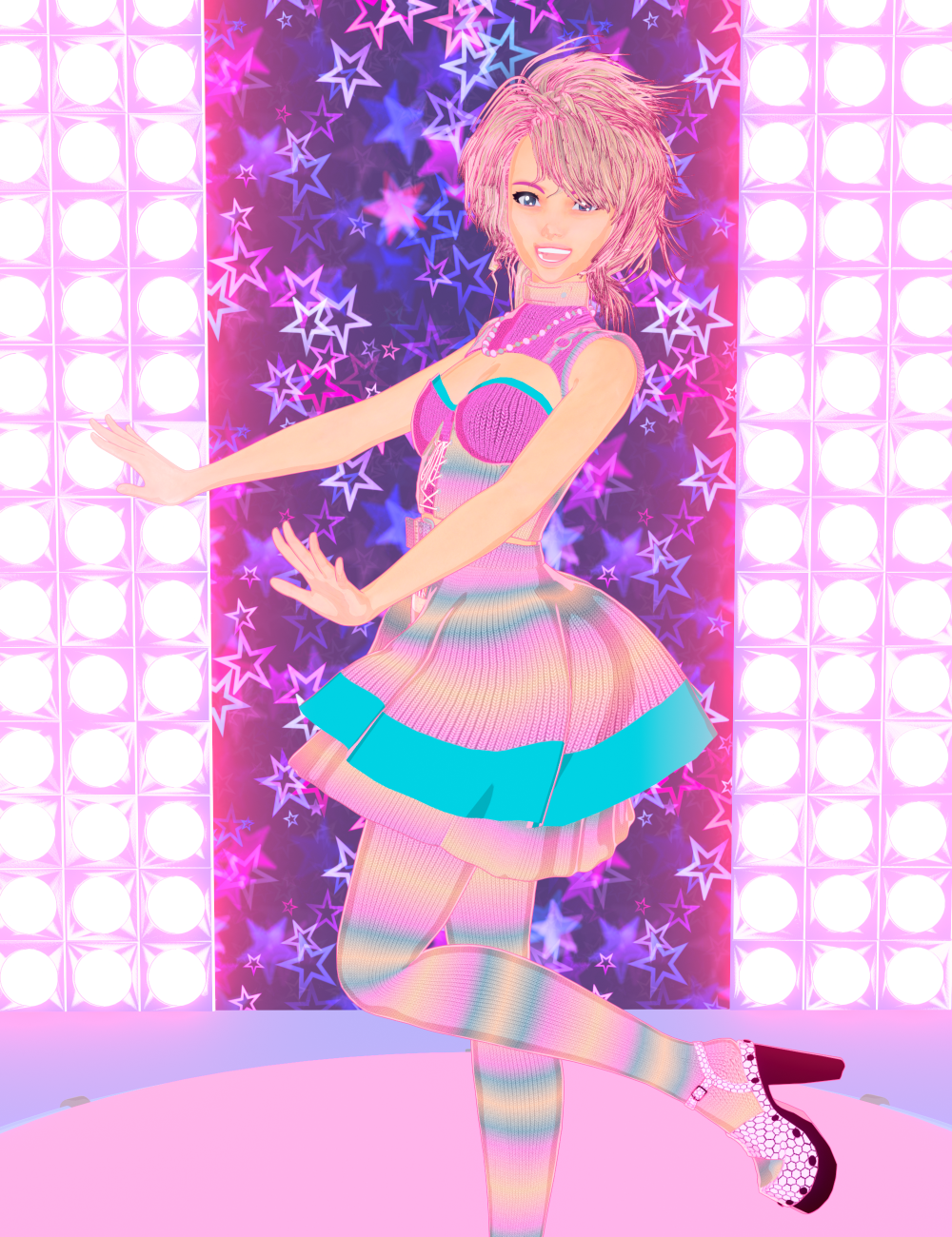

    edited October 2024

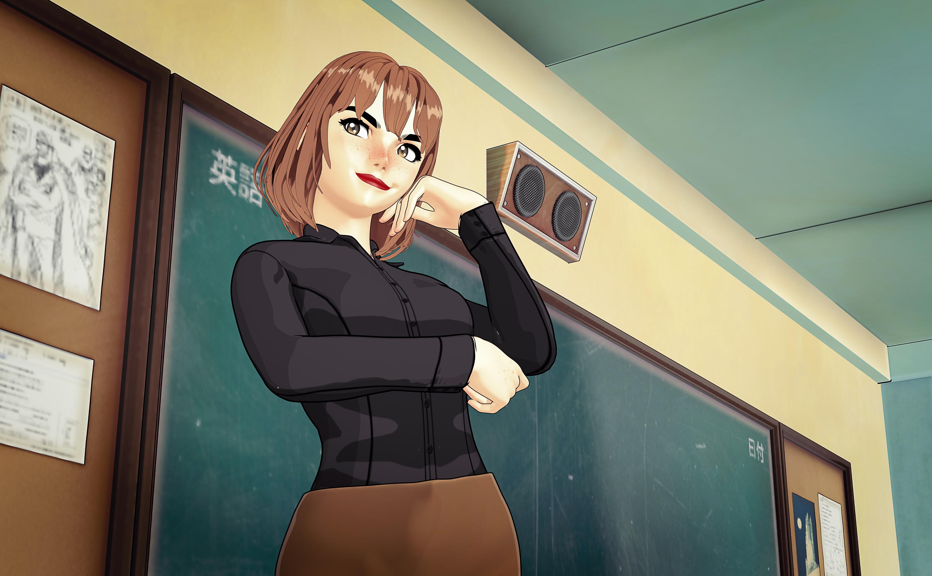

    Quick Monochromatic conversion.
    1146 x 1679 - 1M

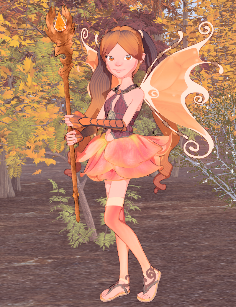

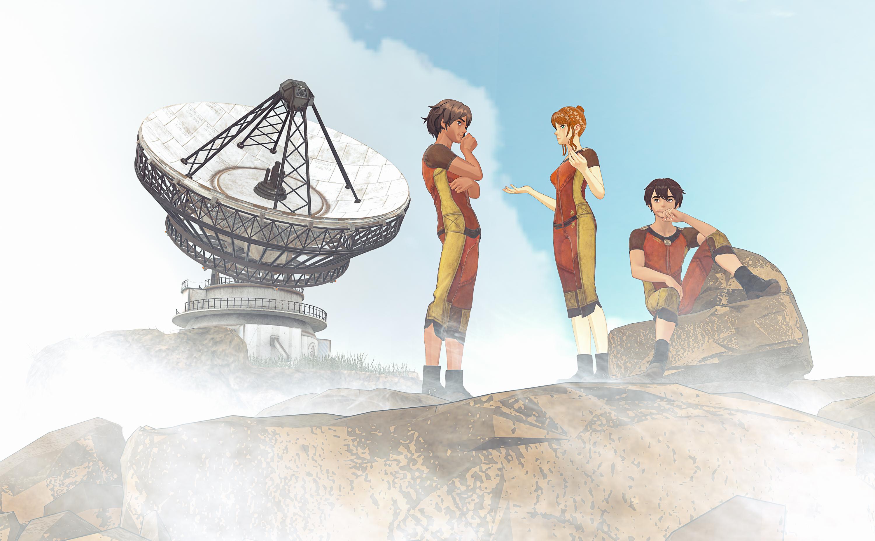

  • Wyrd PixWyrd Pix Posts: 20
    edited October 2024

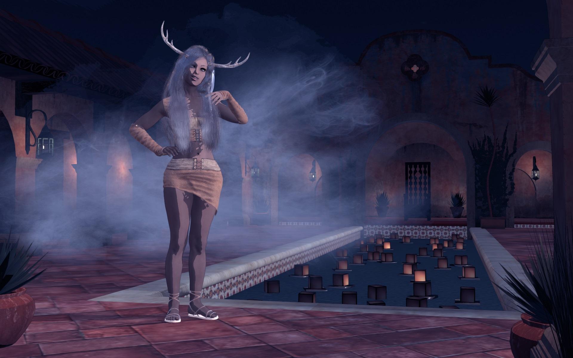

    Thanks! I do wanna clarify though that these aren't my Visual Style Shaders (they only work in 3Delight, and not Filament), these are the standard FilaToon shaders with some tweaked parameters (such as shadow smoothing and colours). I'm still in the experimentation phase, and would like to eventually create a pack of FilaToon presets recreating the look of Visual Style as close as possible.
    Oh yeah I was saying that I'm using visual style shaders along with filatoon to achieve a more toony look, so I'll apply VSS first and then filatoon on top. ;D
    Here's what I'm working on, I found some things like the leaves and antlers/branches are better with just VSS, while non toon hairs really benefit from VSS + Filatoon;
    2840 x 2840 - 6M
    Post edited by Wyrd Pix on

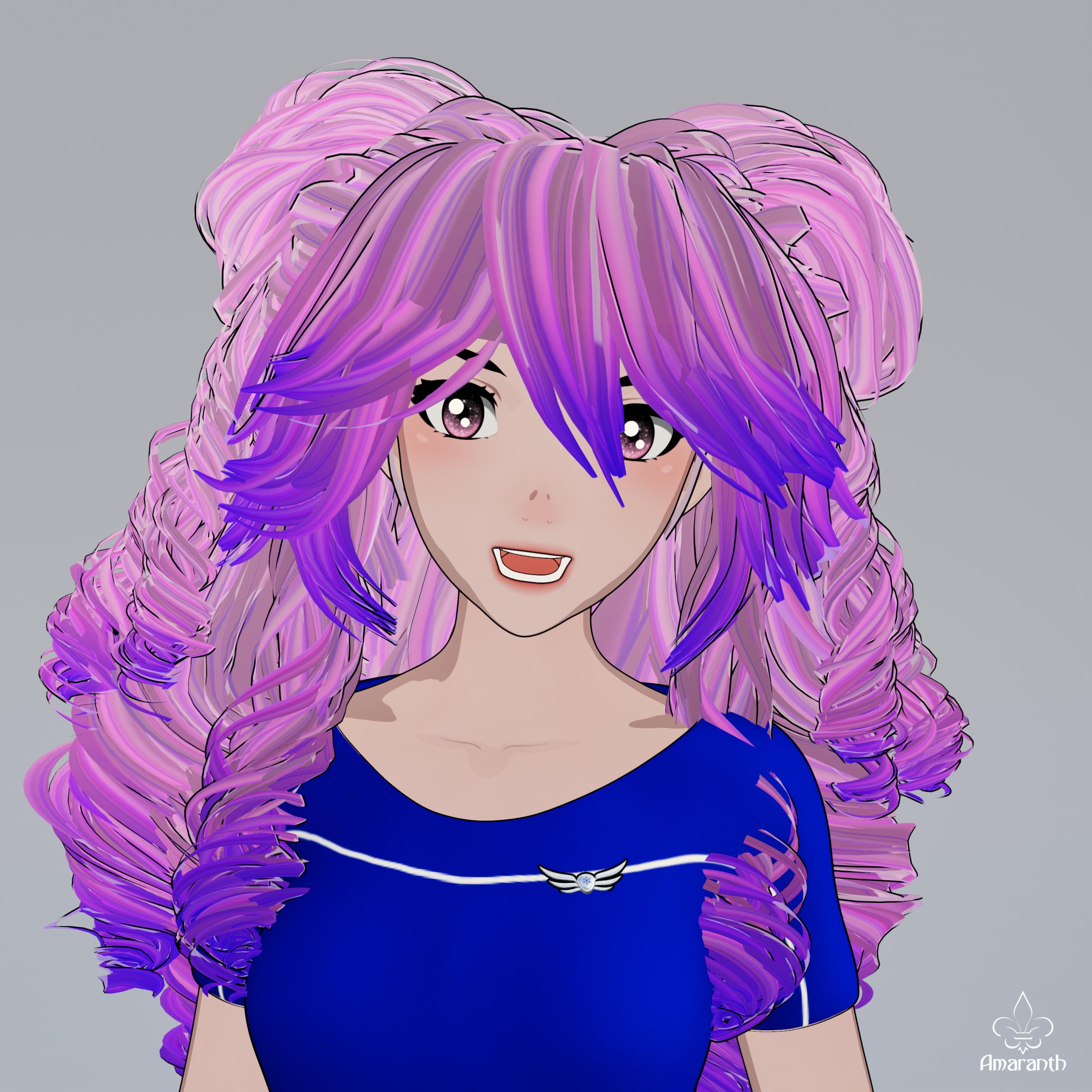

    Shading, shading and bloom. Still, a lot to learn and I love this shader for it.

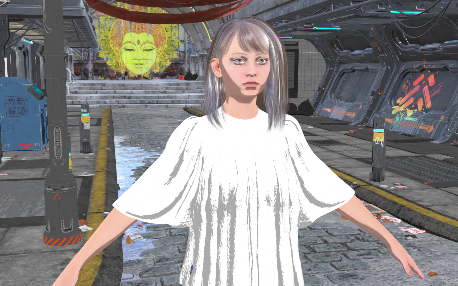

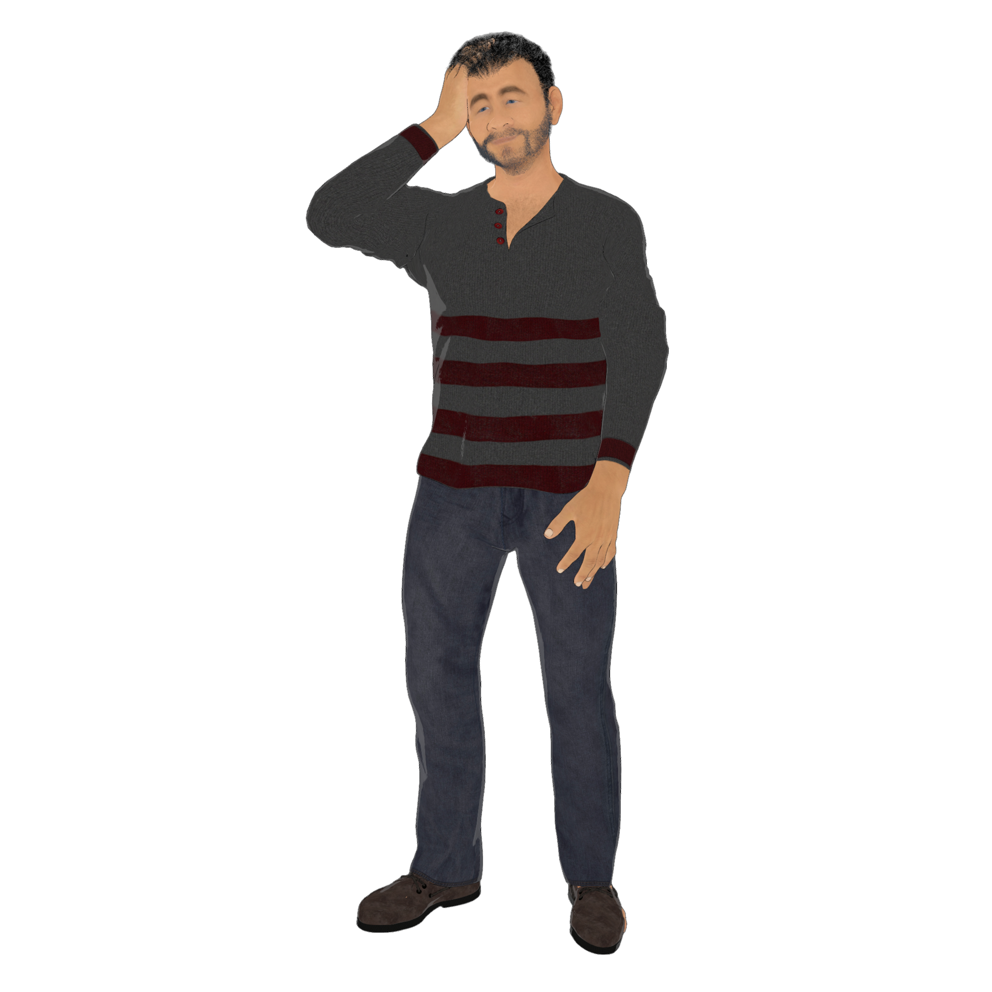

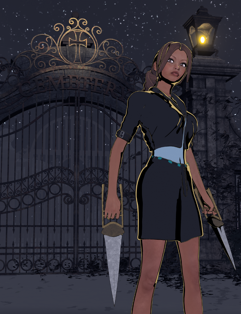

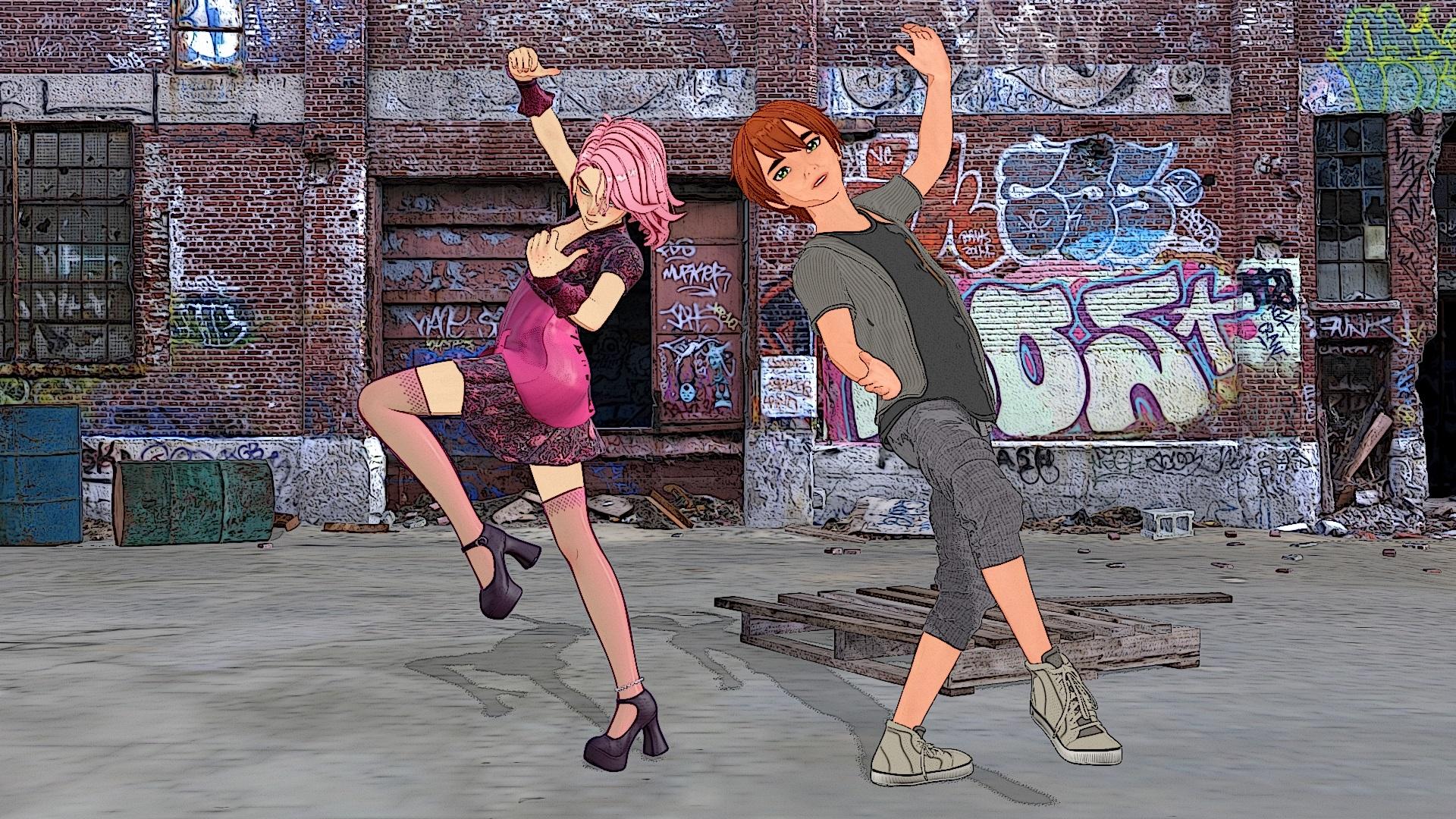

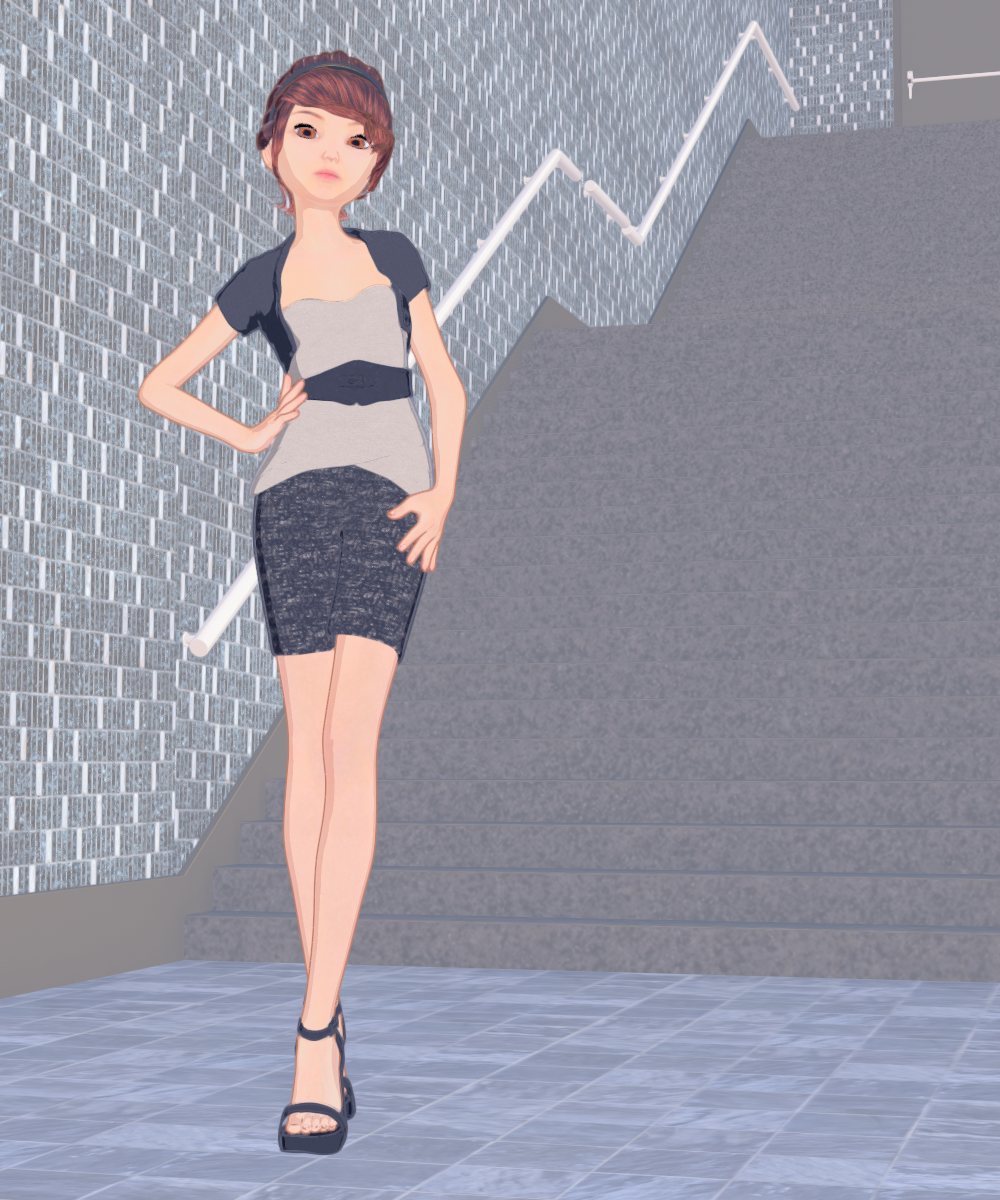

  • Progressed a little on the toons. How should i work with environments? Adding dodgy cartoon background like this isnt like the real thing.
    1680 x 2160 - 2M
    I personally recommend two things:
    1) Invest in some simple environments. Maybe even go for the older pre-iray environments, as they tend to have simpler geometry that might work better with Filament.
    2) Invest in some of the Filament specific products available here, such as https://www.daz3d.com/atmosphere-for-filament or https://www.daz3d.com/sy-atmospheric-blur-filament to add a bit more colour detail to the backgrounds.
    With those aformention products, you'll need to apply the filatoon shader to them (I recommend the "constant" preset) and then making sure to turn off "cast shadows" in the shader settings.

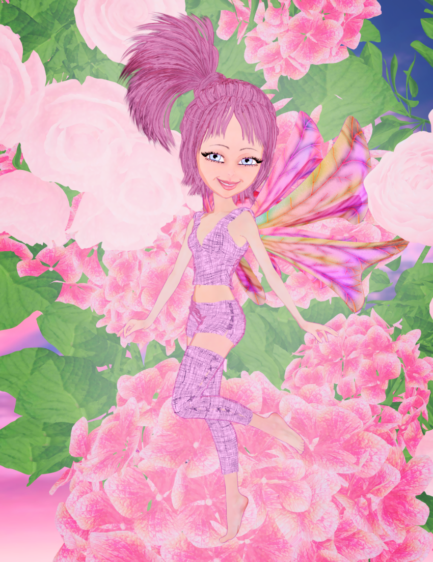

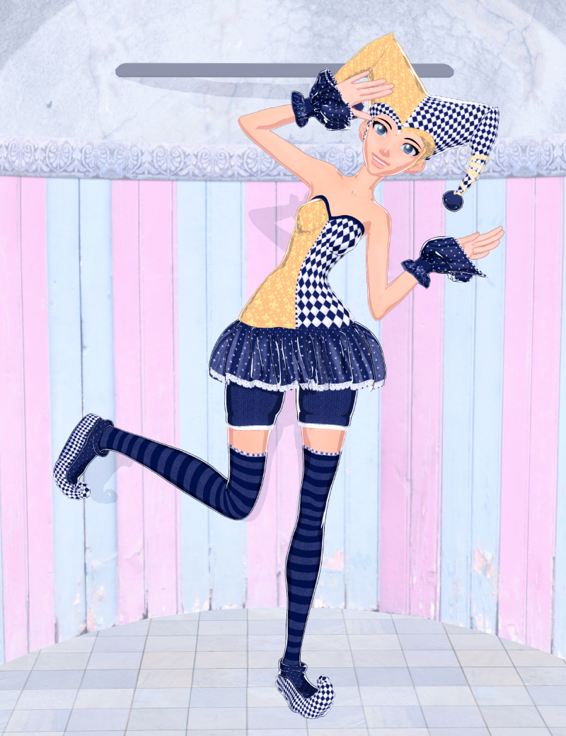

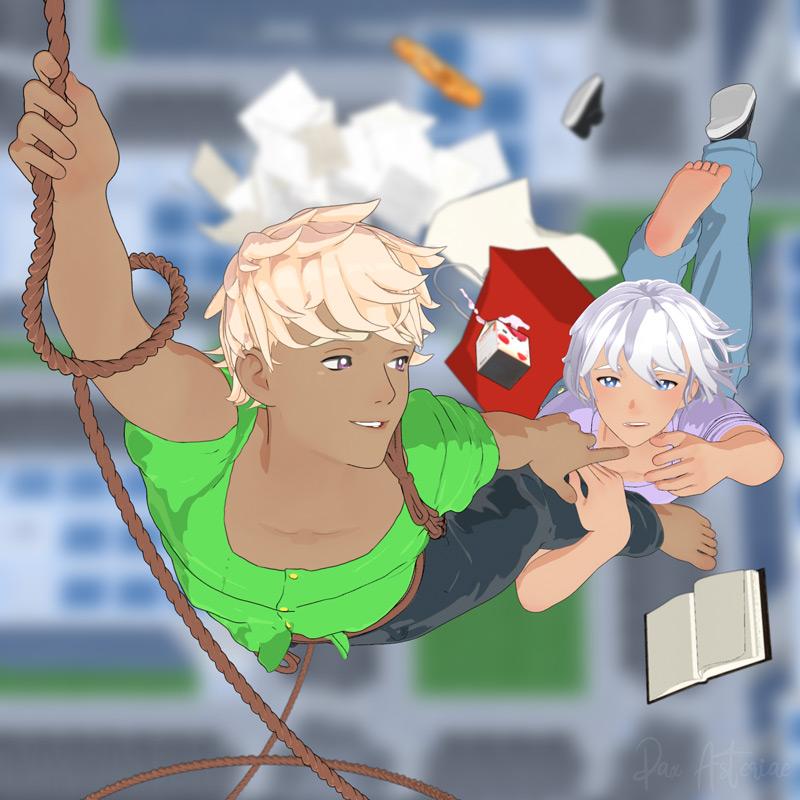

    edited October 2024

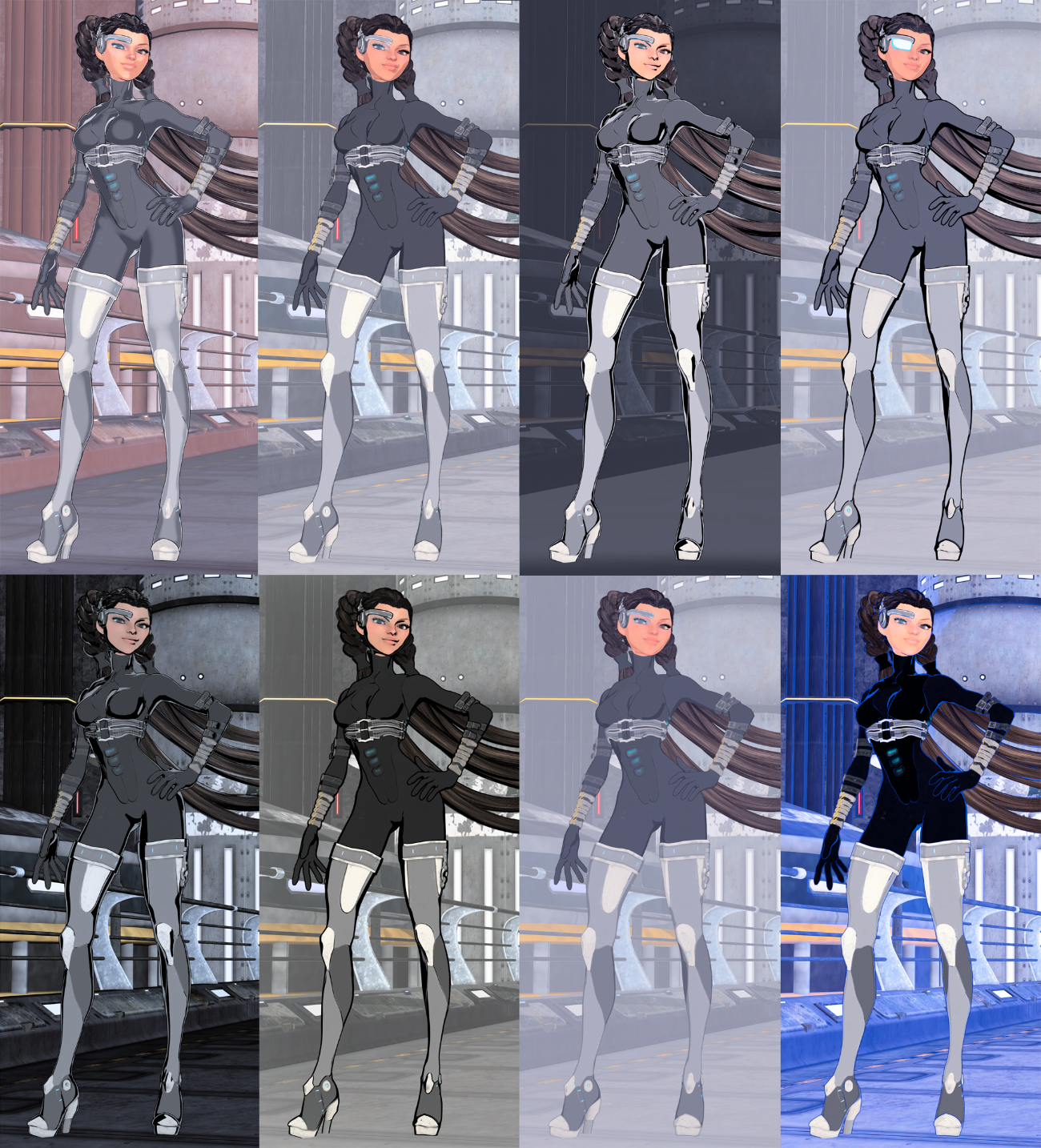

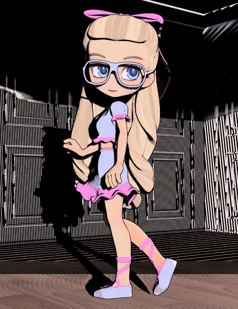

    Had some fun rendering in layers then stacking them in Photoshop with various levels of blur.
    800 x 800 - 155K
    Post edited by Pax Asteriae on
    I'm so glad to see you're still active Pax! Great work as always!

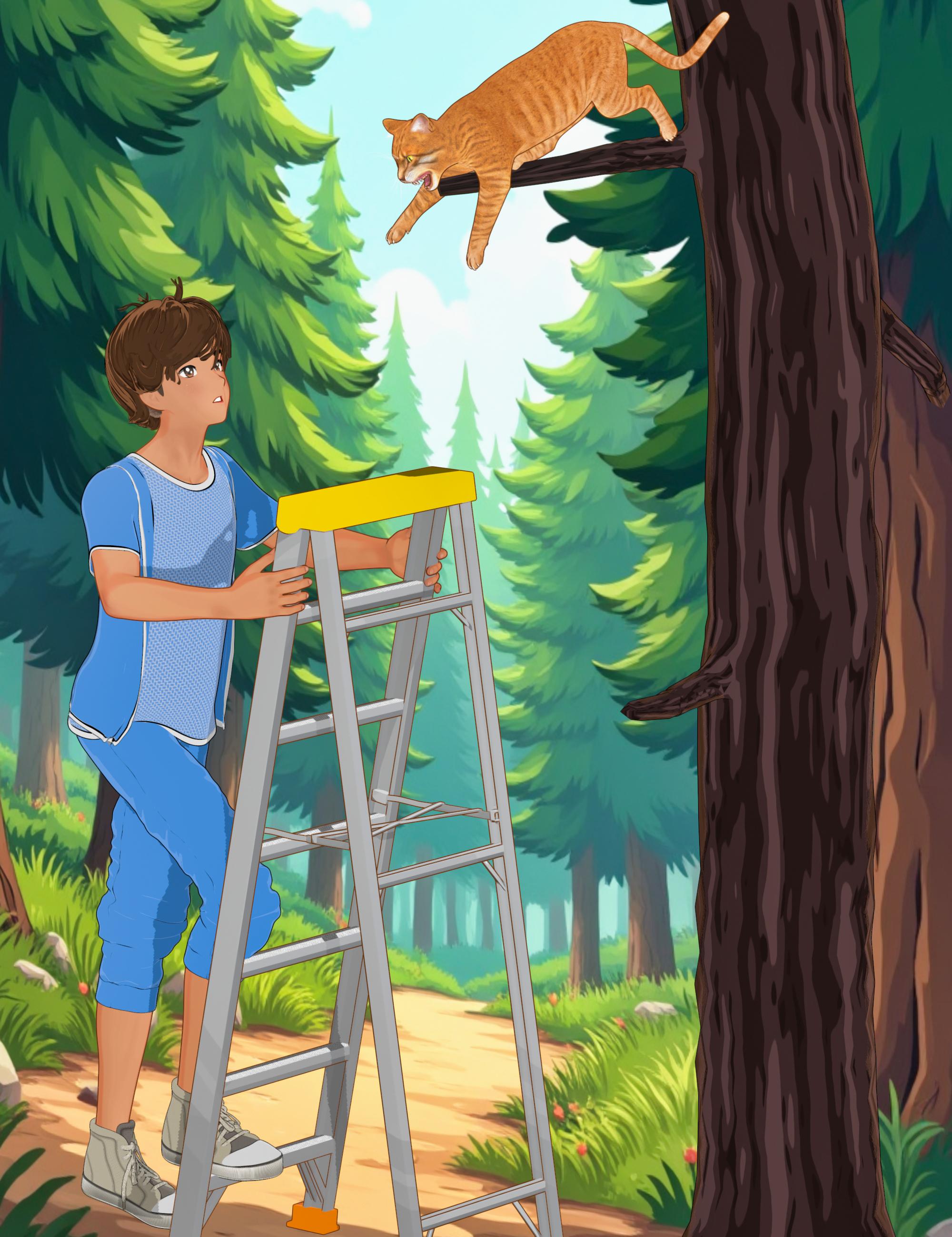

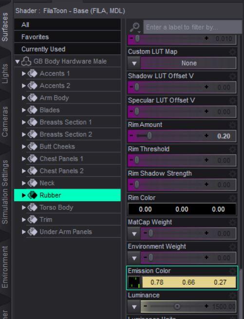

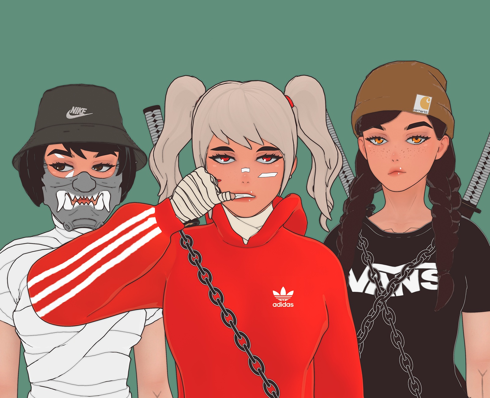

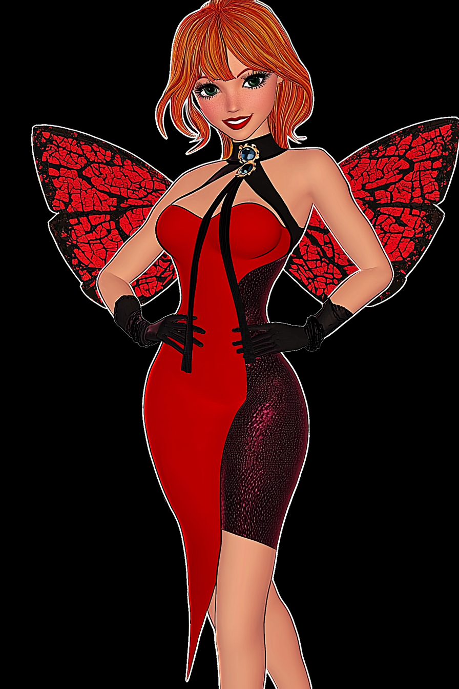

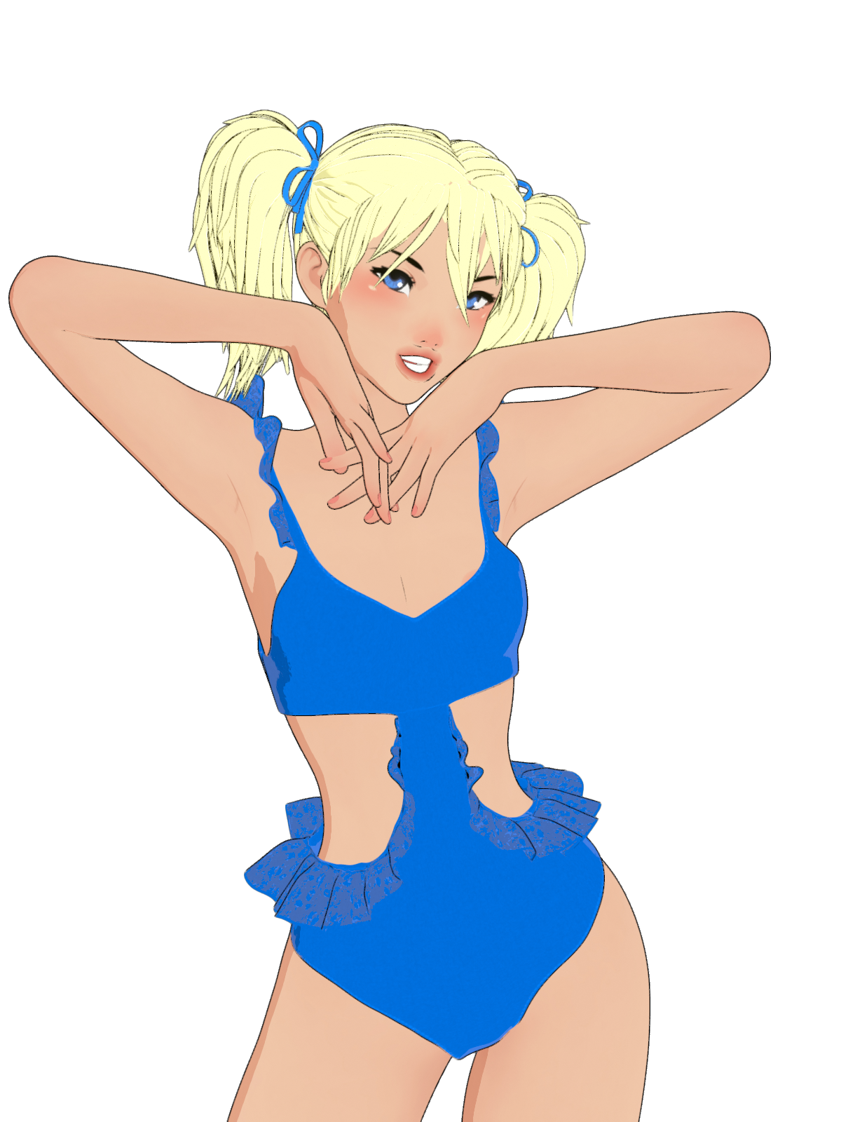

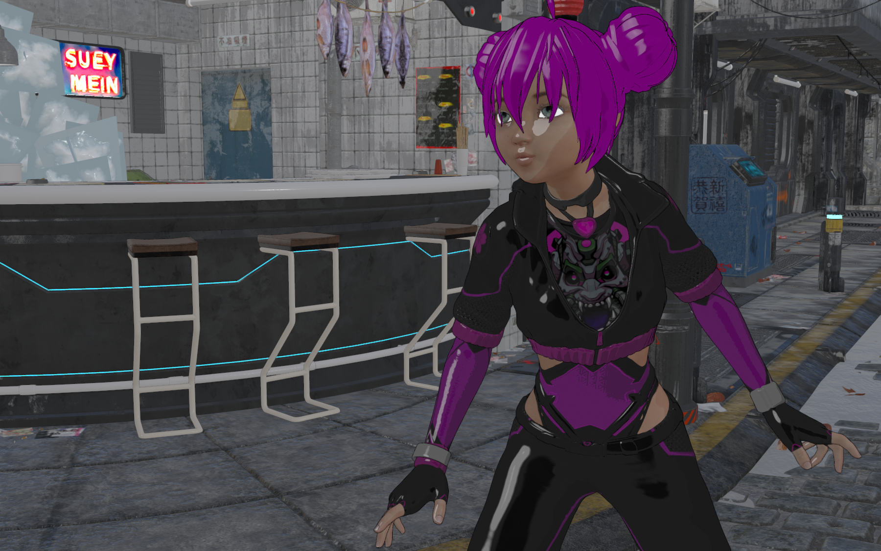

  • I've been messing around with G8 characters with FilaToon. The biggest issues I've seen are the eyes. One solution that works somewhat for me, is to add an emmision to the sclera and iris, and put the cutout opacity for the Eye Moisture and Cornea at 0.
    I'm working on trying to find a style that isn't anime, but still uses this shader. I'm using a program called Stable Projectorz to texture characters (some teeth are painted on her lips in the images below, which I need to fix). I want to play around with skin tones to find a compromise between the simple coloring of most of the renders I've seen with Filatoon, with a more semi-realistic style. The first image is with the Aces Legacy tone mapping mode, the second is with Reinhard. The third one, is Reinhard, but I hid the Outlines.
    1092 x 1536 - 814K
    1092 x 1536 - 824K
    1092 x 1536 - 795K

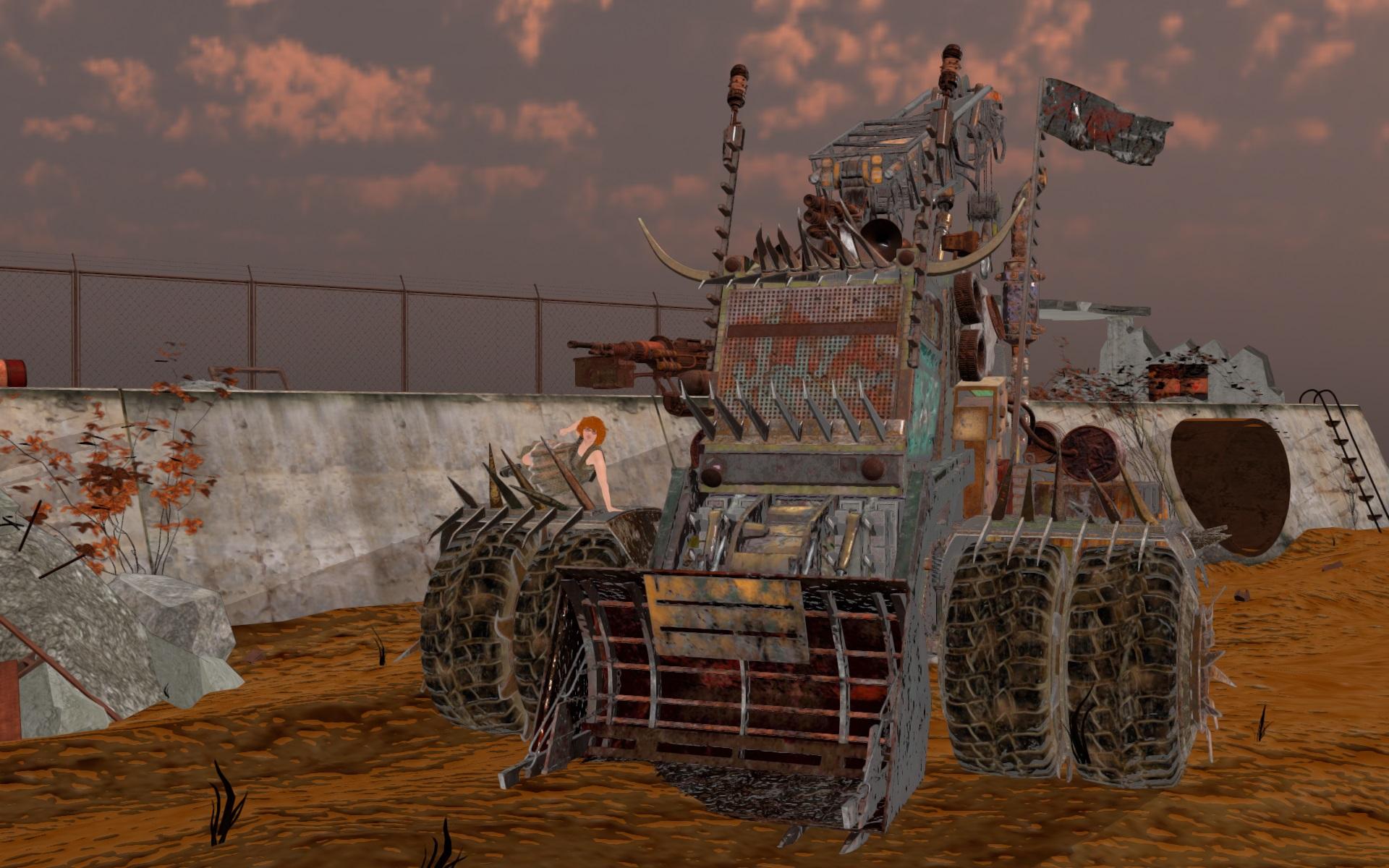

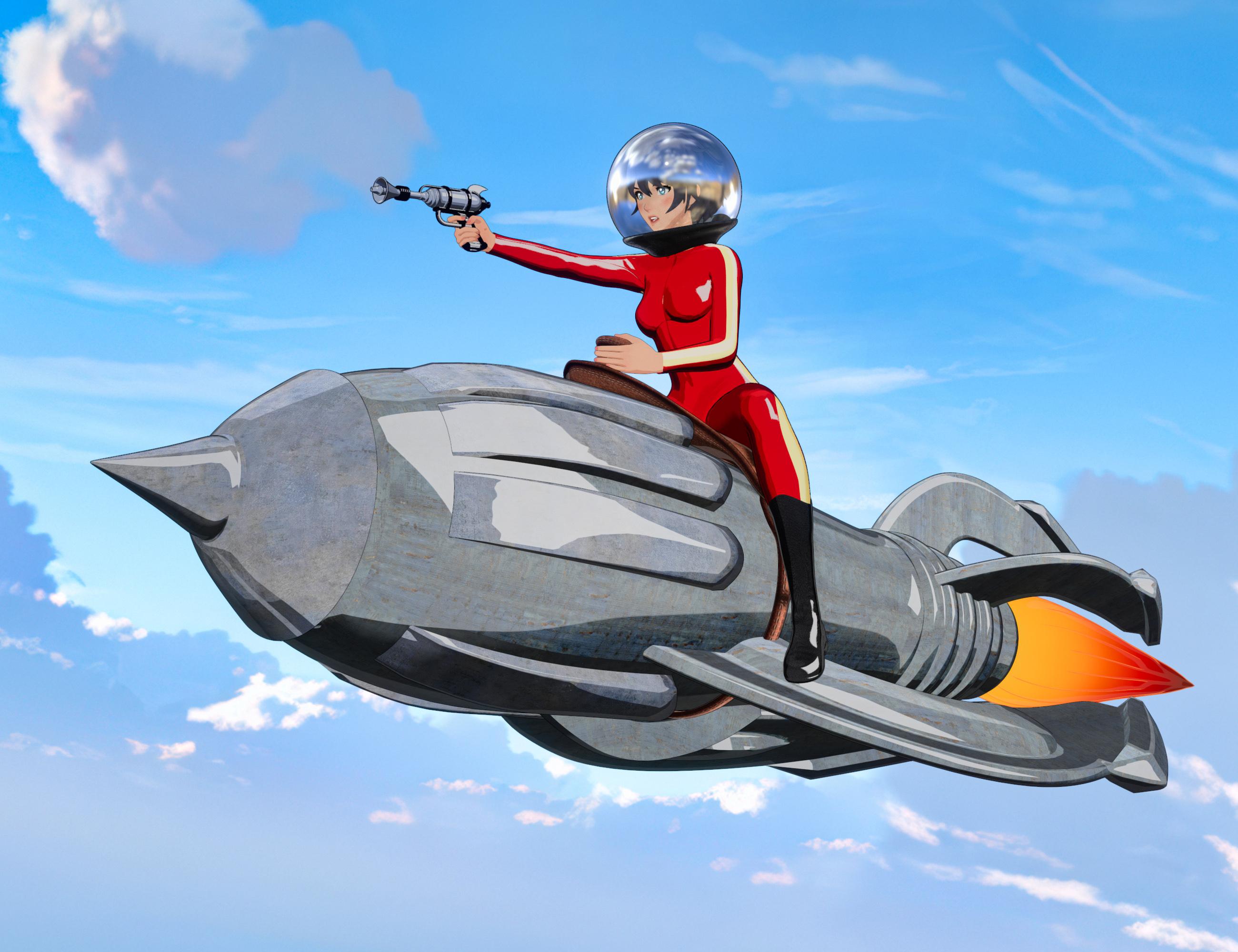

    I've submitted a FilaToon expansion to my robot servants. Here are some of the promos, using the techniques I mentioned:
    2600 x 2000 - 1M
    1500 x 2250 - 604K
