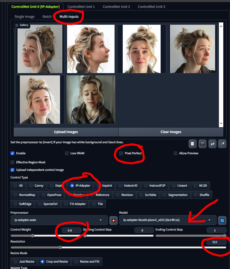

    This is exactly what I've been working on for over a year now. If you're planning to create consistent characters, it's important to set everything up in advance, which deserves its own detailed thread.
    Speaking of which, check out this thread: Iray Photorealism Discussion.
    To start, you'll want to create a character design profile package with a variety of images. For headshots, ensure you include at least a frontal view, a 30-degree side view, and a full side profile. I recommend even more angles for better accuracy. Do the same for mid-body and full-body shots, including the clothing sets you plan to use. You can create these images using tools like MJ, SD, Daz, or even real photos. The headshots are especially useful when combined with ControlNet's Ipadapter plus Face or Face Plus 2—though I personally prefer the original version. Set the face images to "multiple" in independent control, which will get you quite far.
    For even better results (except for profile shots), you can use ReActor. Here, you’re limited to one image (the multiple option doesn't work), but the side profile image often works best. Make sure to uncheck "Swap in generated image" and check "Swap in source image." This way, the face swap happens before Ipadapter and other processing, allowing for detailed refinement by the AI. ReActor aligns the facial shape more realistically than a stylized Daz character's usually is, and Ipadapter doesn't do a good job on actually refitting the face shape, just at adding textural details.
    However, there are still challenges with head scaling and angles, which can make it difficult to keep characters consistent. I’ve developed an extension for Automatic1111 that helps with this, and I’ll have a new update tomorrow—version 1.2.0. If you're interested, I'd recommend waiting until that release. You can check it out here: FacePop GitHub. Basically what it does is detects faces in the img2img, crops them out to a new image, scales them to a specific image size, and rotates the head orientation to be as perfectly upright as possible. It then does an AI process on that, before returning it back to the original image, and allowing the full image to finally be processed but with a mask over the face area we just already processed so it doesn't get double processed. This way faces are always processed at a specific scale and best orientation. It can handle faces on the side or even upside down.
    I also plan to begin testing and adapting it to work with ForgeUI this week. It may or may not make its way to ComfyUI, but much of the backend could potentially be handled with a node layout. Still, the aggressive face detection I've implemented using Mediapipe and template masking is a key feature.
    I definitely want to get this working on ForgeUI so I can test Flux integration. Everything I’ve seen so far suggests it’s a fantastic model.
    Once that's done—depending on compatibility, likely in about a week—I’ll start a new thread and blog about "AI Bumping," which dives deeper into using AI to create consistent Daz characters. This will provide more detail than what I've shared here.
    This is almost my entire life for the last year, working to perfect this process and make apps for others to use to do the same. AI Bumping is the future of Daz art..no doubt here about it.

    So ForgeUI seems to maintaine it's own Control Net as a built in, and the developer had Multiple-Inputs at one point, removed it, and now seems reluctant to add it back in.
    From this disucussion: https://github.com/lllyasviel/stable-diffusion-webui-forge/pull/264
    This workflow for the best consistancy requires at least 3 or more control images. I will see about a new extension for it for Control Net injeciton, I'll have to dump and analyze the parameters feed. I already have one yet unpublished such injector for AUTO1111, so hopefully it's pretty similar.

    I did finally get an extension to inject Multi-Input's for ForgeUI's built in ControlNet.
    Here: https://github.com/TheCodeSlinger/ForgeUI-IPAdapter-MultiInput
    However the way their CN handles the adapters is less than impressive and so until they update it my workflow only really is viable with A1111.
    FacePop will work with both but since you can't use MultiInputs on ForgeUI I don't see a reason to for my purposes.
    One thing I dislike about A1111's CN is that if you have to restart the console,  it will show your CN settings in the UI, but will ignore it. Also setting up CN's each time I load is cumbersome. Plus I have yet to see a SAVE system for A1111 that will also include your multi-images, they get dropped because they are stored not as a link to the file but as part of the "p" paramater as a numpy converted to a Base64 string, which gets reset if you restart the console. SO I made an extension that will retain these settings. This is also a great way to save time by save predesigned control nets.
    Here: https://github.com/TheCodeSlinger/A1111-Retain-ControlNet
    I also just released an Overlay PNG with transparency extension that works for both A1111 and ForgeUI, and also goes hand in hand with FacePop. The reason for this is if you have a character say wears glasses, well generative AI doesn't play well with that, making weird shapes of glasses and even ignoring them sometimes. In Daz you render the glasses on the character seperatly as a beauty canvas with alpha checked, and the glasses set to the only node. Here with this exention you get to process the face first without glasses, overlay the glasses and give it a final process nudge to blend together.
    Here: https://github.com/TheCodeSlinger/SD-WebUI-Overlay-PNG
    Post edited by charles on

    I agree with you on LivePortrait. And if you just want to do some random AIBumping then just about anything will do like Flux as the OP did.
    If you are looking for "consistant very GOOD looking REALISTIC characters" that's my workflow.
    If you are wanting my workflow you will need to use Automatic1111's Stable-Diffusion-WebUI. I had hopes for Flux and Forge, but no, they are not ready for this kind of thing yet.
    As far as ComfyUI goes, it has the potential but I find a bit more tedious and unstable for my workflow, and I haven't seen as good of an inpainting tool for it yet...but that was several months ago.
    I'll begin with you will need a VERY good GPU with 8+ VRAM, more like 24+, but I am going to bet being a long time Daz guy you do.
    Install Automatic1111
    https://www.youtube.com/watch?time_continue=5&v=3cvP7yJotUM&embeds_referring_euri=https://www.bing.com/&embeds_referring_origin=https://www.bing.com&source_ve_path=Mjg2NjY
    You will want to use this modified version of SD1.5 the model: https://civitai.com/models/132632/epicphotogasm, at the top you will see the different versions, I would recommend Z-Universal (not the inpainting version) download it and put it in "stable-diffusion-webui\models\Stable-diffusion"
    Install Control Net:
    https://github.com/Mikubill/sd-webui-controlnet?tab=readme-ov-file
    and download some controlnet modules like the IPAdapter SD1.5/SDXL ones and the IPAdapter FaceID [SD1.5/SDXL] for sure. But I would also get the ones for Canny, OpenPose and any others you might be interested in from here that work with sd1.5: https://huggingface.co/lllyasviel/ControlNet-v1-1/tree/main ; and from here for SDXL: https://huggingface.co/xinsir ; ... I know it's all a bit of a mess.
    I would recommend also getting Reactor here: https://github.com/Gourieff/sd-webui-reactor
    [Do IT!]
    Once you have all that setup test by running it from you're webui-user.bat, switch the checkpoint model (very top) to the Z-Universal model.
    Switch to Img2Img tab
    Put the Daz image you want to do in the image section.
    Sampling Method: I recommend "Restart"
    Scheule type should be "Automatic" if not an option use "Karras"
    Sampling Steps: 33-40
    In the Resize tab, be sure to click the yellow triangle, that will resize to your Daz image. If it's more than like 1440 width or height, switch to Resize by and scale it down to that or lower.
    CFG Scale, I recommend 6-8 (just leave it at default 7 for now)
    Denoising!!! This is where you will play with testing over and over again, start Denoising Strength at .4
    Seed -1 (which will grab a random one)
    Generate Button! See what you get. I'll follow up with another post on using the control nets and reactor next. But that's what you need minimum to get started.
