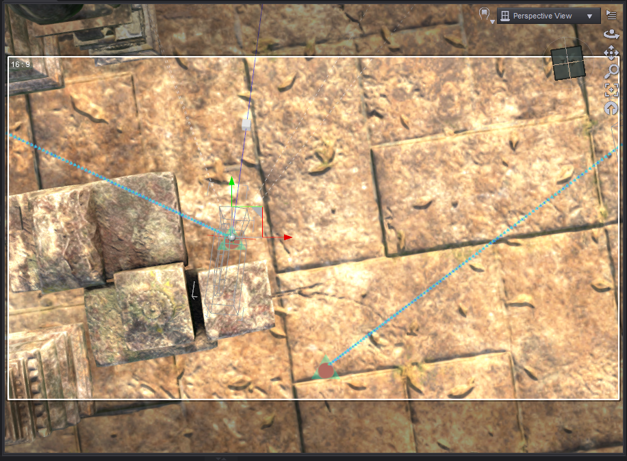

    It would be very helpful to be able to use automatic and continuous bezier.
    https://helpx.adobe.com/after-effects/using/keyframe-interpolation.html
    With Bezier alone, I have a hard time adjusting it to create a smooth trajectory.
    It's because it takes a lot of time and effort to create the curve I want while keeping the three “external point-internal point-external point” points in a straight line.
    Because it takes a lot of time and effort to align the three points, it is very difficult to adjust.
    Auto Bezier or continuous Bezier is always smooth because it is always in a straight line.
    Also, if I am creating a large scaled wide scene, it is difficult to select with a click because the control point is so small.
    I also find it difficult to move the camera when editing, so it would be useful to be able to select a control point and use the camera control.

     Thanks for the reply.
     I tried to repair the Windows C++ system, but there was no change.
     It may be due to the fact that the Mopat node is an object, not a system cursor as DazStudio is supposed to be.
     It may be that they look smaller when they are far away.
     Like in a scene 10 kilometers square, even if it is the size of a basketball, it will not be visible.
     When I create a scene with an airplane flying around a city, it may be easier to manipulate the control points if I work with a scene where the city is reduced to 10 meter squares.

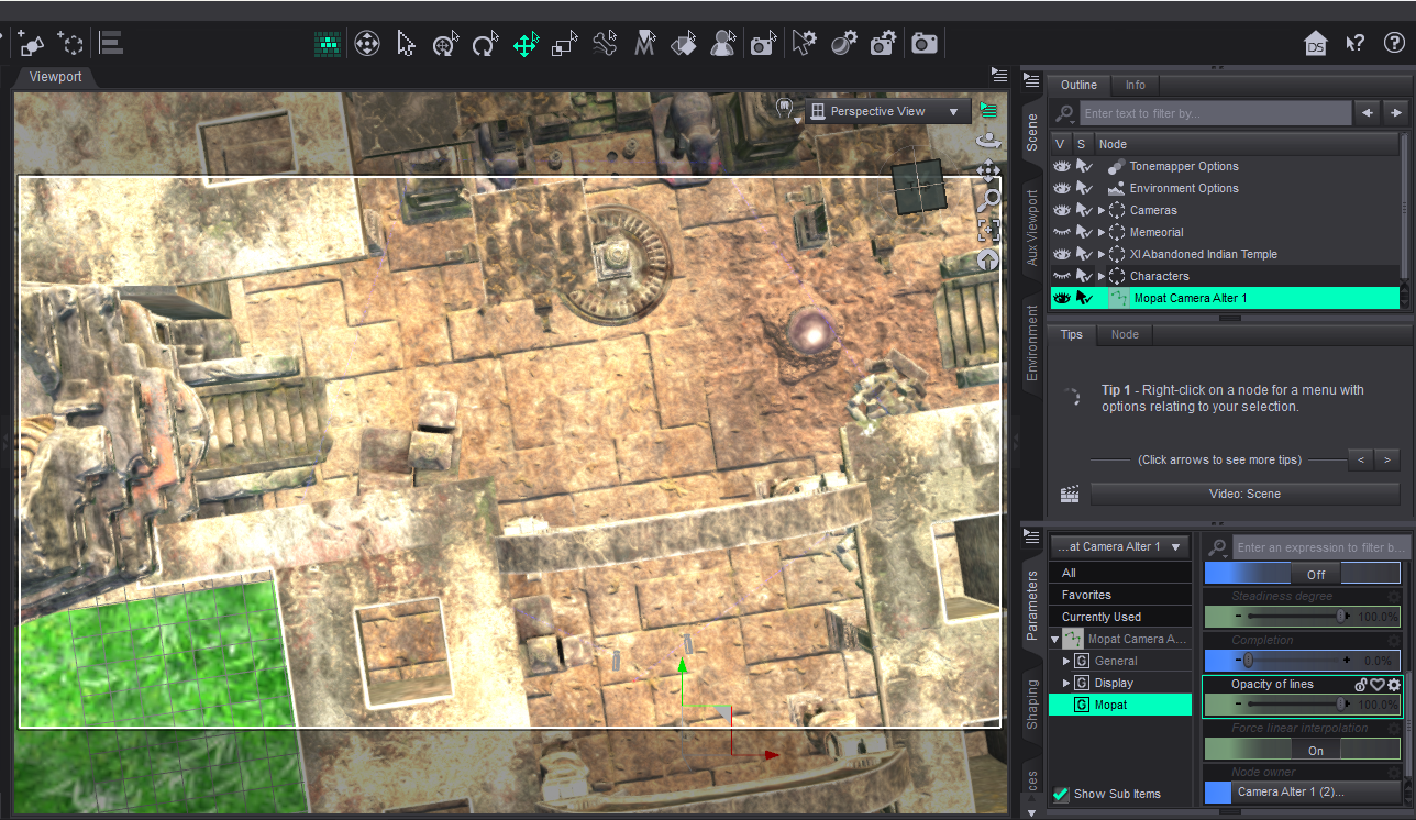

  • Hi! Thank you very much for this plugin, it's awesome! laugh However, is it possible to increase the width of the lines and the points, please? Because to mody a long path, it would be more convinient to have a far view, in order to see the entire path. But with a far view, I absolutely can't see the path:
    I need to zoom very close to the path in order to see it, but when I do that, I can only see a small part of the path, since it is long...
    So, it is difficult to give it the exact shape that I want without seeing it entirely...
    I already set the Opacity of lines to 100%, and I even tried to set it to 1 000%, but I still can't see the path when I use a far view...
    Thank you in advance!
  • AlbertoAlberto Posts: 1,472
    Oh! Let me see what I can do.
