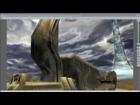

  • Sounds like the kind of problem being talked about in video.    Sorry that I can't offer any advice, animation is not something I know much about.  But maybe there will be some useful clues in the video.  Oro is the Bryce animation master.

    There are things you can do to reduce it, but sadly, unless you use Oro's approach and start masking and compositing in your video editor, it will be difficult to get rid of entirely.
