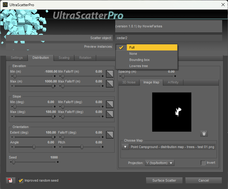

  • I have created a sample distribution map in Photoshop just now, and when I uploaded it to UltraScatterPro and tried to scatter a tree (which is an OBJ file) onto a very large terrain (which is originally an OBJ file), I get no results.  Either I need to read the manual again, or something's not right.  I did set the measuring units to yards due to the size of the scene.
  • barbultbarbult Posts: 27,499
    Show some screenshots of your map and UltraScatterPro setting tabs. I'm sure we can resolve the problem.

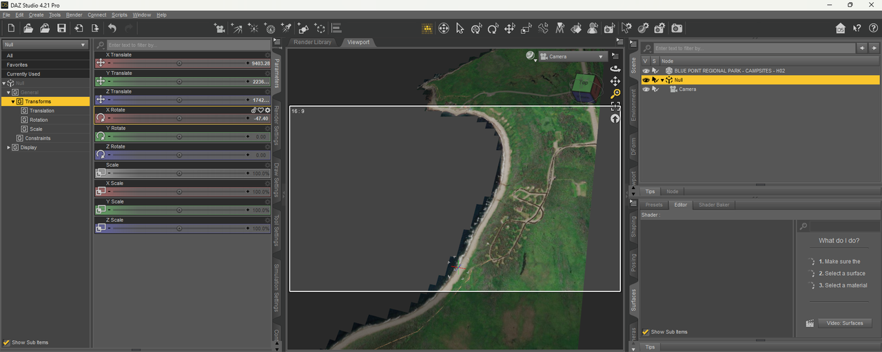

    As you requested, here are some screenshots of the work I am trying to do.
    First, here is the scene, illustrating its massive size.

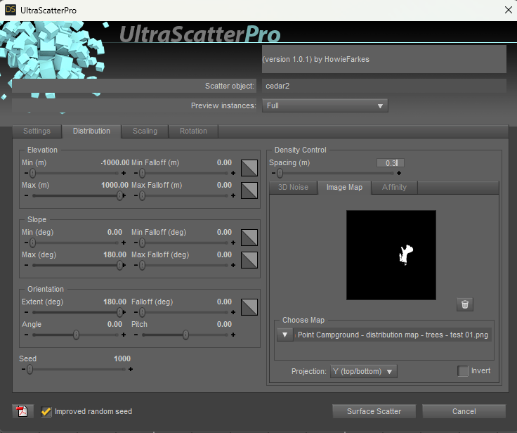

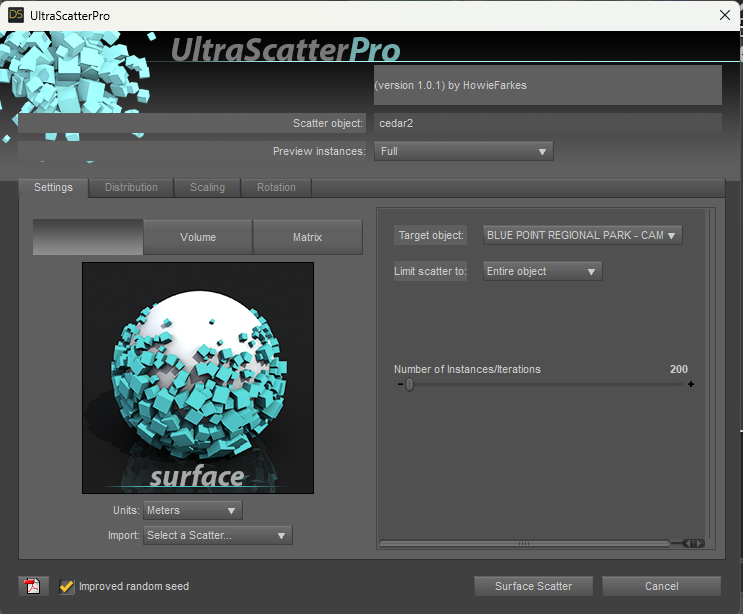

    Now, some illustrations of what I have set in UltraScatterPro:

    I see a couple issues. Most of your distribution map is black, which is not a problem in of itself, but with only 200 instances to generate, you may get none that happen to fall in the white area. The way it works is that it randomly picks a point in the target area and then checks other criteria, like spacing and distribution map to see whether it is allowed to put an instance there. If all 200 randomly selected points fall in the large black area, you won't get any instances. You can increase the number of instances to maybe 2000 and see how many you get. If these are large trees, you should set a spacing larger than 0, something the width of the tree or greater. Another thing you can do is restrict the target area to less than the entire object. I do that by creating a selection set in the geometry editor and then choosingthat in UltraScatterPro. The second issue I see is that you have selected Full for your instance preview. This could overwhelm your computer once you get a lot of instances of complex trees! Bounding box or low res tree is a better choice.
