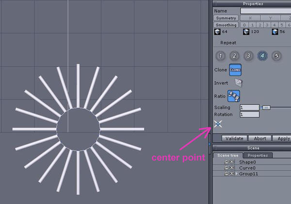

I'm learning Hex so maybe this is an easy question. I wanted to create an array of tubes in a symmetrical pattern, like the fanning fringe, for instance, on the top edge of a mask. So I made the tube shape I wanted, made a circle, then tried the "Copy on a Support" Utility to put the tube on the facets of the circle. Problem is it grabs the center of the tube - I want the END of the tube to be the attach point. So how do I move the center of the tube object to it's end? Or is there an easier way to accomplish this (I'm betting the answer is yes)?
Much thanks for any help.
  • edited December 1969
    The good news is that you can change the center point using the icon as shown below.
    The bad news is that I just found out I can't make the clone function work for love or money...
    747 x 526 - 124K
  • RoygeeRoygee Posts: 2,247
    Strange - clone works for me - i see you have it selected OK. Are you using the original image to clone, not one of the copies?
    Just for freedo99's info - you change the pivot point by hitting r-mouse in an empty part of the workspace, selecting "Set pivot point" and selecting a vertex. This won't work for the use you are thinking of - afreaginname's suggestion is the correct method. From there you can move the array outward or inward by dragging on the centre yellow box of the universal manipulator.
