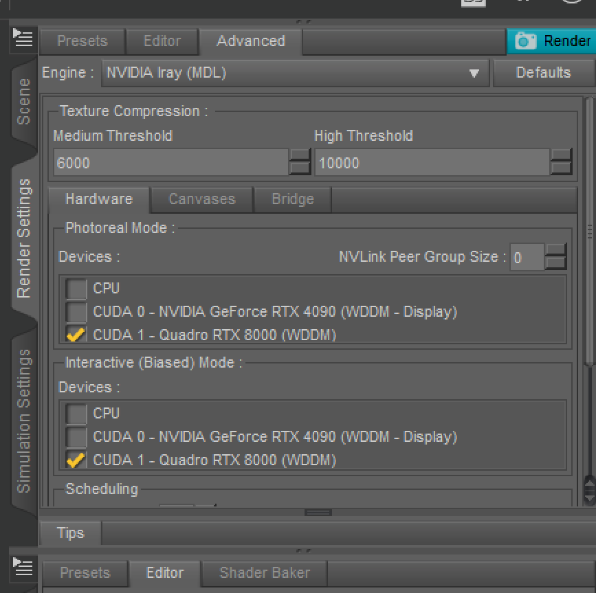

    Off! sweet, because here was mine..yeah like I really need to compress with a q8k
    but it's always good to have options and know what they are.
    yeah I push it too to make some crazy detailed stuff.

  • crosswindcrosswind Posts: 10,316
    It's my "routine settings"... if there's no potential fallback.  Without any compression, rendering gets faster from very beginning.
