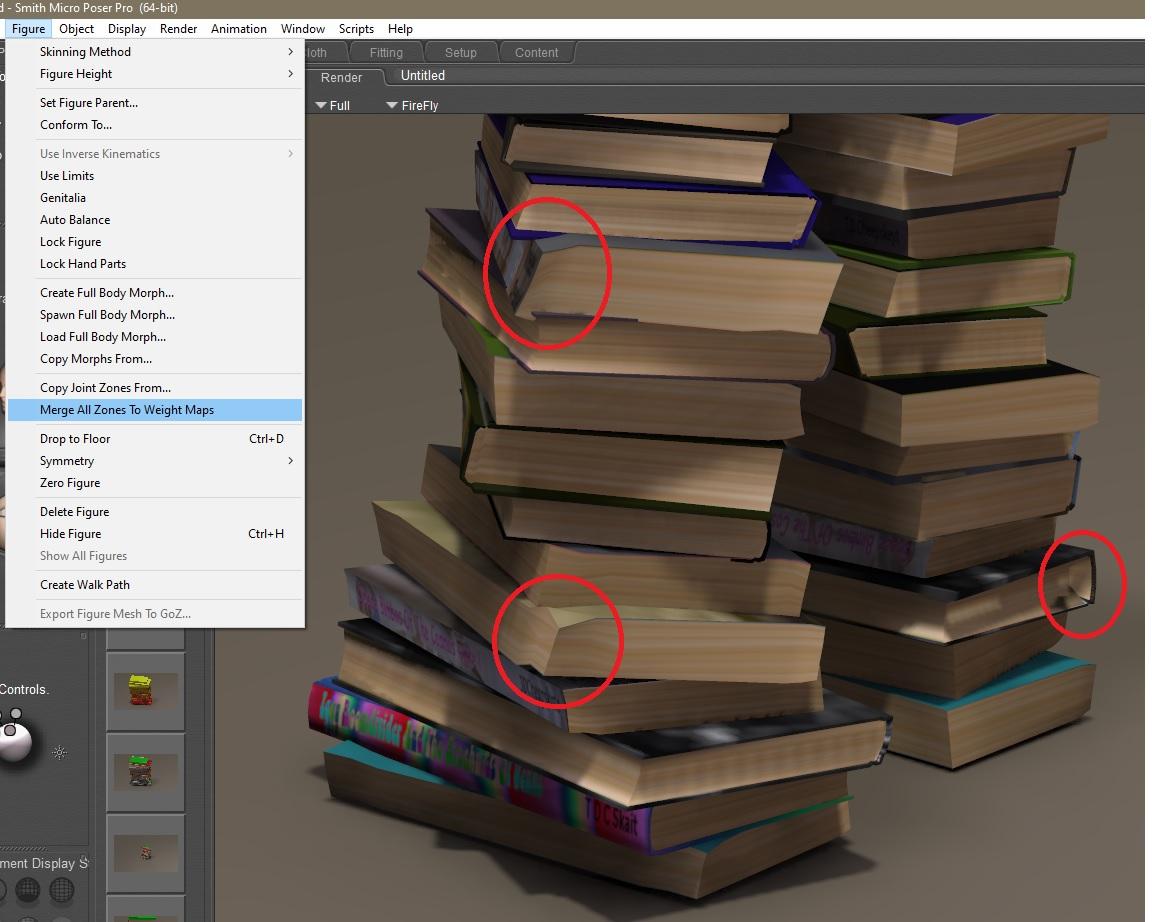

    edited September 2024
    crosswind said:
    Without checking these props, it's hard to tell...but I used to manipulate some cr2 format figures / props long time ago. Before saving them to any DS format, I always converted them to General Weight mapping... Maybe you can give it a try.
    I just tried the 'Merge all zones to weight maps' option in PP2014 on each of the four figures in each of the two stacks that are in the zip. Nothing appeared to change, which I think is a good sign. But when I randomized both stacks in PP2014 I spotted some deformations that I've never seen before, circled on the screenshot below, which I assume are due to the change. I'll try re-saving these weight-mapped figures and importing them into Studio next.
    1152 x 922 - 211K
    Post edited by 3dcheapskate on
