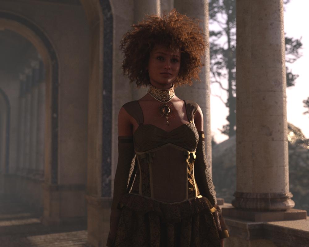

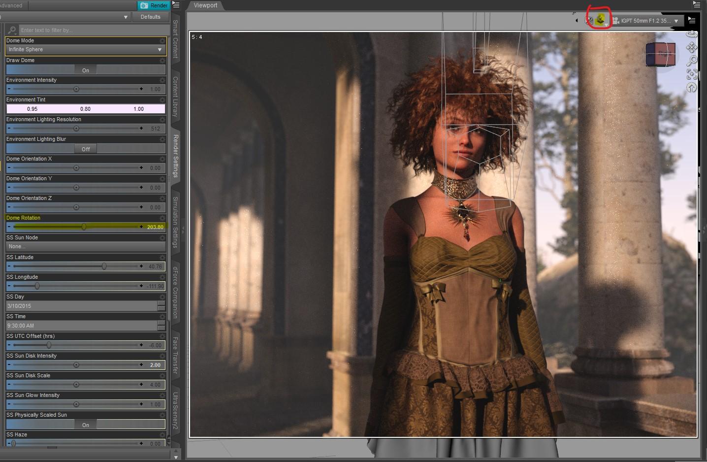

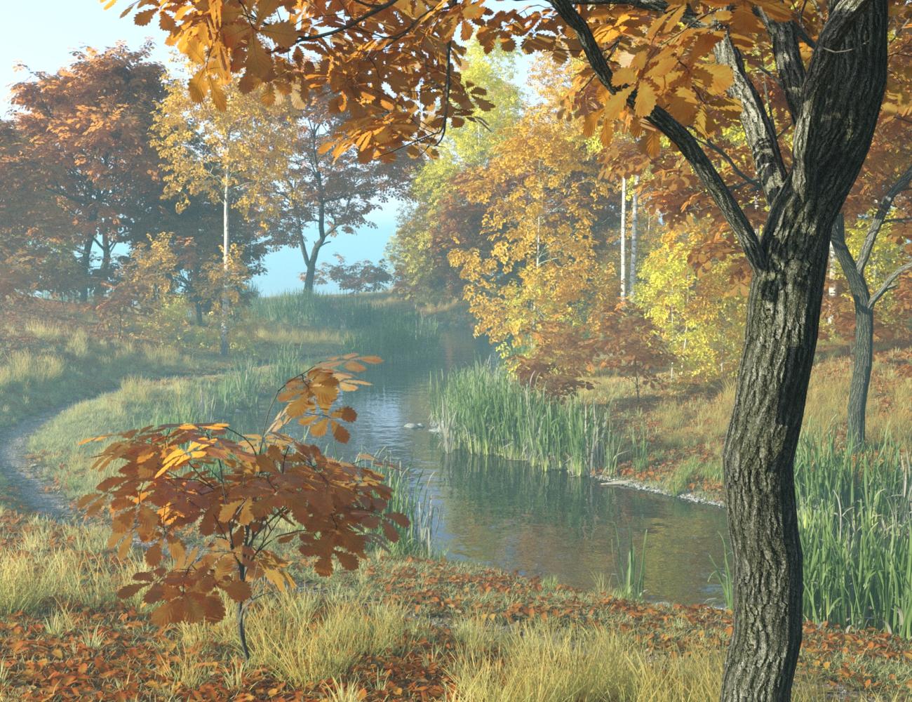

    Here's the Environment settings for my first example, the girl at the bridge.

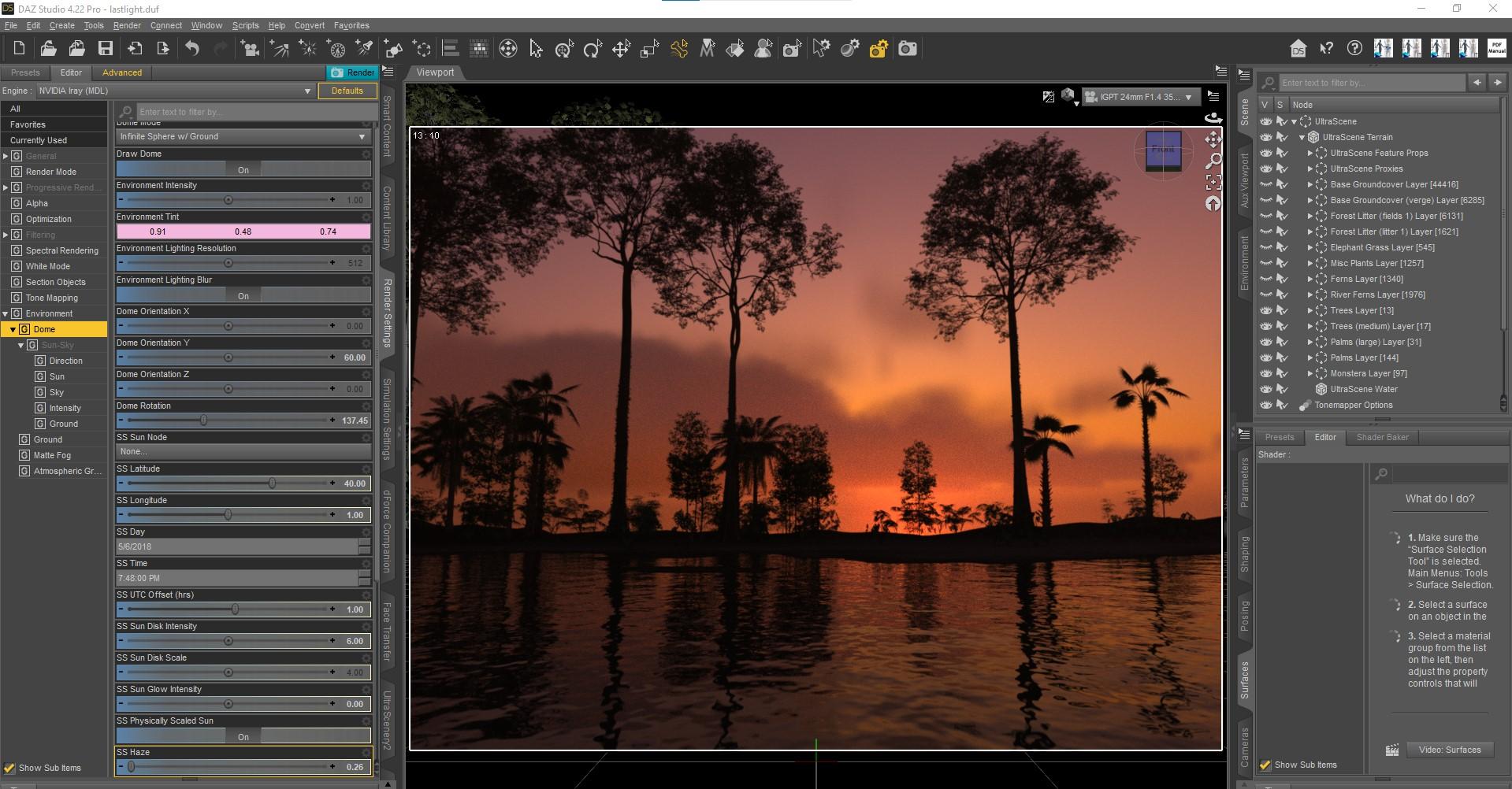

    As discussed in the video, you need to set the viewport view to NVIDIA Iray to see the sun and sky. Then to position the sun, use Dome Rotation in conjunction with other settings as appropriate: particularly SS Day and SS Time, but also consider SS Latitude and SS Longitude.
    Just as a for-instance, this is a new render with everything else the same, except I moved the rotation to 48.19. It gives an entirely different look to this bridge - a fun alternative if letting the direct light fall on the girl's face wasn't what I had envisioned.

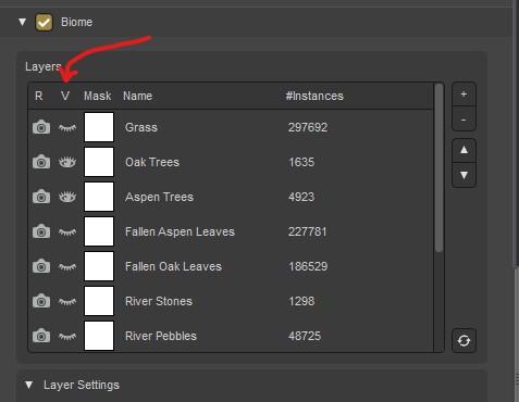

    Here's something that's important to mention. If you're using the original Ultrascenery - as is the case with the sunset image, which I created a couple of years ago - do not just switch to NVIDIA Iray view without preparing the scene items. I'm running a decent system - an RTX 3090 - and it will stagger to a standstill if I do that.
    What you do is expand the Ultrascene -> UltraScene Terrain and then make invisible all but the relevant USC objects - the Proxies and usually trees, if you're looking for sun and shadow placement. Look to the panel at right, where I've made various ground layers invisible, leaving the trees visible. (There are actually a bunch more ground layers in this particular ecology, but I deleted them to get this screen shot.)

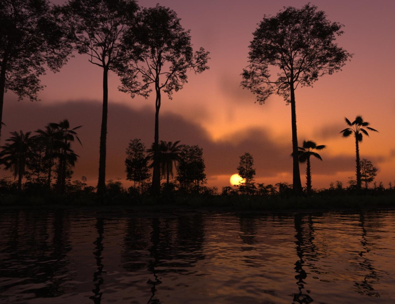

    Notice the SS Time: 7:48pm. The actual sun disk is just below the horizon at the center of the screen; if I back off, minute by minute, the entire lighting changes with every minute. The sun disk becomes clearly visible by about 7:45 pm.
    Here's the actual sun in view, at 7:40pm.
    The cloud off in the distance in this image is one of the Stonemason VDB clouds:
    https://www.daz3d.com/volumetric-clouds-for-iray
    There are other vdb clouds that are perfectly nice, but that's what this one happens to be from. I've used this set often and I like them, but be alert that adding them will reset some of the environment settings. If you use this cloud set, use them before you fine-tune the environment.
    The clouds also start off in a spot that is likely way out of camera view. The cloud here has x/y/z settings of -15000/-101000/-50000. Don't be surprised if you have to move vdb clouds way, way, way away from the foreground, depending on the effect you're looking for.

    For classic USC, just make most of the items not visible when using Iray preview, as in the screen shot I left.

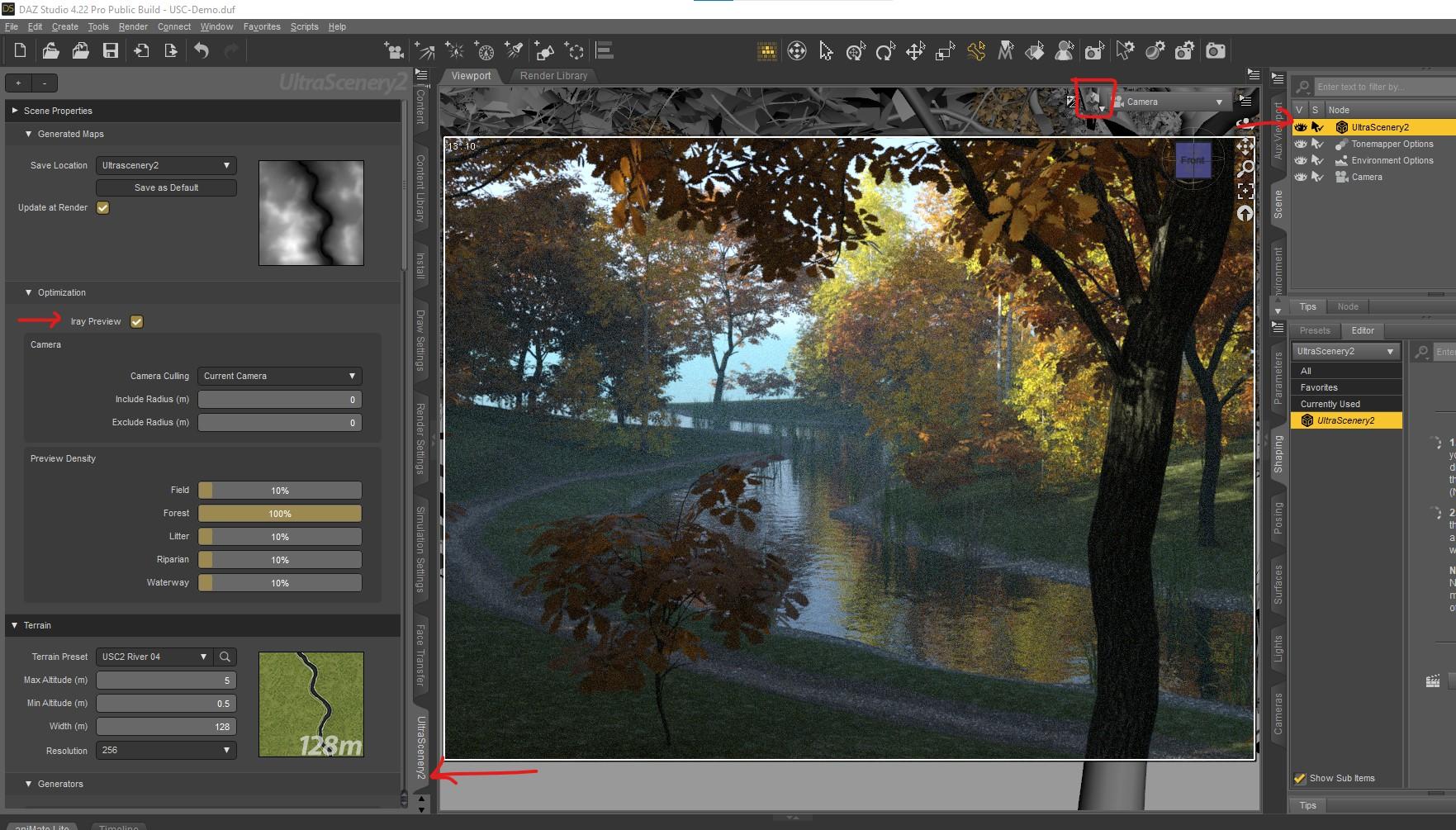

    When it comes to viewing Sun-Sky settings with NVIDIA Iray, Ultrascenery 2 does it differently than classic Ultrascenery and appears to have a troublesome quirk in this regard. For assorted reasons, I hadn't done enough with USC2 yet to have really paid attention to this before.
    In addition to setting the viewport view, you'll need to select your Ultrascenery2 object and then the Ultrascenery2 tab (mine just happens to be here - YMMV). Once on the UltraScenery2 pane, look for the Iray Preview checkbox. If checked, and NVIDIA Iray viewport is set, it should show the current lighting as seen here. Now you can rotate the dome and set the time and place to get your sun right where you want it.
    There is a second place to consider looking. You don't have to make a bunch of layers invisible first, like you do in the original Ultrascenery, because that's already done for you. To change what is seen in preview, you can proceed to here (for the new USC2 biomes; legacy items are shown elsewhere, if you're using a legacy ecology).

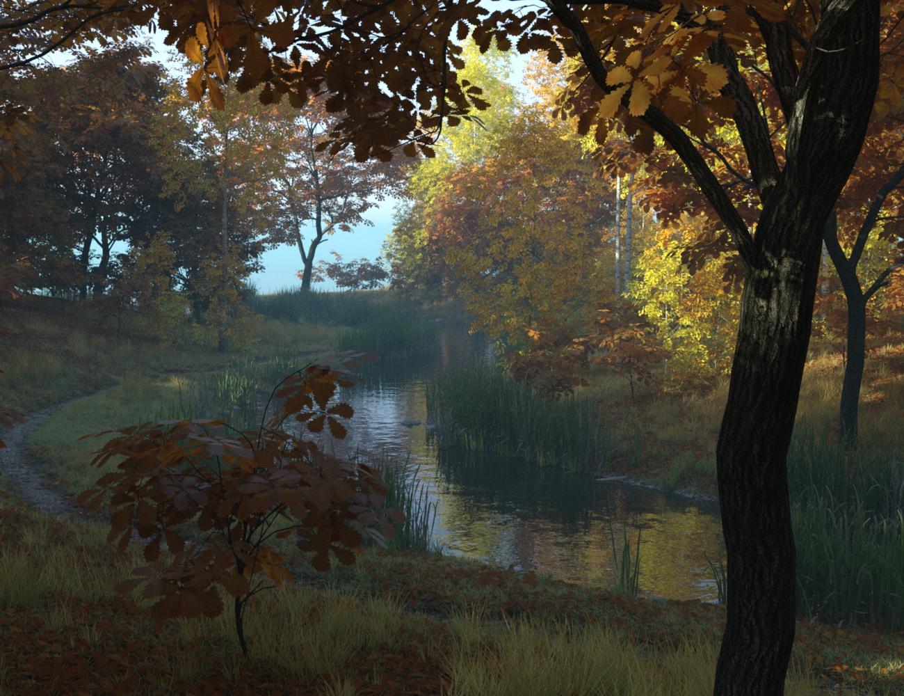

    I then went to render this simple test scene and got something completely unlike what I just scoped out in Iray preview:
    It would seem that's because of Camera Culling. If you have Camera Culling set for a camera, the rendered image will be a lot brighter. If you set Camera Culling to None, you'll get an image that you'd expect from the preview:
    TBH, I haven't worked out yet how to get Iray Preview to reflect Camera Culling.
