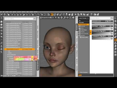

    Find the offending morph in Parameters tab. Right mouse Button (RMB) > Edit mode. RMB > Show in Property Hierarchy (get this very important tab from Window > Panes).
    Theres Sub-components : other morphs being controlled by the morph. And there's Controllers: other morphs controlling the morph.
    If you look at a JCM. You should find in the Controllers, the morphs that activate the JCM.
    Looking at Controllers, there is 1st stage and 2nd stage. 1st stage is additive, standard control. You should find the arm bend morphs and such.
    What you need is something in the 2nd stage - the multiply stage. There you should have the character figure morph of which the JCM is supposed to act on. If not there, add in by drag n droping the body morph FBM and/or head morph FHM of the figure its suposed to be linked with. Once added, open the morph > Attribute and make sure the new link is saved with the offending JCM and not the FBM/FHM.
    FInally, you can save your morph with save as > morph asset ...
    VIdeo by Josh
