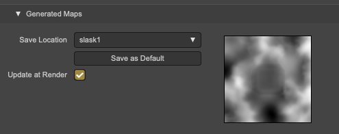

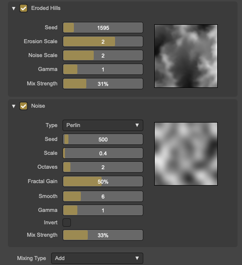

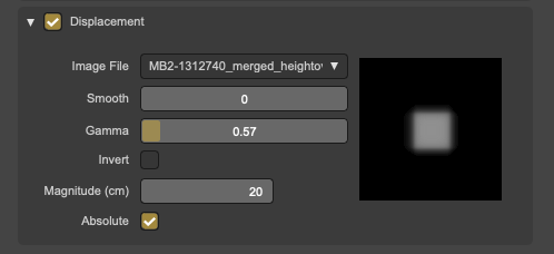

    Here is an example how you can use the displacement setting to get the desired effect.
    (Forum is being a twat when I try to add images into post)
    Setup simple:
    The displacements edited:
    The Noise and Erosion edited:
    The actual resulting map:
    Hope this helps!
