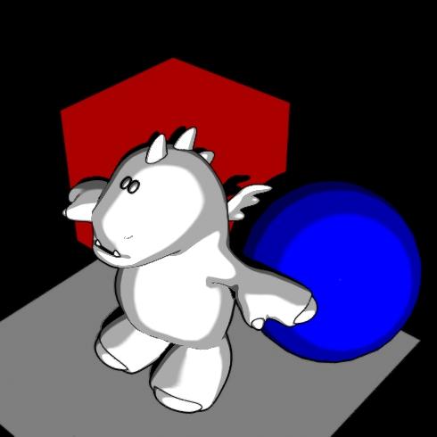

  • zigraphixzigraphix Posts: 2,787
    edited September 2012

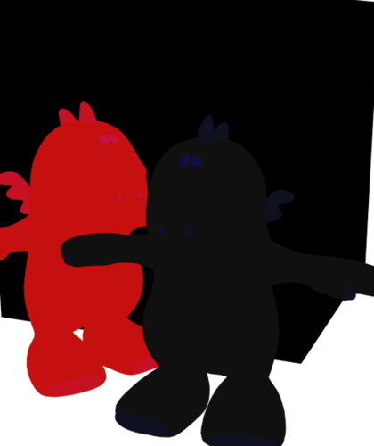

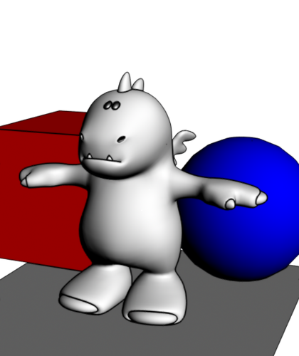

    Ok, I've pretty much got the unique ColorID part working. The modification to the function addOutLineIDsToMaterialsProperties looks like this:
           oColorIDProp.setPath( "Outline" );
           var iColor = i*19+16;
           var jColor = j*19+16;
           var kColor = k*19+16;
           if (iColor > 255) {iColor -= 255;}
           if (jColor > 255) {jColor -= 255;}
           if (kColor > 255) {kColor -= 255;}
           var TheColor = Color(iColor, jColor, kColor); // where r, g, and b are defined integers 0-255
           oColorIDProp.setColorValue(TheColor);

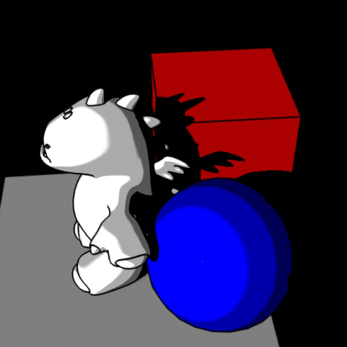

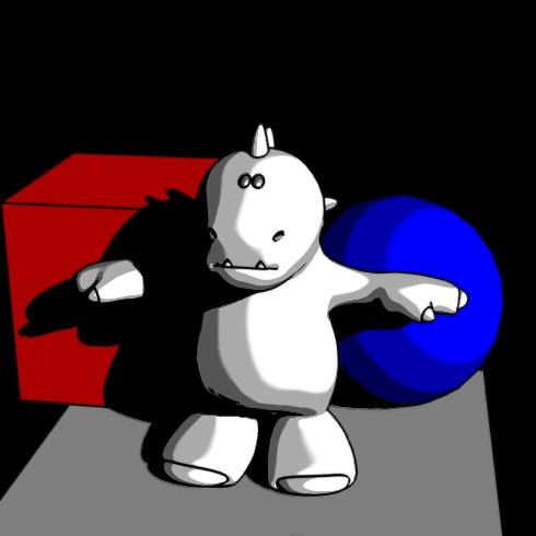

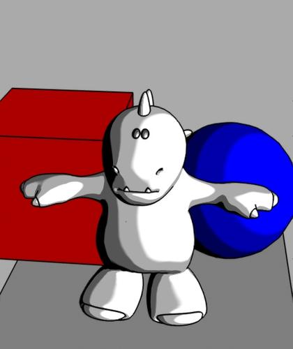

    I've attached sample images of the default 3Delight render, the render produced by the Scripted Renderer, which creates an image of flat colors using the ColorIDs, the outline file using ColorIDs, and the outline file using Normals. I still don't know if using the ColorIDs would be all that helpful, but it might add some enhancement over just Normals. Anyway, I'm happy to have figured out how to get this working, whether or not I end up using it.
    One thing that still confuses me is that the cube, a DS primitive, doesn't seem to get a ColorID other than (0,0,0), even though I've deliberately set the starting point of all ColorID components above 0. Is a DS primitive not a regular node/shape in the scene tree?
    490 x 584 - 63K
    490 x 584 - 48K
    490 x 584 - 44K
    490 x 584 - 286K
    Post edited by zigraphix on

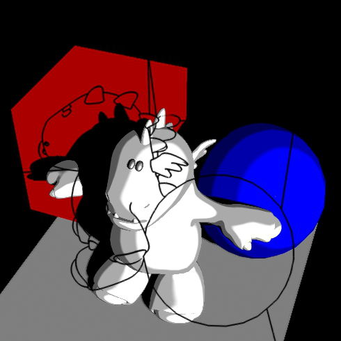

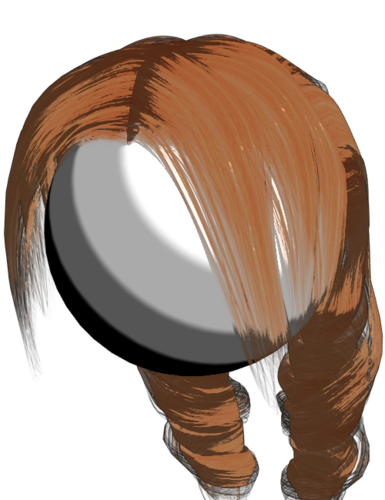

    Progress. I had to switch out the display setup to render the outline images as jpg rather than tif in OutlineRenderScript.dsa, because I couldn't figure out how to multiply tif images with the regular render to get the outlines, but this is what I have now... first I have to switch to scripted 3Delight and pick the outline script I want to use, render, then switch back to regular 3Delight and render again with my custom camera to pick up the pre-named image and combine it with the regular render.
    So next up, I need to figure out how to get a normal render, rather than the color ID render, in the OutlineRenderScript.dsa script. And then I need a script that pulls in the custom camera and alters the Render Engine to Scripted 3Delight and selects my script. Getting closer! Thanks to everyone who has helped. :)
    490 x 584 - 202K

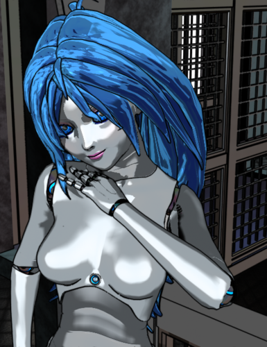

  • TugpsxTugpsx Posts: 921

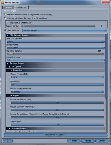

    I use a loader script to swap out the 3Delight for my own. This opens the door for tons more addons and render engines.
    651 x 849 - 157K
    Works great for DS4.5 too
    473 x 627 - 82K

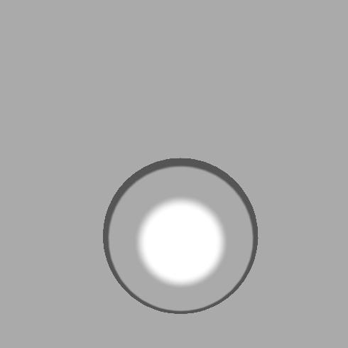

    Ok, I think this is where I'm stuck now. My script generates outlines, I save them to a known location, my camera can take in the outline file and composite it over the render... but when I'm using the Scripted Render, it doesn't seem to use the active camera, so the composition doesn't occur (and neither do any of the other camera effects).
    If I can get this to work, we can have cameras that do this without modifying the materials of any object in the scene:
    490 x 584 - 75K

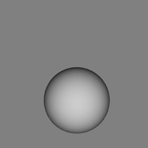

    Steps to reproduce:
    Start DS4.5
    add some content to the scene, e.g. a sphere
    open Shader mixer tab
    File->New Shader, select Camera
    Add Imager root, Toon brick, Backdrop brick (see attached screenshot)
    Create camera
    Select camera
    Render - note toon shading (see tooncamtest1)
    Open Render Settings tab
    Select Render Engine: Scripted 3Delight
    Select Render Script: Standard Example
    Render - note that there is no toon shading (see tooncamtest2)
    If you switch back to the non-scripted 3Delight renderer, the toon functionality of the Shader Mixer camera returns.
    So, is this a bug in the scripted renderer function, or does the script need to explicitly support a Shader Mixer camera?
    490 x 490 - 18K
    490 x 490 - 15K
    674 x 262 - 21K
