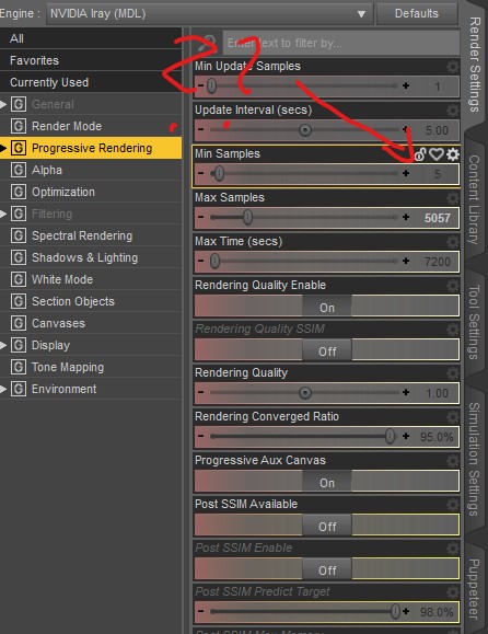

Hello!
I have an issue with Daz 4.22 Beta, I can't unlock the "Min Samples" slider. It maxes out at 100, but in DAZ 4.21 you could unlock it to force the renderer to make for example 5000 iterations regardless of the convergence (don't ask why - I just need it :)).
Any way to manipulate this? Some .ini file I need to edit or something? Again, clicking the gearbox icon doesn't give me the option to unlock the limits like in DAZ 4.21. Thanks for help :)

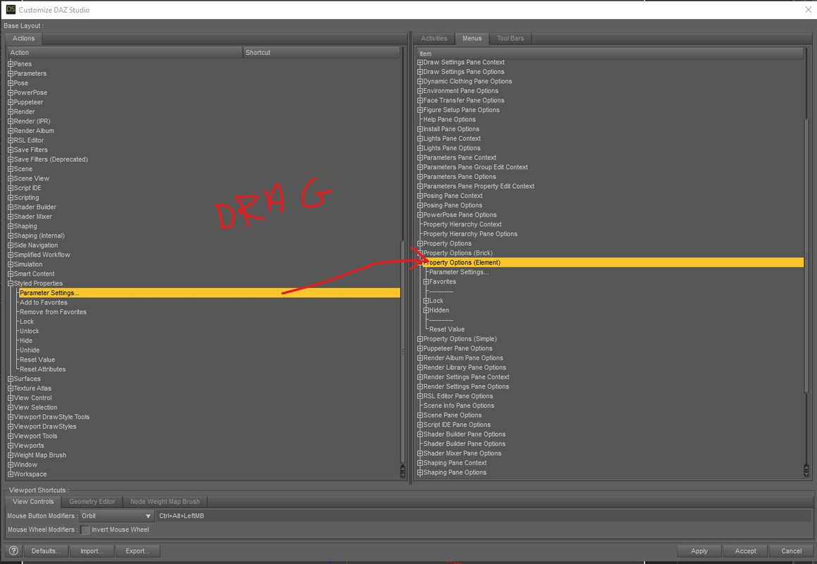

  • crosswind said:
    That is a feature by design rather than a bug. Pls check this thread to bring it back..guys. https://www.daz3d.com/forums/discussion/658641/dforce-4-22-gravity-parameter-settings-missing-solved
    Oh my, THANK YOU for this link. Solved, thread can be closed.
    Just for reference/documentation:
    If "Parameter settings" are missing when you click on the cog wheel of a property, go to:
    Windows -> Workspace -> Customize
    Look for "Styled properties" group on the LEFT,
    and on the RIGHT, click the "MENUS" tab, and look for "Property Optiopns (ELEMENT)", and DRAG the "Parameter Settings" with your mouse to "Property Optiopns (ELEMENT)".
    Apply, Accept and DONE!
