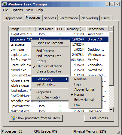

    Setting High Priority in the task manager was one of the first actions I tried but that didn´t have any major effect at all! Think it only gives Bryce first call on CPU resources when you have other apps open at the same time!?
