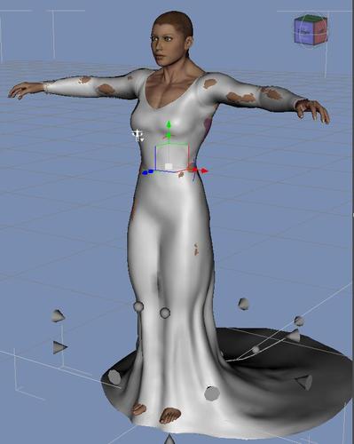

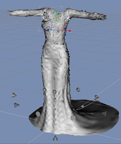

    Here's a screen cap of the lumps. I set the dial from the chest to about 140%.
    614 x 733 - 39K

  • BejaymacBejaymac Posts: 1,996
    OUCH, no those aren't what I thought you meant, is your mesh welded as 4.0 does that to morphs made on an unwelded mesh (it's "fixed" in 4.5).
    Hello Bejaymac!
    I'm pretty sure it's welded. It was all one OBJ when I made it in Hexagon, but otherwise I wouldn't know how to tell.
