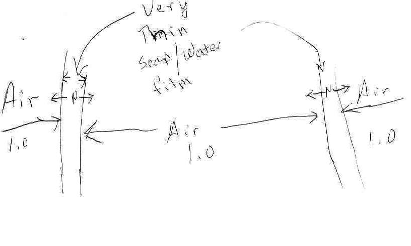

This is a drawing of what you are looking for in a model of a soap bubble.
In reality you are dealing with 2 volumes. The first is a thin film of soap/water. This thickness is not neglegible, even though it is very thin. The second is a contained volume of air. The differences between the air and the film IOR values are what cause the dichromism and other effects.
The thickness of that film IS fairly uniform...surface tension is going to assure that. Also, it's thin enough that absorption is not much of a factor.
One of the problems with the Iray shaders is that thin film/wall doesn't account for that interior volume of air (it's supposed to simulate a surface film on SOMETHING...like oil on skin/water/etc or a very thin, nearly no volume surface) and with it off, you start getting absorption playing with things...as if the whole volume is water/soap mixture...like a drop.
In any shader, that interior volume of the bubble needs to be defined as being AIR.
