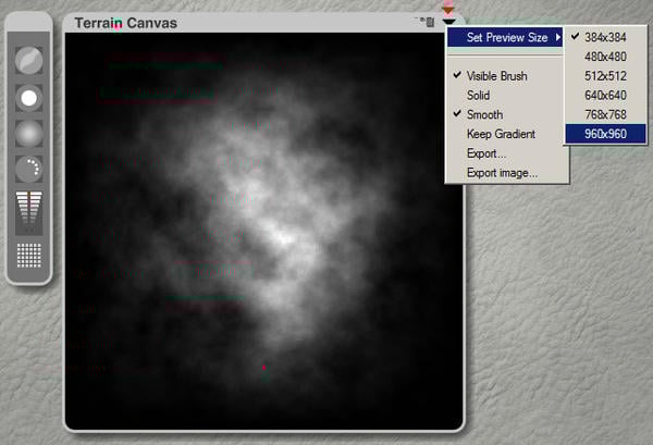

    A plane is a 2D face. You need a terrain. You can make one with gigantic resolution 4096 which has ample detail to make really huge in the scene. You can make the preview in the TE larger so you can better place the craters.

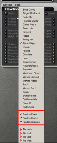

    Go back to the terrain editor (TE) and switch off Random Extent, Random Position and Random Character. If you hold down the Shift key while clicking on any one, all 3 get deselected. Now enable Tile North and click on Fractal. This creates a new terrain from the same random seed that tiles neatly north of the previous one. Exit the TE.

    To make sure, I included a picture how to resize the Terrain canvas. Yes, it always shows one terrain in full. It doesn't work for grouped terrains. Not the whole group is shown. You have to select one terrain.

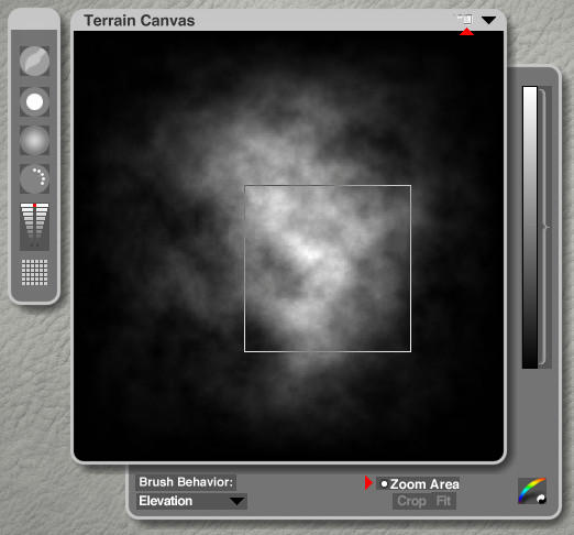

    You can also zoom in a part of the terrain (see second picture) and use the zoomed-in part only. Enable Zoom Area. A small rectangle appears. Mover the mouse to a corner and when a small cursor with 4 arrows appears, hold down left mouse button an pull. This will enlarge the selection. Move mouse to an edge and when the icon of a hand appears, you can drag the rectangle to the desired place. When clicking on Crop Fit, the terrain will change and only contain what is in the rectangle.
    Thanks Horo again for the help, There is such a lot to learn and remember just navigating let alone producing anything. But these tips are very helpful, I want to be able to put random craters on the terrain of different size, heights and positions, and this ability to zoom in will be very handy.
